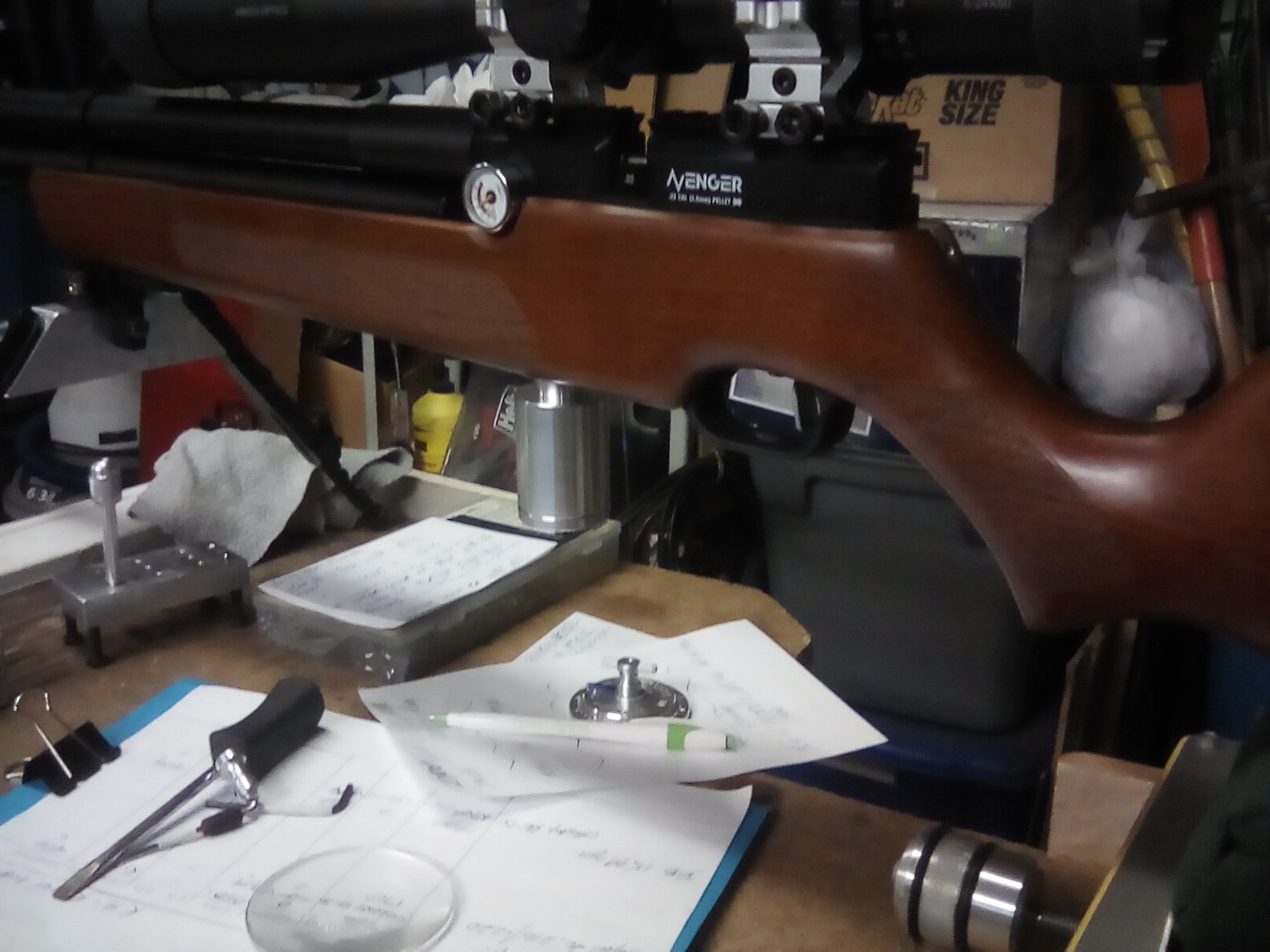

Thanks for the ideas Tim! over the weekend I was curious about the reg. Having slow recovery after a shot, so I went into the shop and turned a Plenum. It ended up being 17.5cc and seems to be helping the shot cycle recovery. I didn't take the hammer, or spring apart because the gun does take adjustment fine, and has 5.5 turns in/out. I am thinking my Chronograph is wonky. I did take the Chrony apart (it's an inexpensive one from eBay) and move the sensor lights further apart thinking it would see that as the pellet going slower? Seems to have taken @25fps off, but I am making so many changes....I need to start from a new baseline in the morning, and go from there. Through all this, the gun is shooting great groups, so it's all working so far.
Thanks again Tim! Here's a pic of the Plenum. I need to clean my shoting bench!
Gerry
Thanks again Tim! Here's a pic of the Plenum. I need to clean my shoting bench!View attachment 502412
Gerry
Wow that's great work! Wish I had a shop could make a plenum! I bought mine.

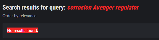

I was thinking maybe the Avenger has some set of factors that makes it particularly susceptible to corroding, but searching for “Avenger regulator corrosion” returned no hits so that made me wonder if the decision to change to SS is related to something else.
