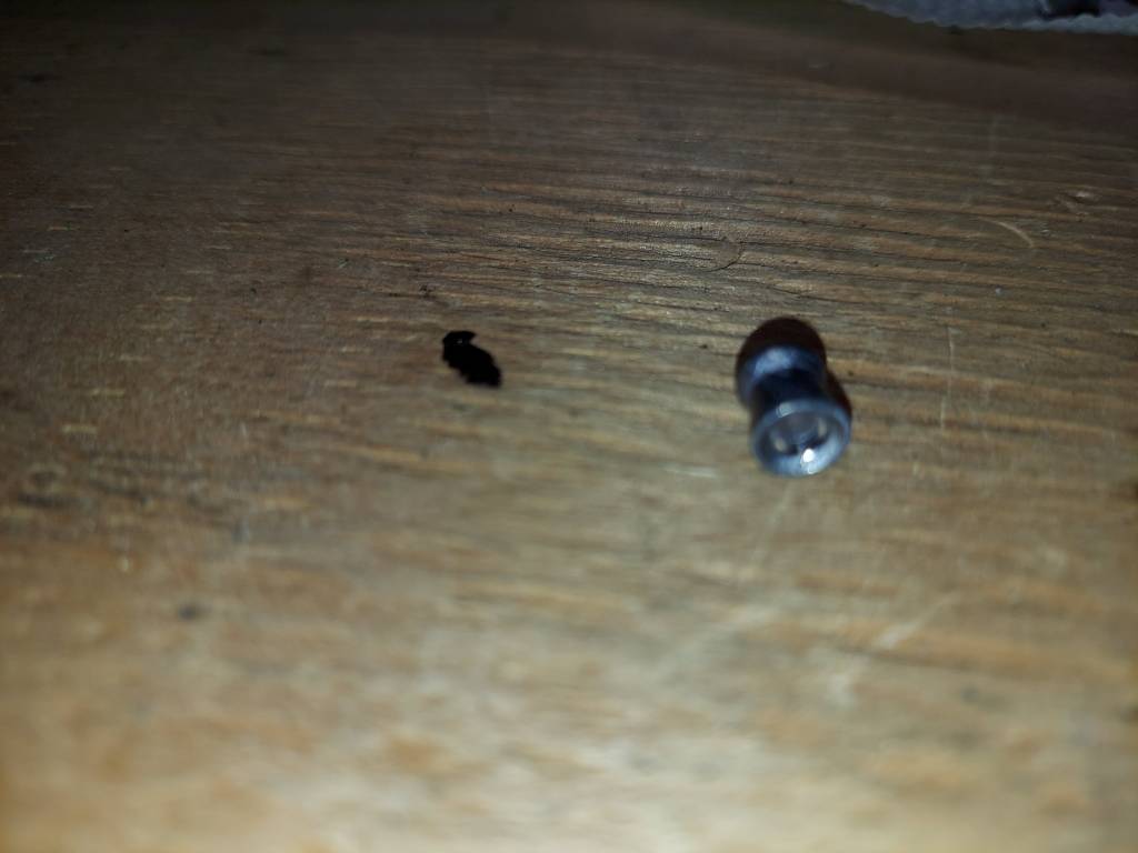

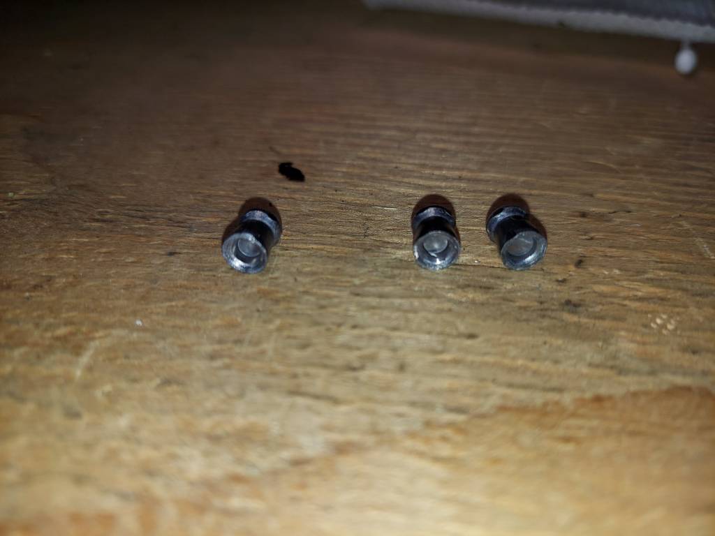

In the next to the last picture, right where the pellet skirt is resting against the fabric, there appears to be material missing from the skirt. That looks really concerning.

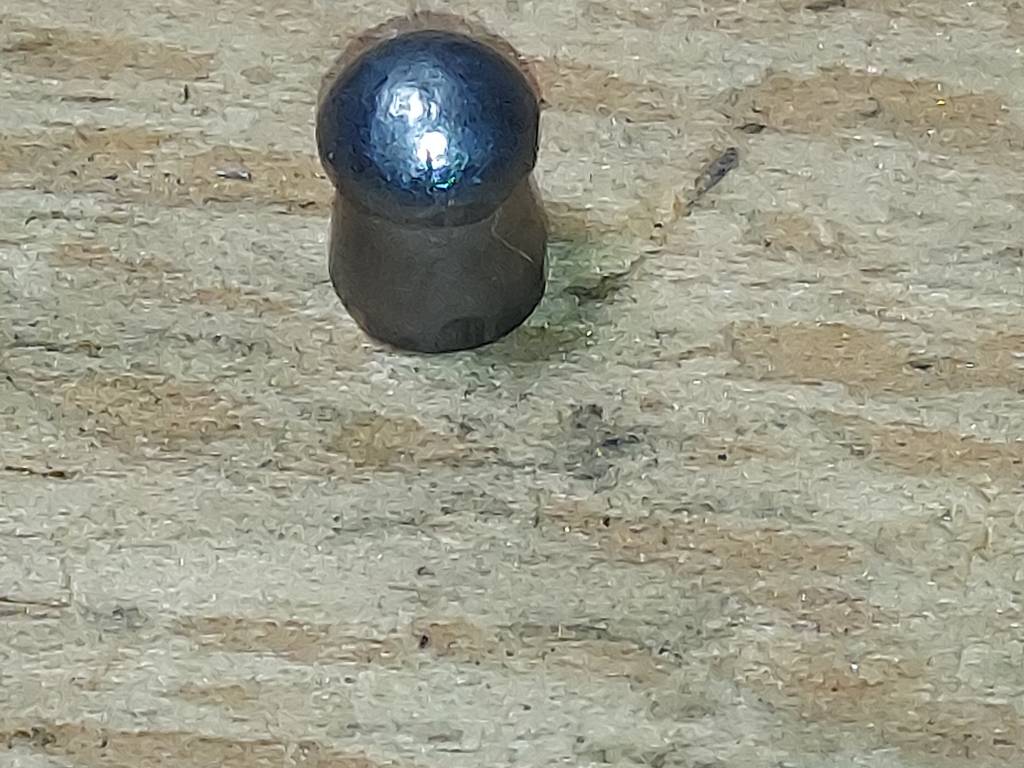

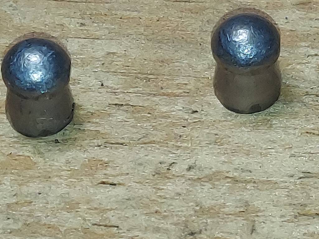

Then to a lesser extent, in the first 2 or 3 pictures, I’m not real excited about the little fins extruded behind the head where it met the rifling. Those can behave as little rudders. However it’s hard to imagine a scenario where those would have been suddenly introduced today. That’s usually more of a product of the rifling geometry and the pellet’s alloy and fit. So for example, if you recently switched to a new tin of pellets from a different manufacturing batch, that could be a reason. Otherwise I would just recommend confirming that this artifact is reasonably consistent all around the pellet’s perimeter, meaning you see the same little fin behind the spot where each land engraved the head. If not, they can help set up a spiral.

If you look at the pellet pictures above, the statements by nervoustrig are correct. This tells me that the pellet head diameter might be too large, to have this type of deformation. Also, by looking at the sides of the pellet, they kinda look a little bit rough to me. I'd like to see a picture of the pellet not from the side, but from the rear. I'd also like to see a picture of the dome of the pellet. This would give a more rounded picture of what's going on with the pellet.

This last one hasn't been loaded. right out of a tin
2D1C,
I would maybe try a different batch of pellets. To me, those heads have too many imperfections in them. What weight and brand pellets are these?
This is the reason H&N discontinued the Sniper Mediums along with some others. The heads were not coming out smooth, and had tiny imperfections in them, and their performance, or lack thereof, proved that. Couple that with a possibility too tight of a pellet/barrel relationship, along with too fast/slow of a velocity, and that could be your problem. It might be as simple as trying a different tin/lot of the same pellet.
