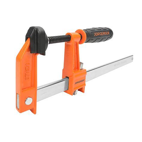

I found the pieces in a puller set I have and drilled some holes.
I make poor Mcgiver, but it works on my 30 and 95. Barrel bender also.
I’m about to tinker with my HW30 and put a vortek kit in it.
Will this be more than adequate to help with the spring removal? Would this work with a magnum springer too?

I have used this exact same quick grip to work on my spring guns for 10+ years. Works great on the R7 and hw50s, and OK but a bit more challenging on guns that have a screw on trigger block (e.g., R1 and hw97k). There are certainly better designs for a spring compressor, but this gets the job done.

Any bar or pipe clamp will work, but one with deep jaws works better. You need a little more reach on the jaws than a standard pipe clamp with most guns.
You need at least 3-4 inches of worm gear to handle a long spring. Some clamps don't have enough and you can't relieve all the tension before you run out of screw. So a clamp with at least a 4" range is best.
I make little wood cushion blocks to fit the yoke and breech. One under the comp tube to support it too. It keeps things aligned and prevents the gun from slipping out of the jaws while you are wrestling the pins.

I've used a bar clamp on a couple of rifles and got the job done. The potential of a slip or a scratch is real.
I bought a nice bar clamp to use as a compressor and it all worked good in my mind. But when I put the D34 in it I couldn't get a proper bite on it. I figured it out with some wood blocks but it was less than perfect. It would have been fine on some other rifles where you remove the trigger first.
When I centered and tapped in the pins it wasn't a good foundation for the rifle. The bar clamp compressed the spring but it didn't offer a solid workspace to center the holes and get the pins in. Again the potential for a scratch or a slip is there.
A nice saddle to hold the action is a definite plus. And getting good centered pressure without the chance of a slip at the breech is too. A wooden jig with a stop block at one end and a long screw at the other would be a more professional way to get it done. If you had problems getting things lined up under pressure it would hold the gun nicely while you twisted on it a bit.
If a guy planned to do it more than once or twice a little home made outfit would be worth the time.

Ya, you got to be more careful with the clamp one like I posted .. it's slipped on me once or twice . Mostly from butter fingers or in hurry . I use to have pictures of it in use on a hatsan and hw. I guess I deleted them .. you know you never need them till there gone then need them ..lol
