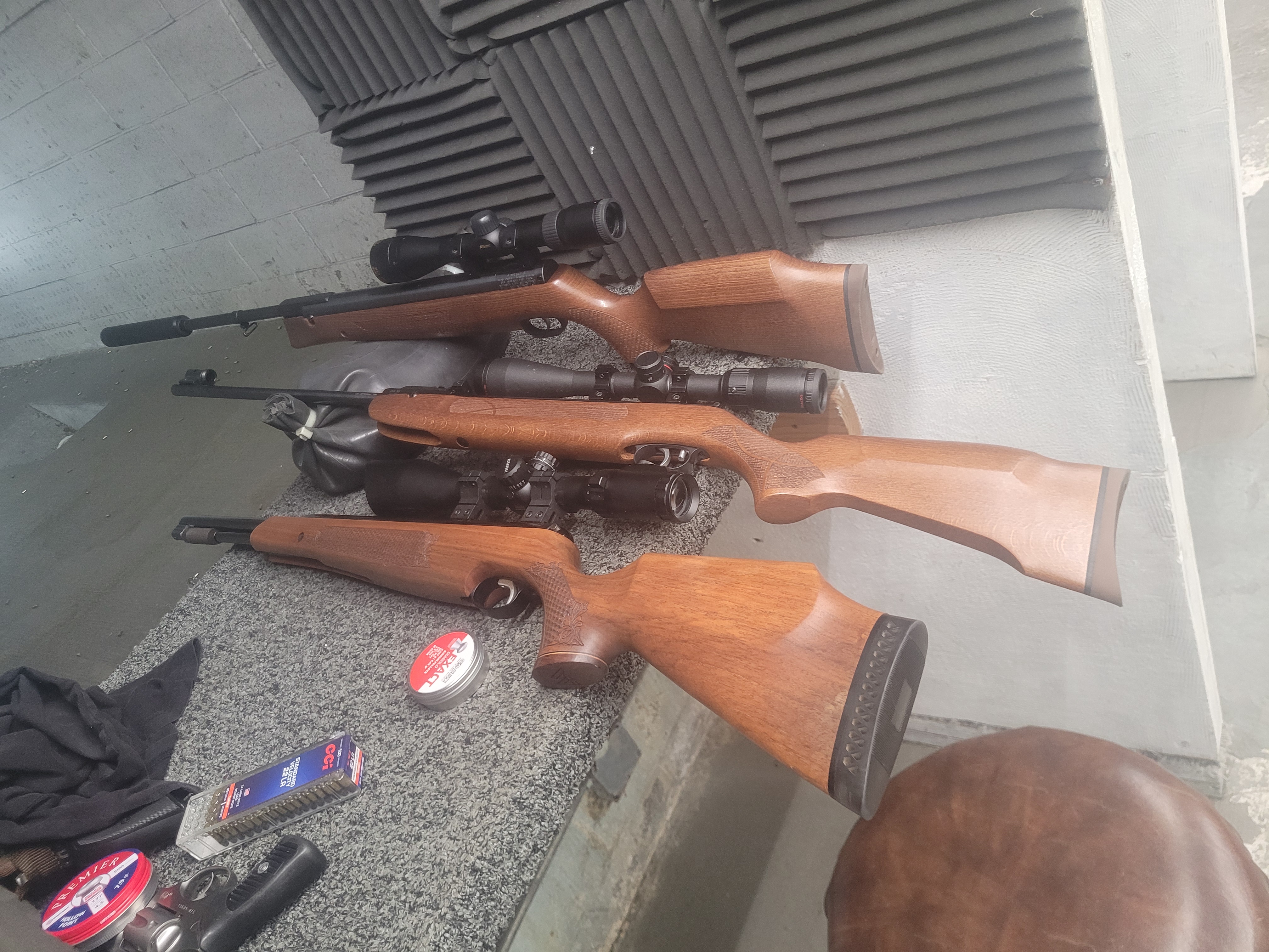

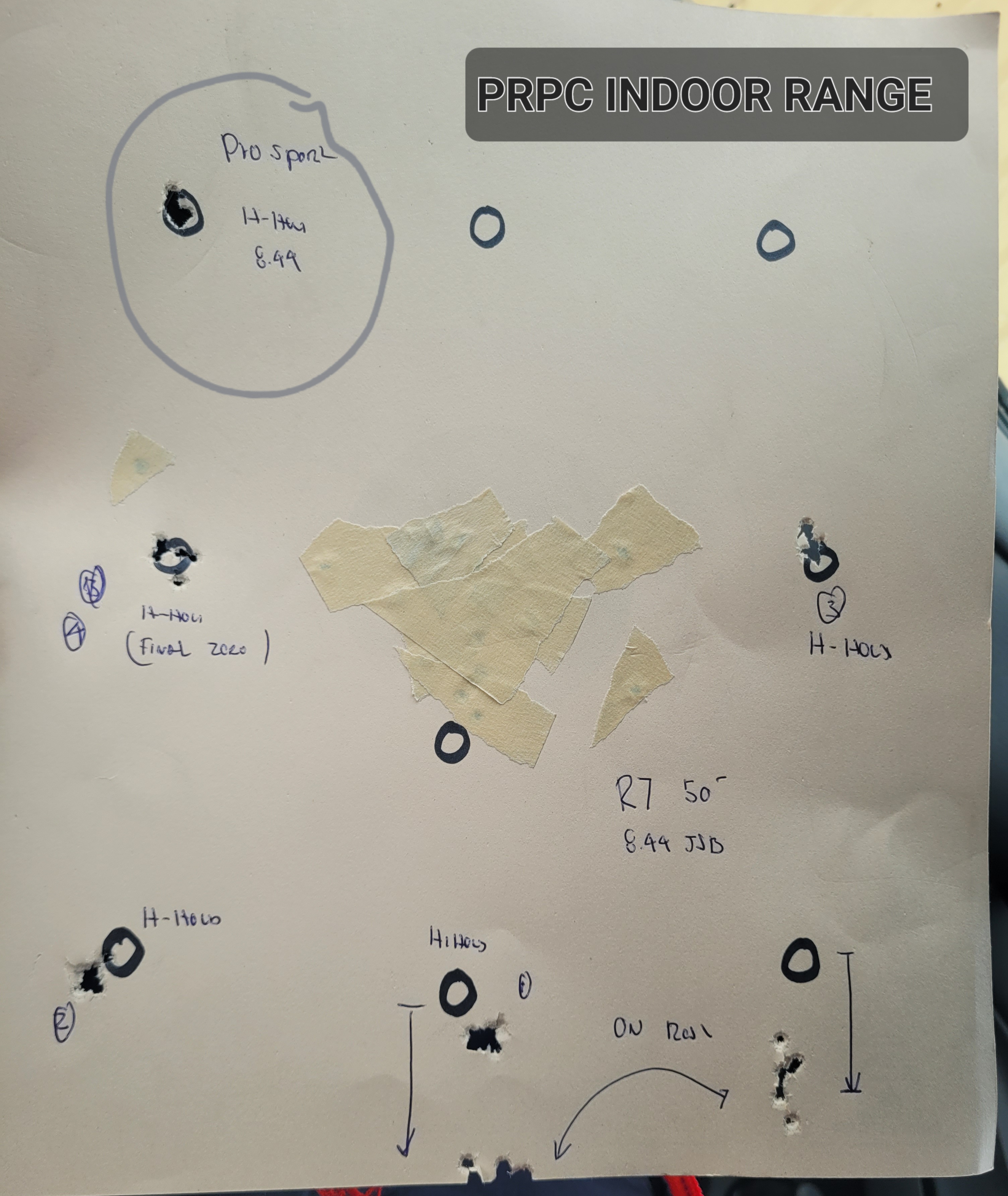

I was just at the indoor range shooting my R7 .177 at fifty feet. I was zeroing a scope I hadn't remembered where it was at. The gun was shot rested in my hand with my hand on top of a hard sand bag.
After I got it where I wanted I decided to see how it shot rested directly on top of the sandbag nestled in my shoulder. As you can see the groups dropped an inch plus and were all over the place.
I ended this session with one group from my .177 pro sport. Also hand held over a rest.

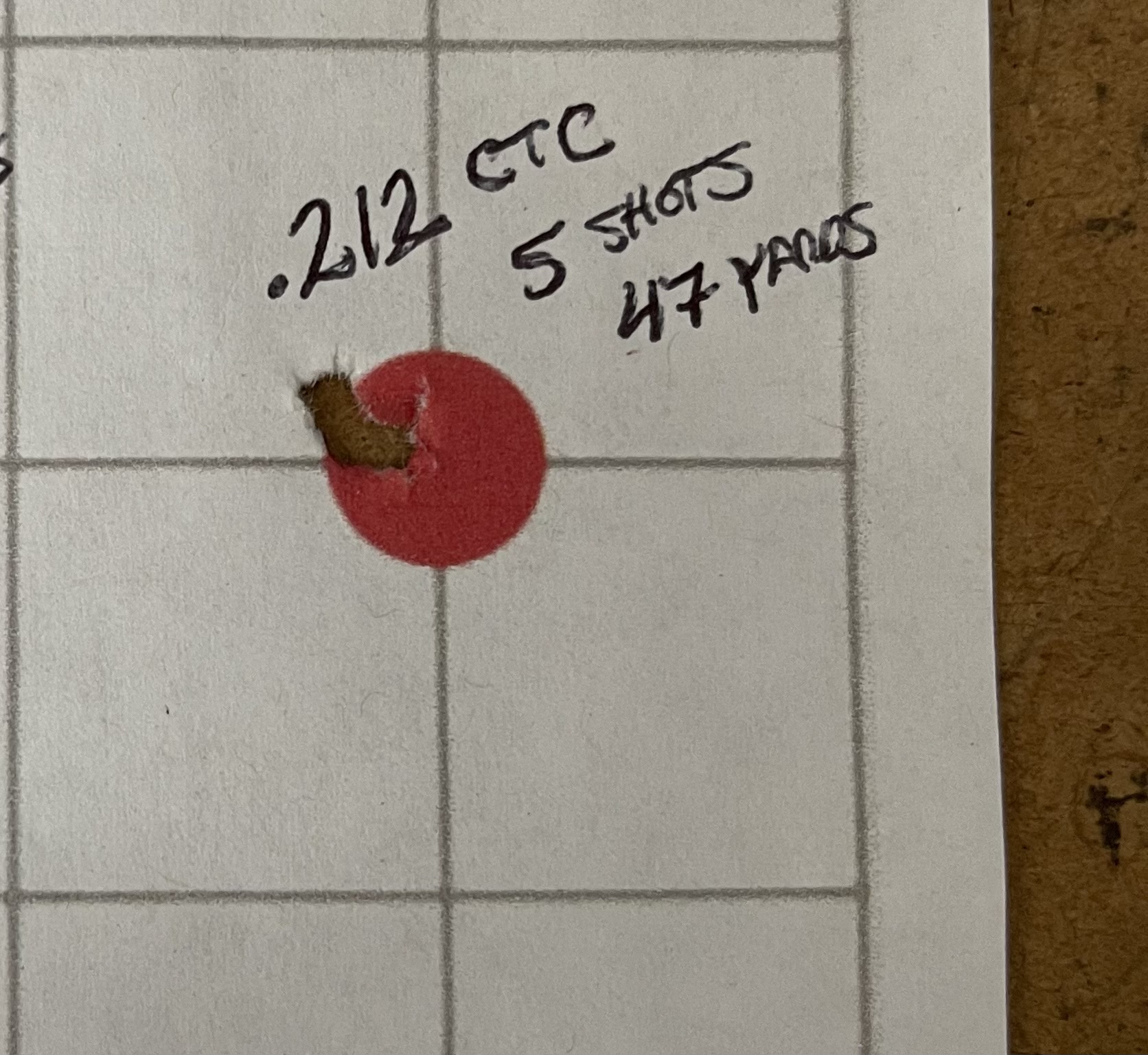

I shot my smallest group to date at 42 yards with my 97K rested like this…..
The red dot is 1/2” and the group was .212” ctc I wrote 47 yards on the target but that was incorrect it was actually 42 yards…
I hold the fore end with my left hand lightly to keep it centered and no cheek pressure on the stock. I used 15X on the scope, I later sold that scope. Currently have a Sightron bigsky SII 4-16X42 mill dot on my 97K.
