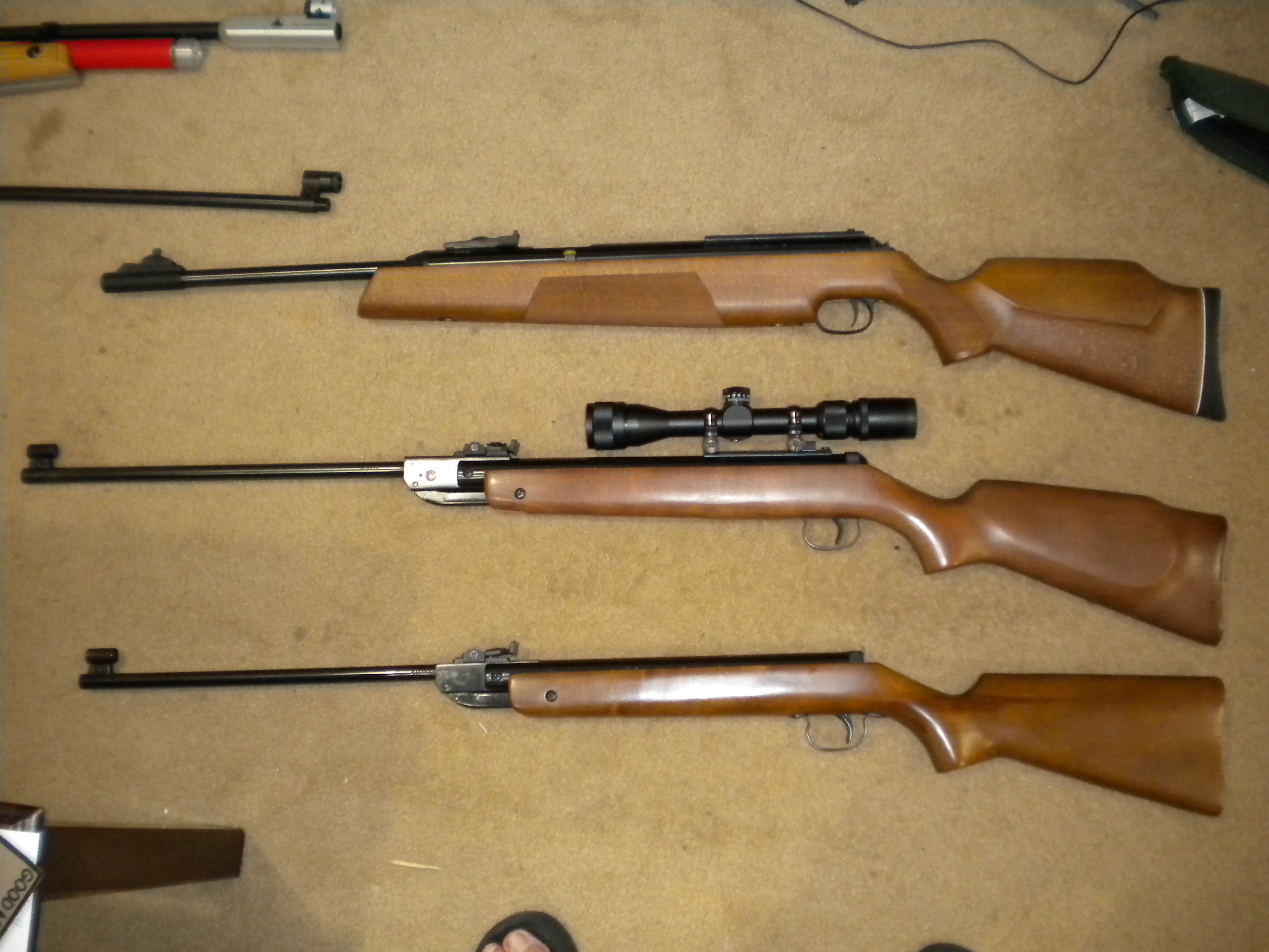

I took these numbers off the Pyramid and AOA websites and did not calculate the energy. The actual velocities may be less, and the changes with weight of the pellet but even so, the velocity differences are significant between the below guns. I know my Xisco B28 (direct clone of RWsS 350 was shooting at about 850 fps.
HW 80 22 cal - 760 fps
RWS 350 22 cal - 870 fps
Hatsan 135 QE 22 cal 1000 fps.
You also have other Dianas, other Hatsans and Gamos and the Webley Patriot in this mix. However as far as a refined mangnum springer, the HW 80 is on the top of the heap and probably the most accurate. The RWS 350 and other Dianas are almost as good.
Here is your FPE numbers.
HW 80 22 cal - 760 fps 18.80 FPE
RWS 350 22 cal - 870 fps 24.64 FPE
Hatsan 135 QE 22 cal 1000 fps. 32.56 FPE
The above was calculated using 14.66 gr pellet weight for all three.
