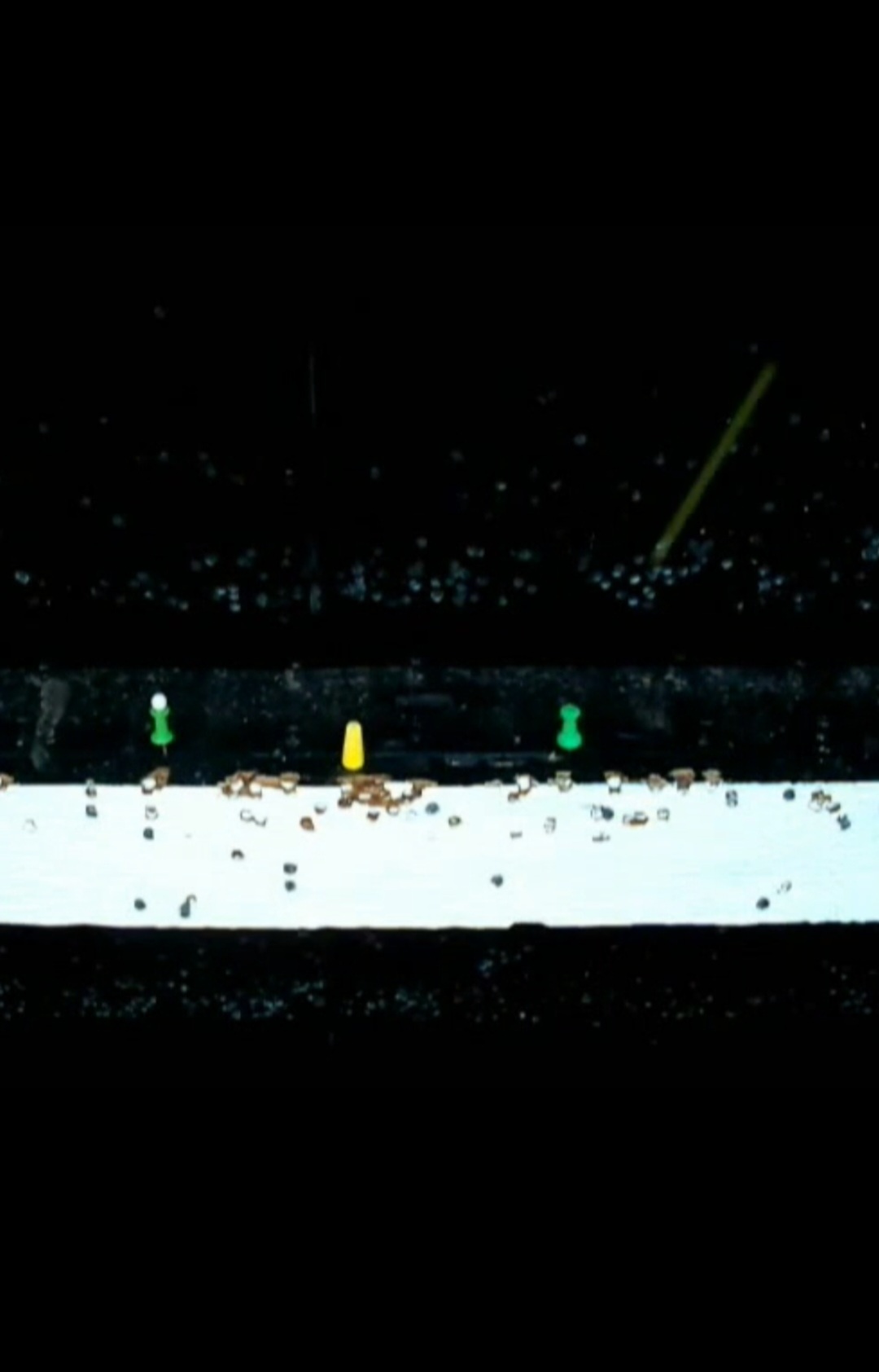

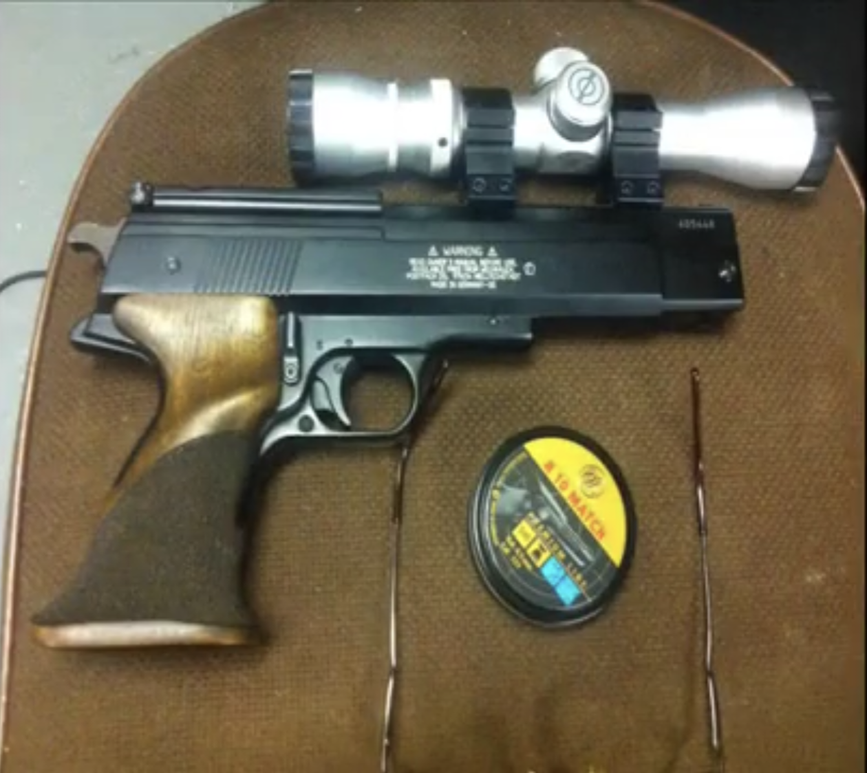

I have a pumper that can do that good. In fact I have shot .25 cal airsoft pellets off of a tack at at a measured 75 feet with it.
Fortunately, I got that shoot on video.
Here's a screen shot.
Reactions: BryanH
