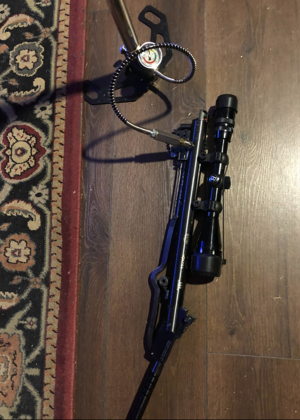

Well, I don't remember having to charge up my springers before a shoot.
