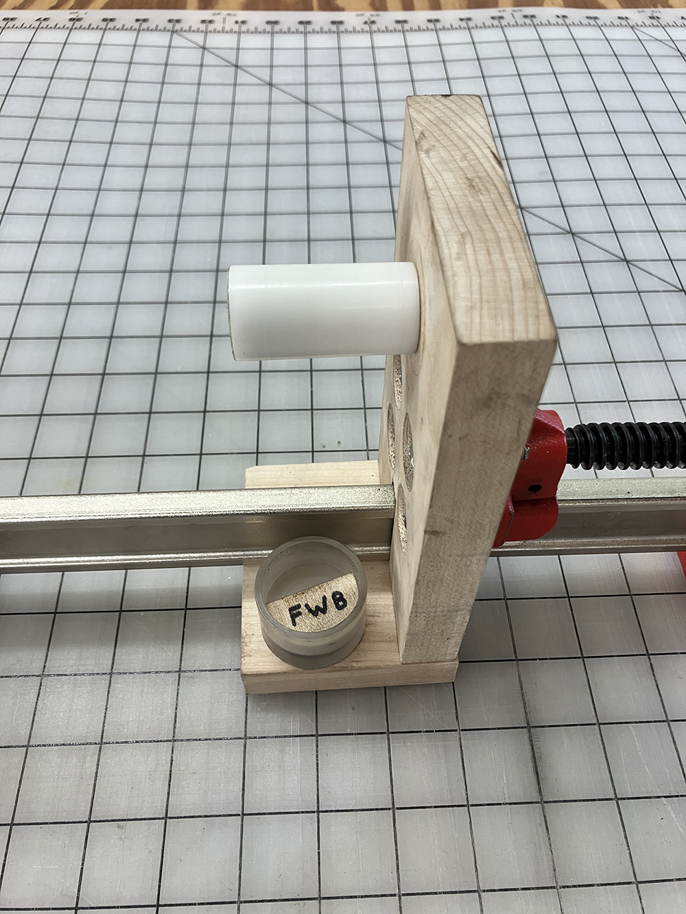

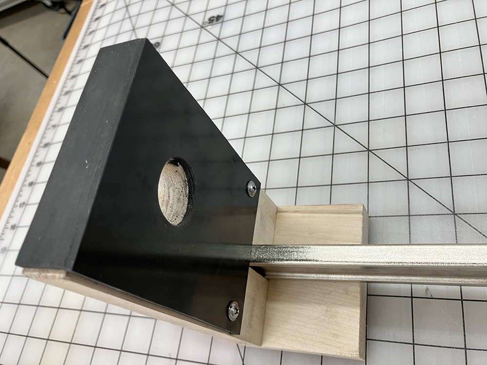

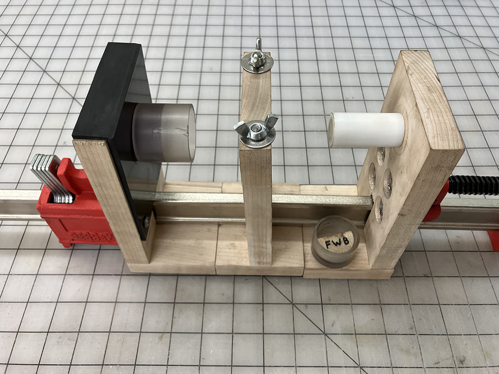

The bottom line is every spring compressor pictured above gets the job done. We are only dealing with preloaded springs and not fully compressed springs here folks. I built my compressor to be a height adjustable version of the Air Venturi. Each 5mm (thread diameter) rail clamp screw on my compressor provides well over 500 pounds of clamping force when torqued to only 20 inch pounds and more torque can be applied if needed. If I thought that wasn’t enough I could add more scope rings or use rings with more screws. Does anyone know how many pounds of preload most springers have?

You have a good design that stays centered and adjusts for height and you don't need to build a shed to store a massive contraption in. The only issues I see is if the scope rings snap, (highly unlikely)?

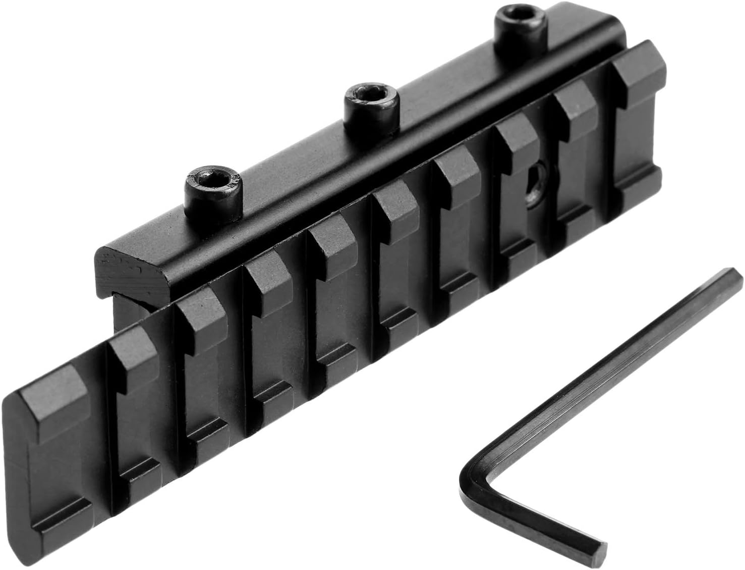

This would be the mount I will use for a dovetail.
I am going to upgrade my dovetail attachment at some point and I am going to look into Hooke’s Law. Thanks for the information.

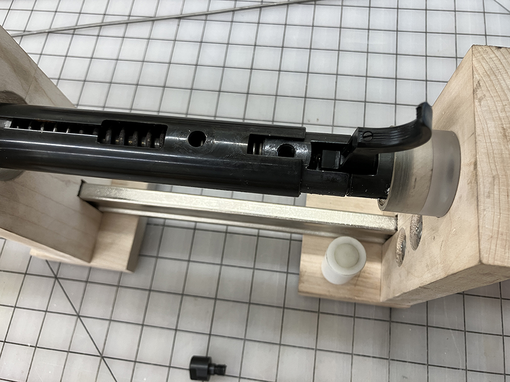

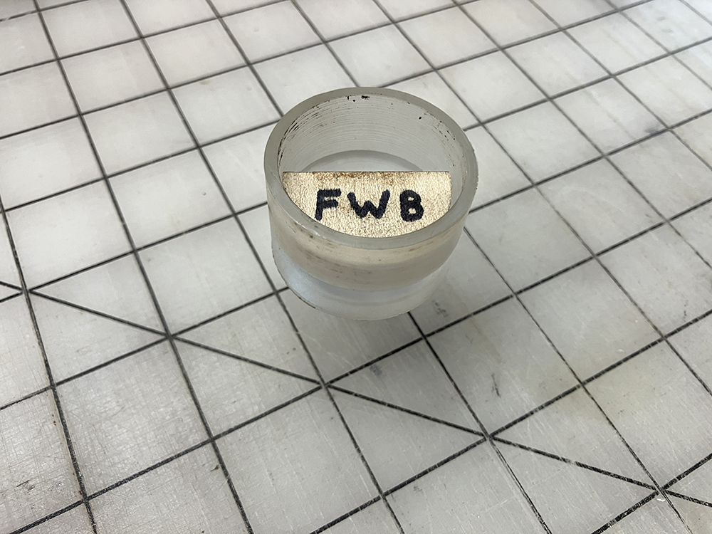

Finally built one. Heavy duty. Very long adjustable thread for extra long preset. The PVC coupling is filled with an epoxy wood putty and the end cap is inserted in a baggie and pressed in the filler for a form fitting cap holder. Started with the Hatsan 135. Went in like butter. Thank you everyone for your ideas.
