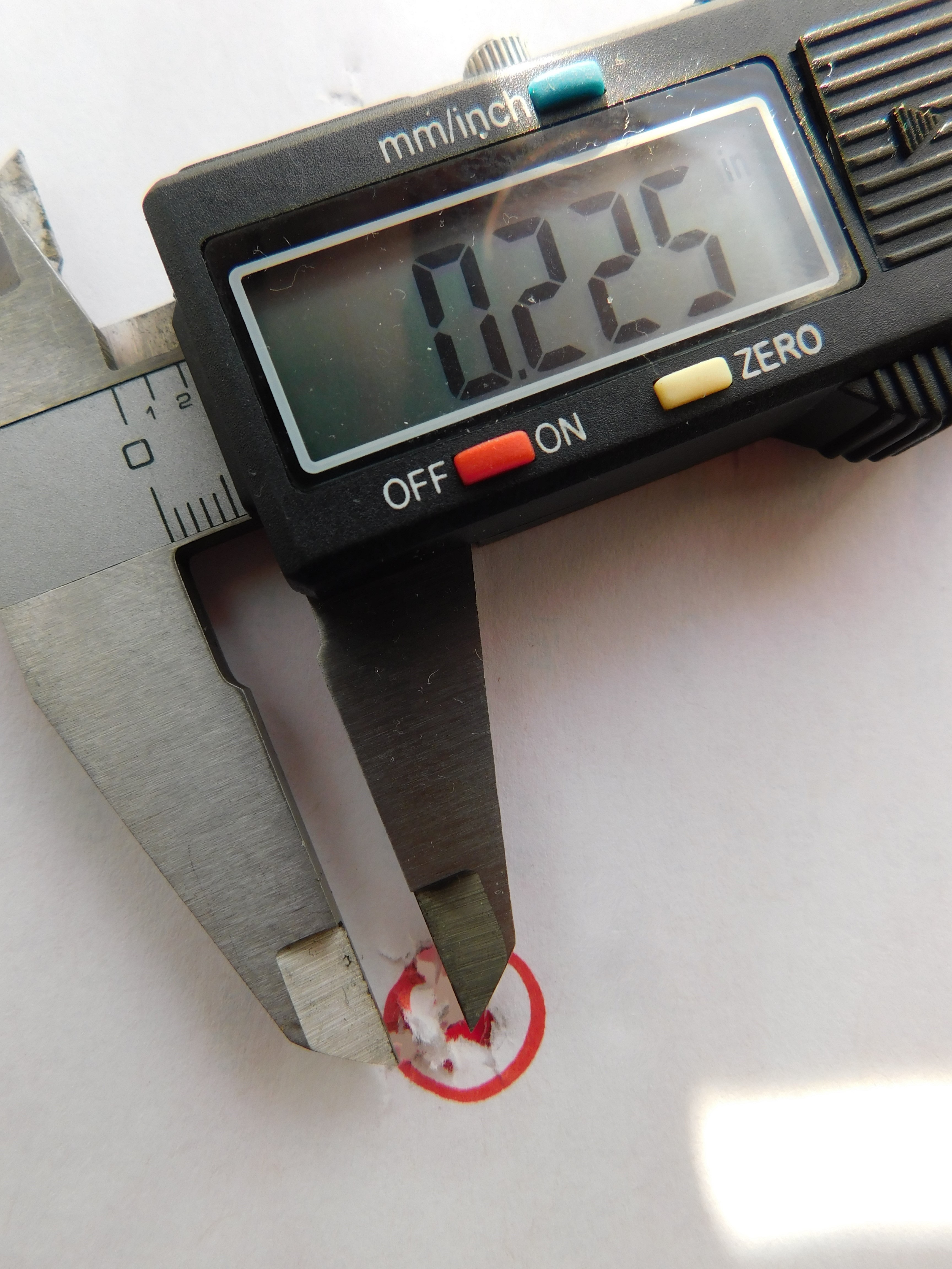

I always thought 1/4" 5 shot group or better at 25 yards for a high end sporter springer. Kind of similar to a 1 MOA @ 100 yard firearm which is considered accurate and guaranteed by several manufactures for generally 3 shots groups. Not saying a 1/4" @ 25 yards springer would come close to a 1 MOA firearm at 100 yards. I have gotten 1/4" groups at 25 yards at times with my FWB 124D but not the majority of times.

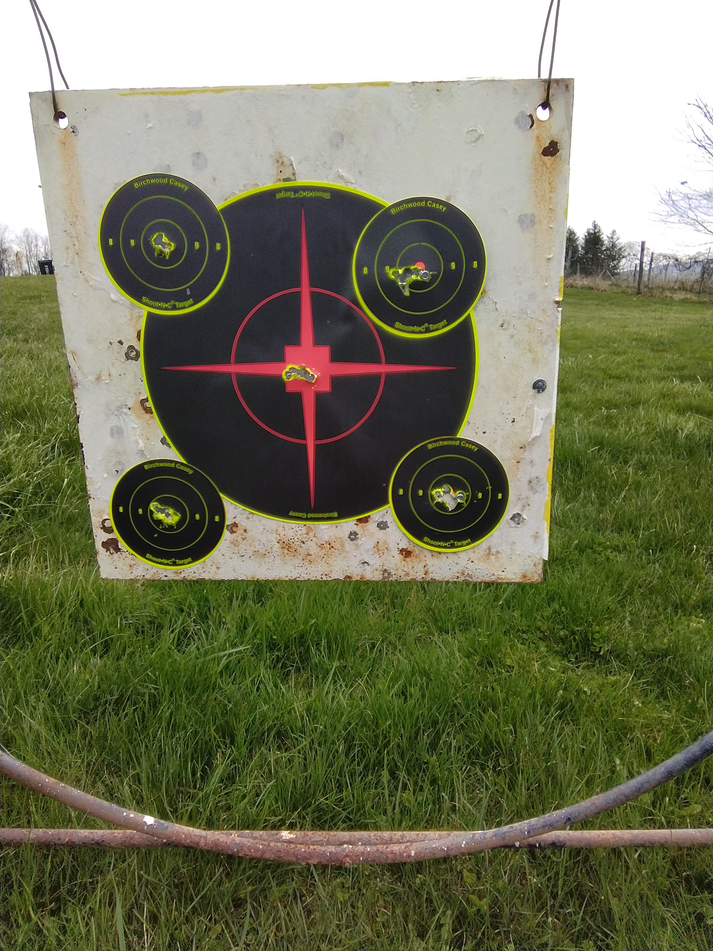

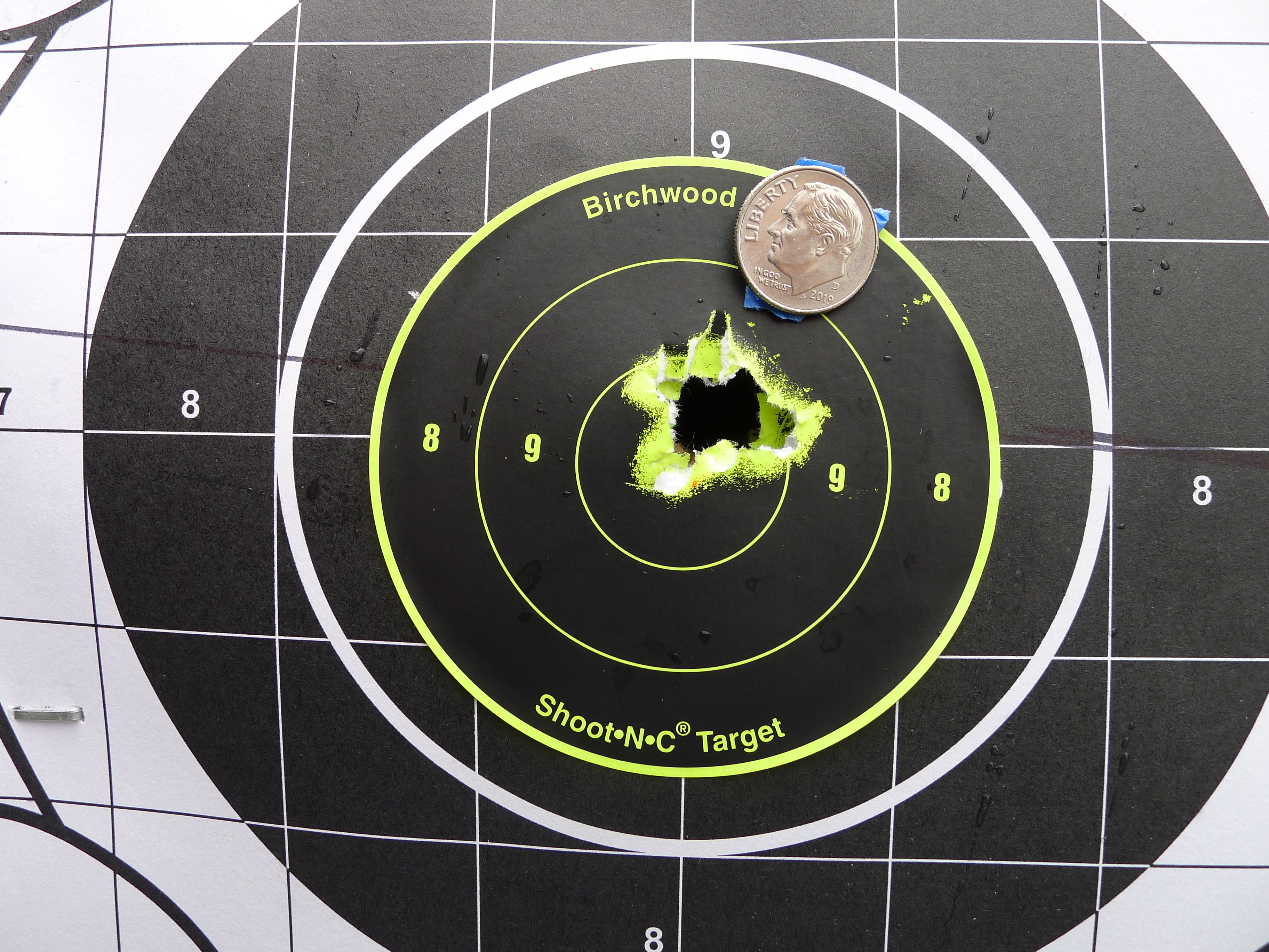

FWB 300su at 25 yards, 5 shots in each bullseye, today today as a matter of fact.. thats springer accuracy to me.

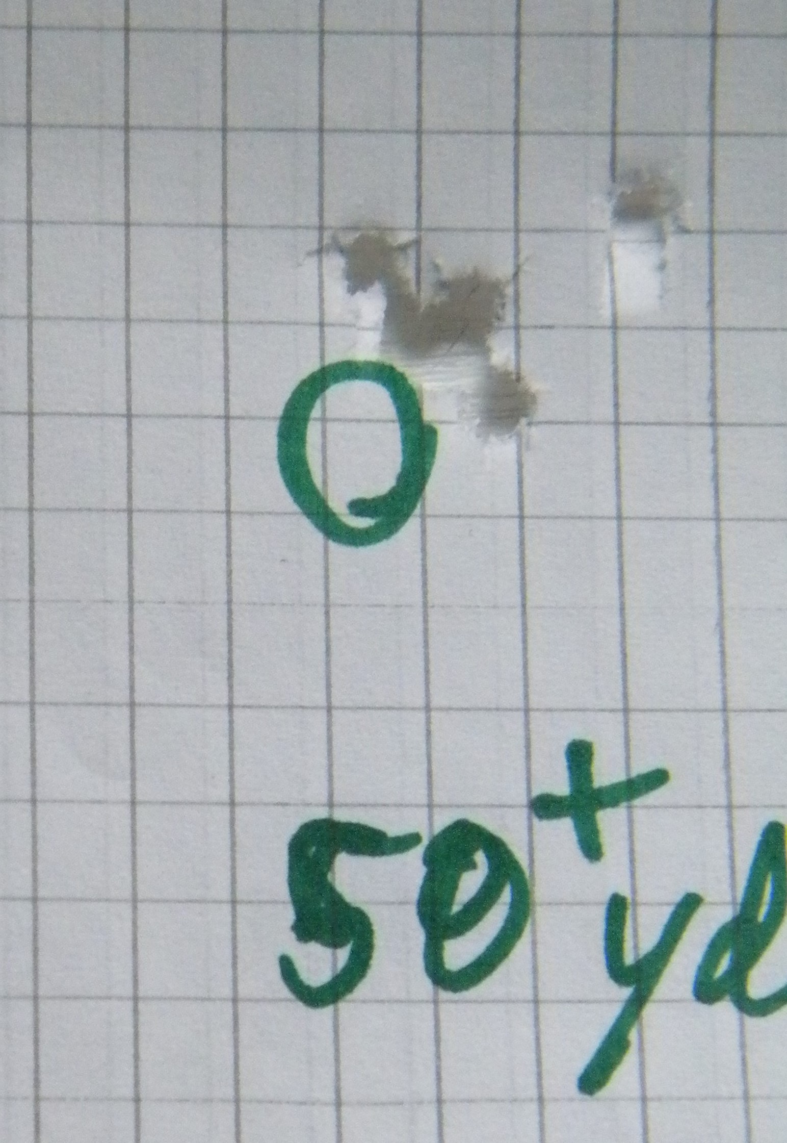

I’d consider “target accuracy” in a springer to mean that the gun itself is capable of MOA or less at 50 yards, (less than that for low powered guns), and also has extremely little hold sensitivity.

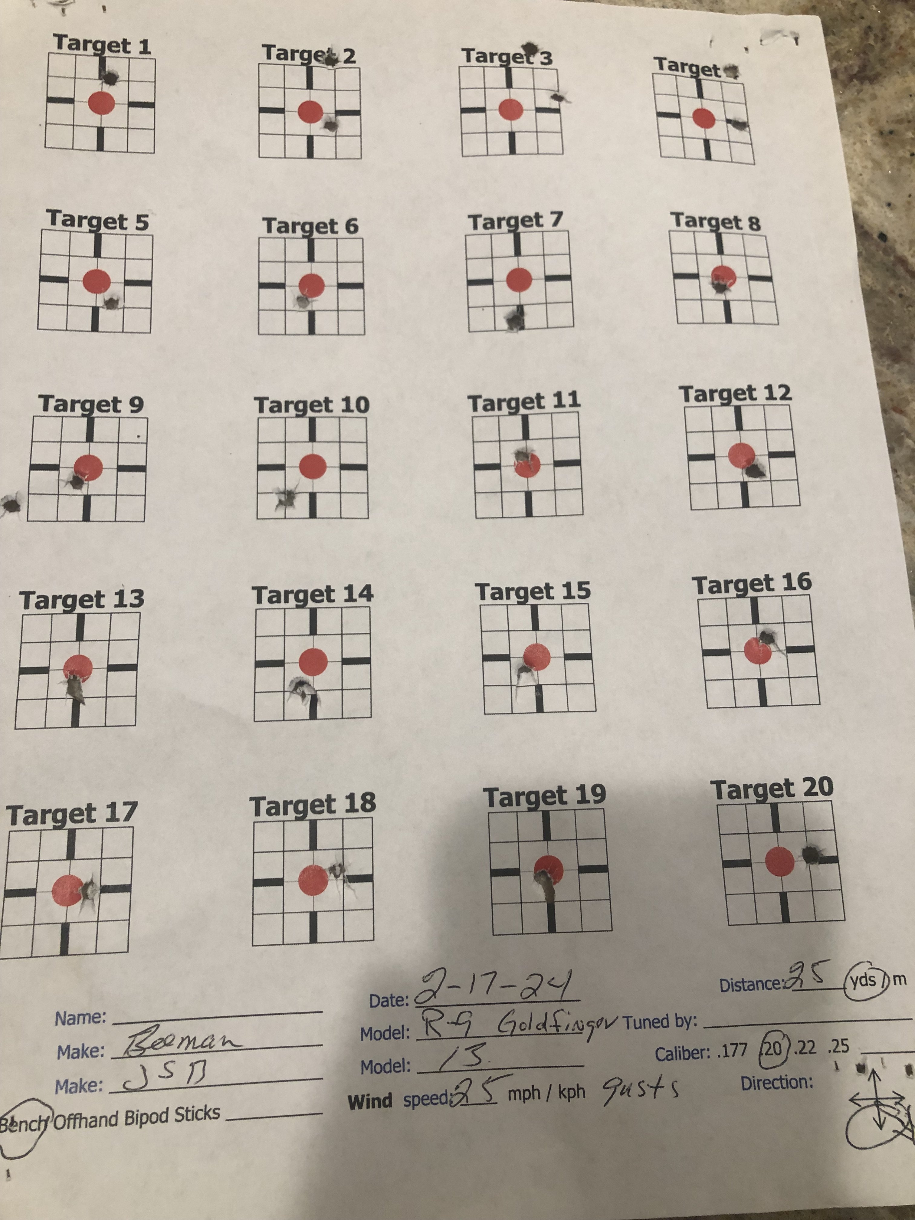

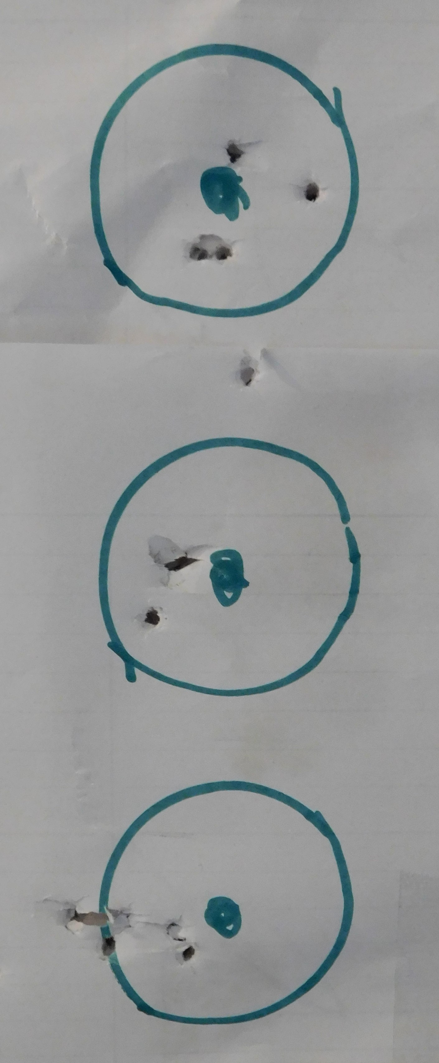

Old Beeman .20 Goldfinger

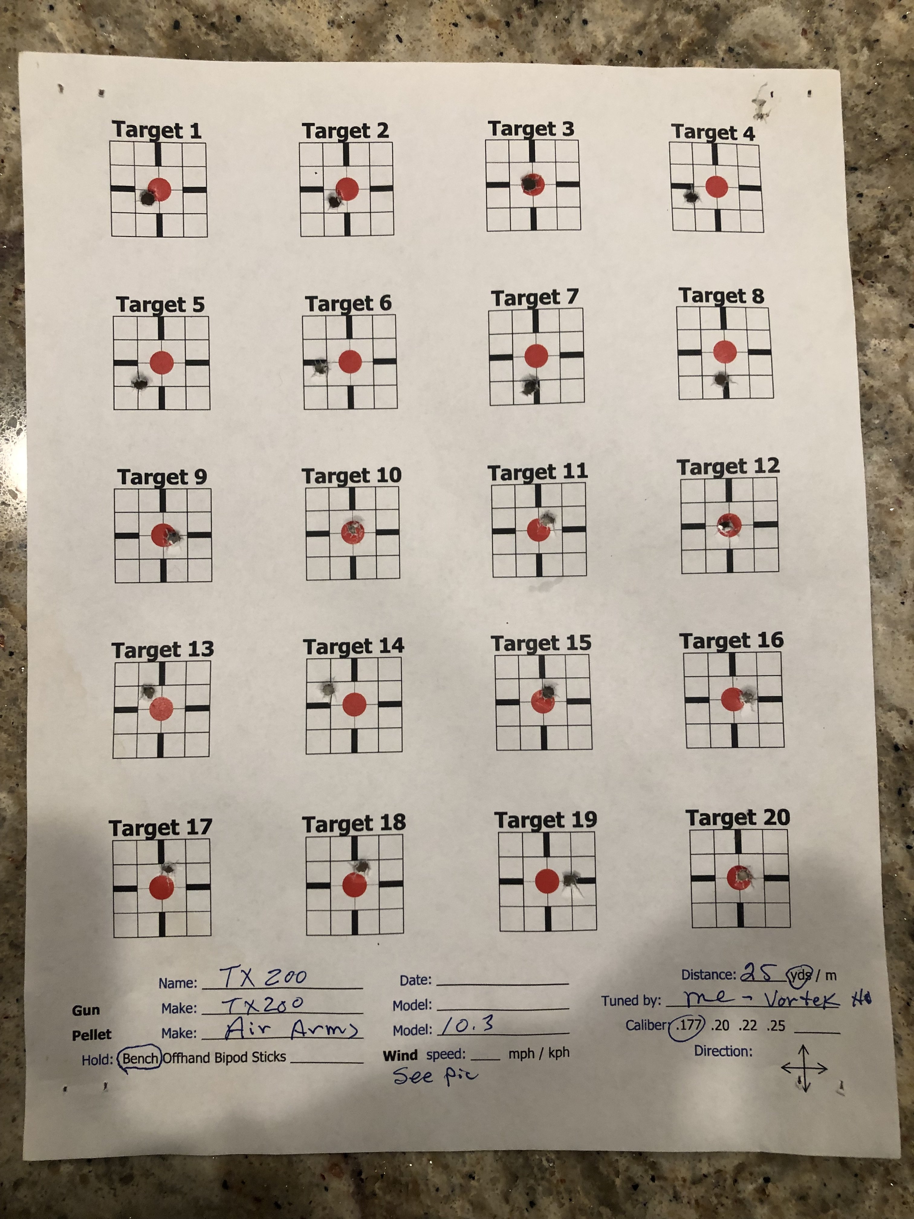

Tx200 vortek HO

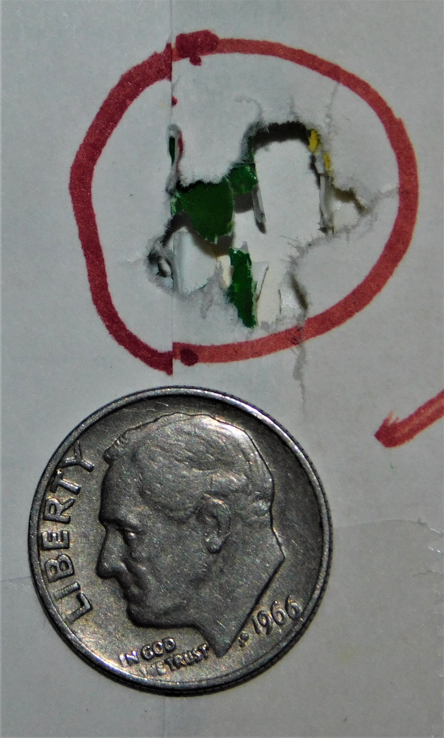

It means different things to different people....in the older days, hitting a pop can was accurate. Then as guns improved man created targets to shoot at. I can remember hitting one inch at 25 yes was accurate !! Then years later it was dime size at 25 yds.
Today we expect dime size at 40 yrs and many will do that. Over an inch at 50 yrs is no longer acceptable...accuracy requirements change as guns improve and will continue to do so. We always want more than what we are getting, just life !!
