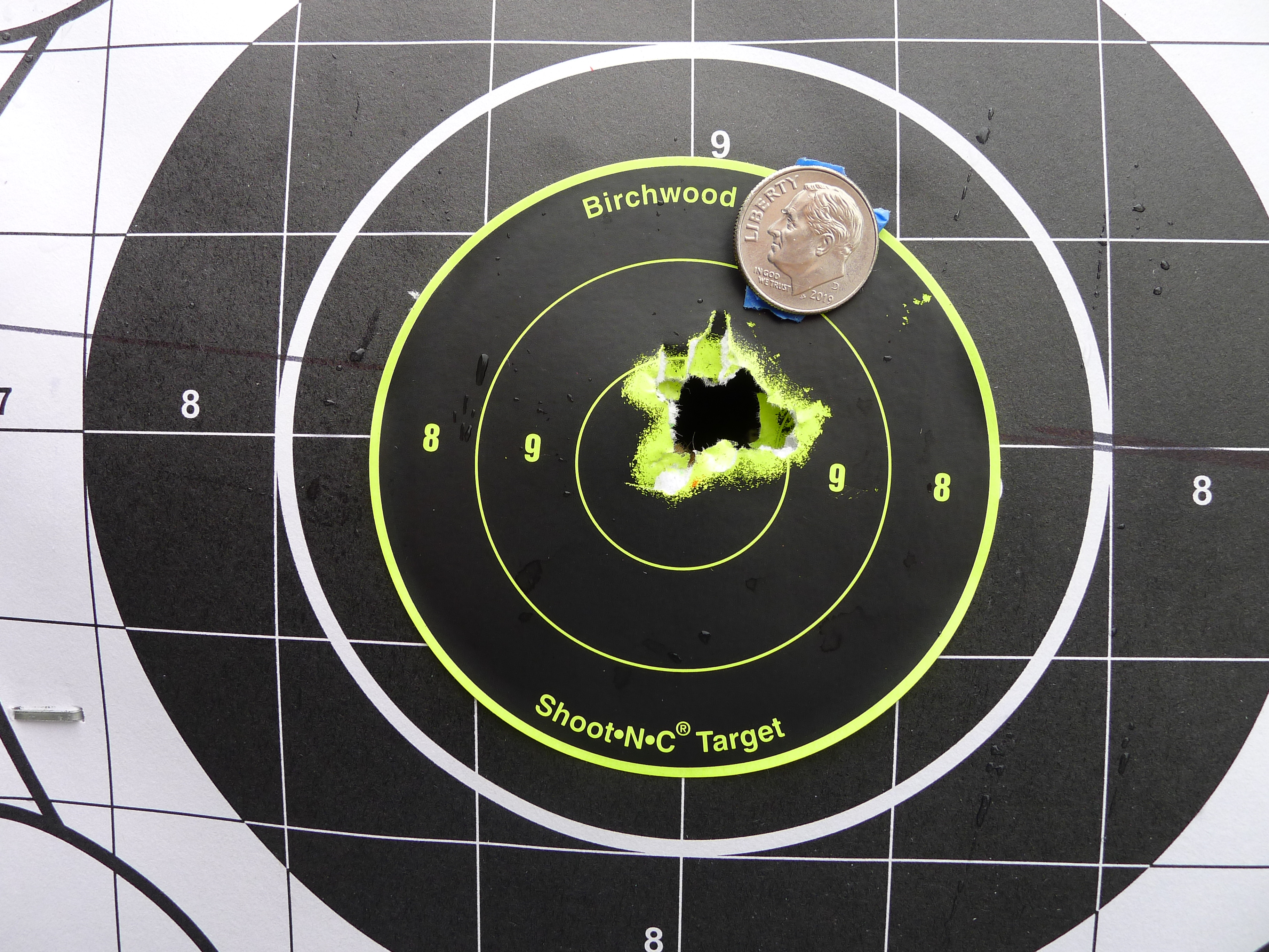

I am curious as well. This is a typical 5 shot group from my impact at 25 yards but I have a tuned hw97k coming. View attachment 451173
I think you'll see a few groups like that at 25 yards. Maybe not typical, but certainly not unusual either. I've shot lots of sub MOA groups at 50 yards with my TX200 and HW95. I can't count on them to do it consistently though. With a springer it's just a lot easier to shoot a flier.

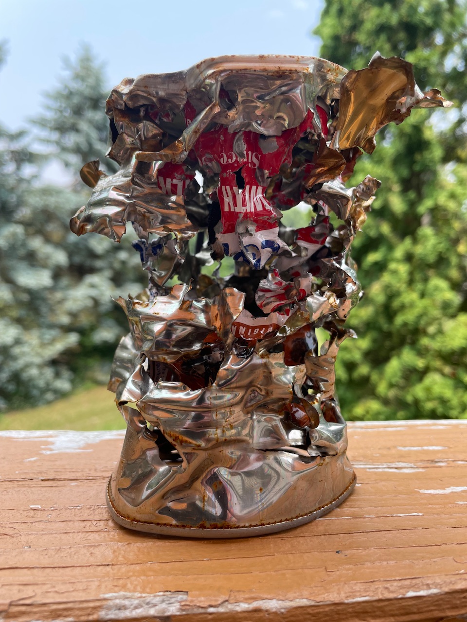

I have strings attached to an old sawhorse, with S hooks on the end so I can easily hang soda cans by the pull tab. Sometimes they get so shot up, that what you thought was a hit causes no movement. Probably shooting through the can full of holes without atually hitting in.
