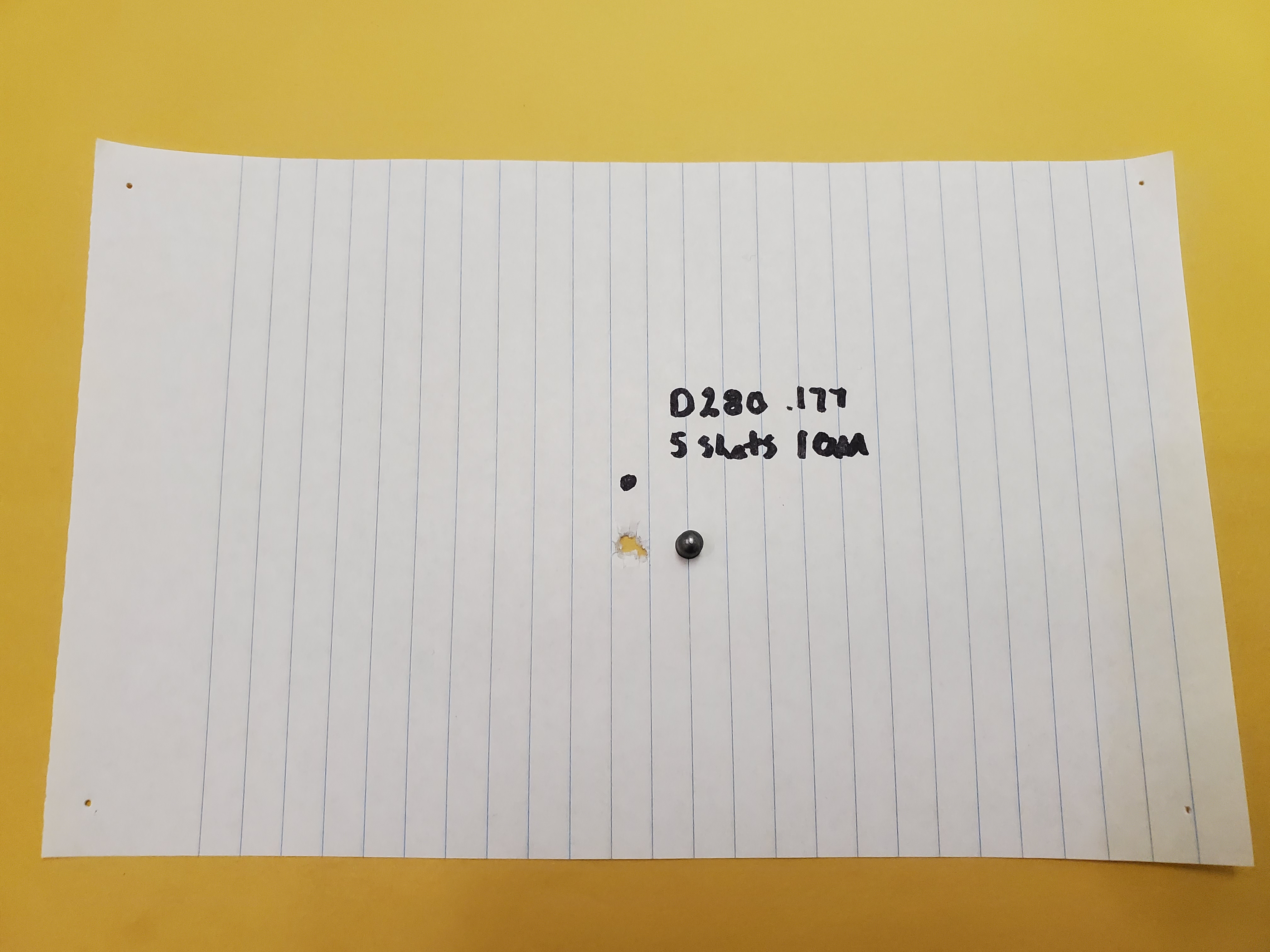

Nice shooting, looks like a lot of my groups. There is most always one that leaks just a tiny bit. If it was easy, everyone would want to play.
One group doesn't make a normal. Especially at 10 meters. I can show you lots of singular short range groups that will make your head spin. The more you stretch it out, difficulty grows exponentially harder. I thought I was a real hero shooting ten yards in my basement until shooting at 25 and 50 yards outdoors humbled me.

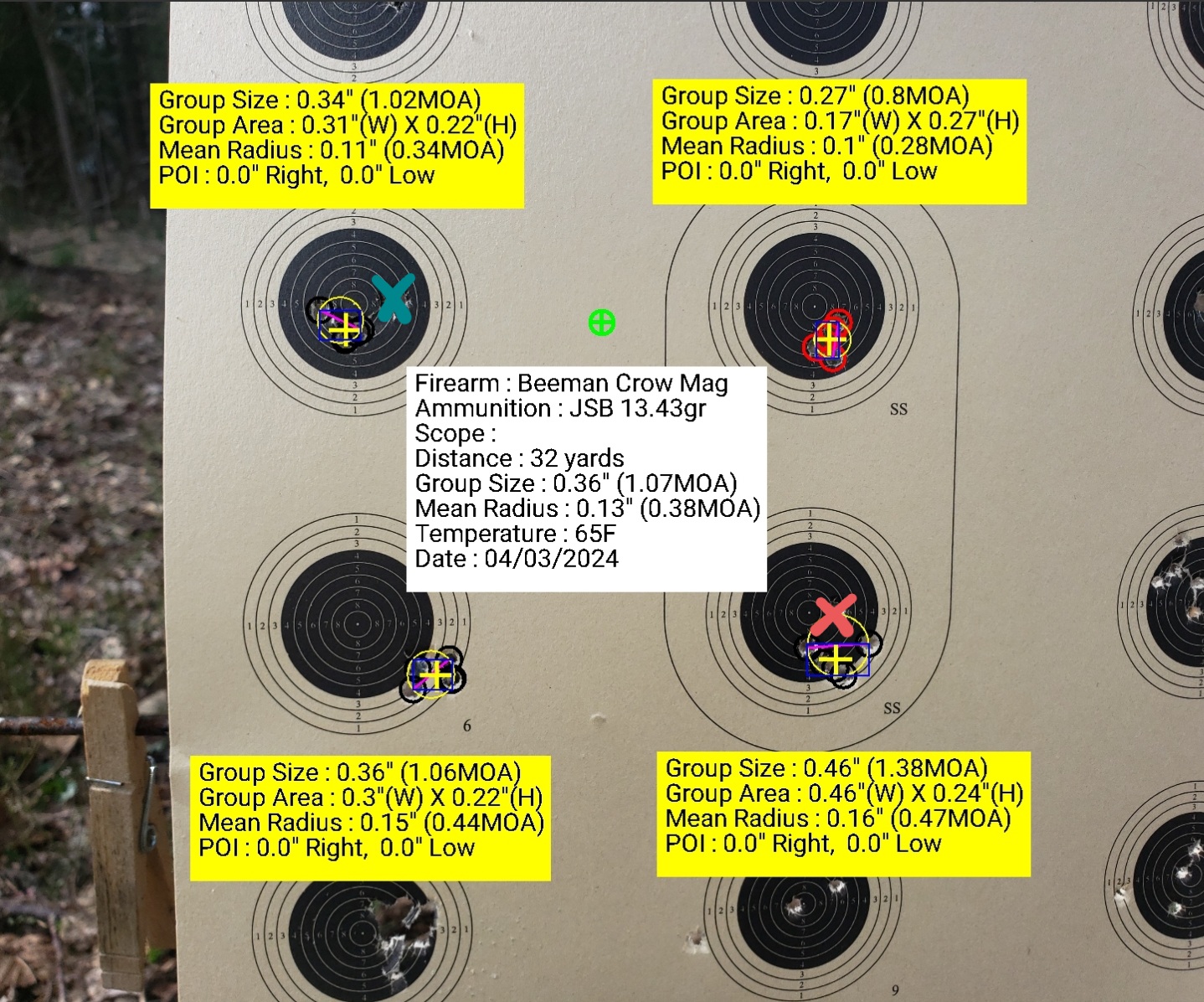

Anyway I shot 4x 5 shot groups with my Crow Mag last weekend. One group was sub MOA, 2 groups were MOA almost on the dot, and the 4th was about 1.4 MOA. A lot of people would say the 1.4 MOA group was a fluke and that I messed up, and honestly maybe it was. The thing is I can't cal a gun an "MOA gun" unless I really can do it every time. Here are the groups.
***Two X's on the page because I reused a used target (red X) and because I tried to turn a 5 shot group into a 10 WELL after the fact. This can be verified by looking at my target in a previous post.
From there I took it a step further because 3 out 4 groups being MOA with a 24ftlb .20 cal is pretty good in my books. I shot 1x 10 shot group and nope. Not MOA 9/10 were 1.25 MOA and 10/10 were closer to 1.6 MOA.
Long story short, I still don't know what this gun really is. Anyone who's shot a Crow Mag before will tell you they aren't exactly easy shooters. It could be I had a couple flyers or maybe I was just tired from cocking a magnum in quick succession. What I do know is that realistically any time I shoot that gun it will put that pellet where I am aiming way more times than not. That matters to me more than group size any day of the week.
