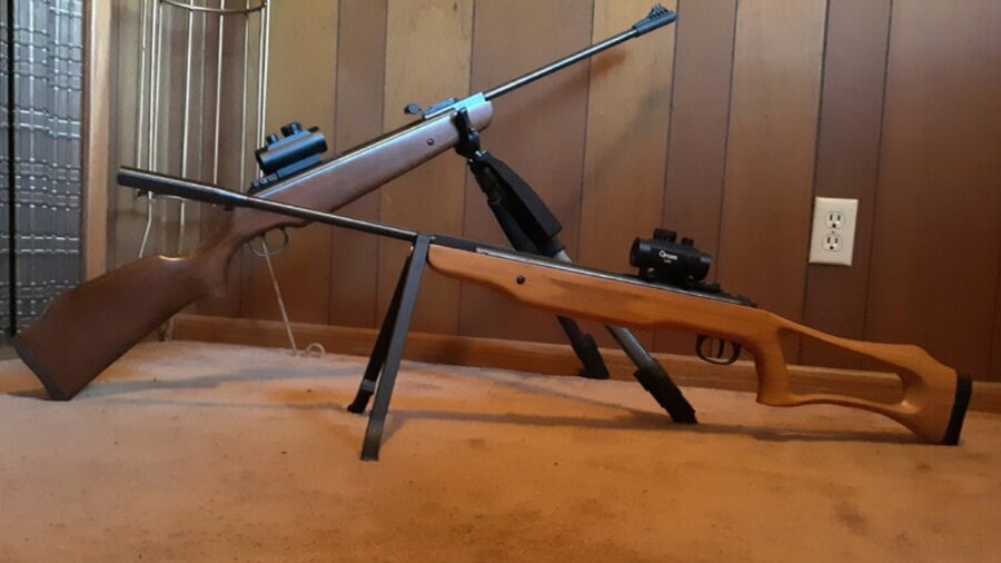

Without a doubt the best buy in airguns.
http://flyingdragonairrifles.org/index.php?route=product/product&product_id=67
I agree. Your posts on this rifle "made" me buy one.![]()
