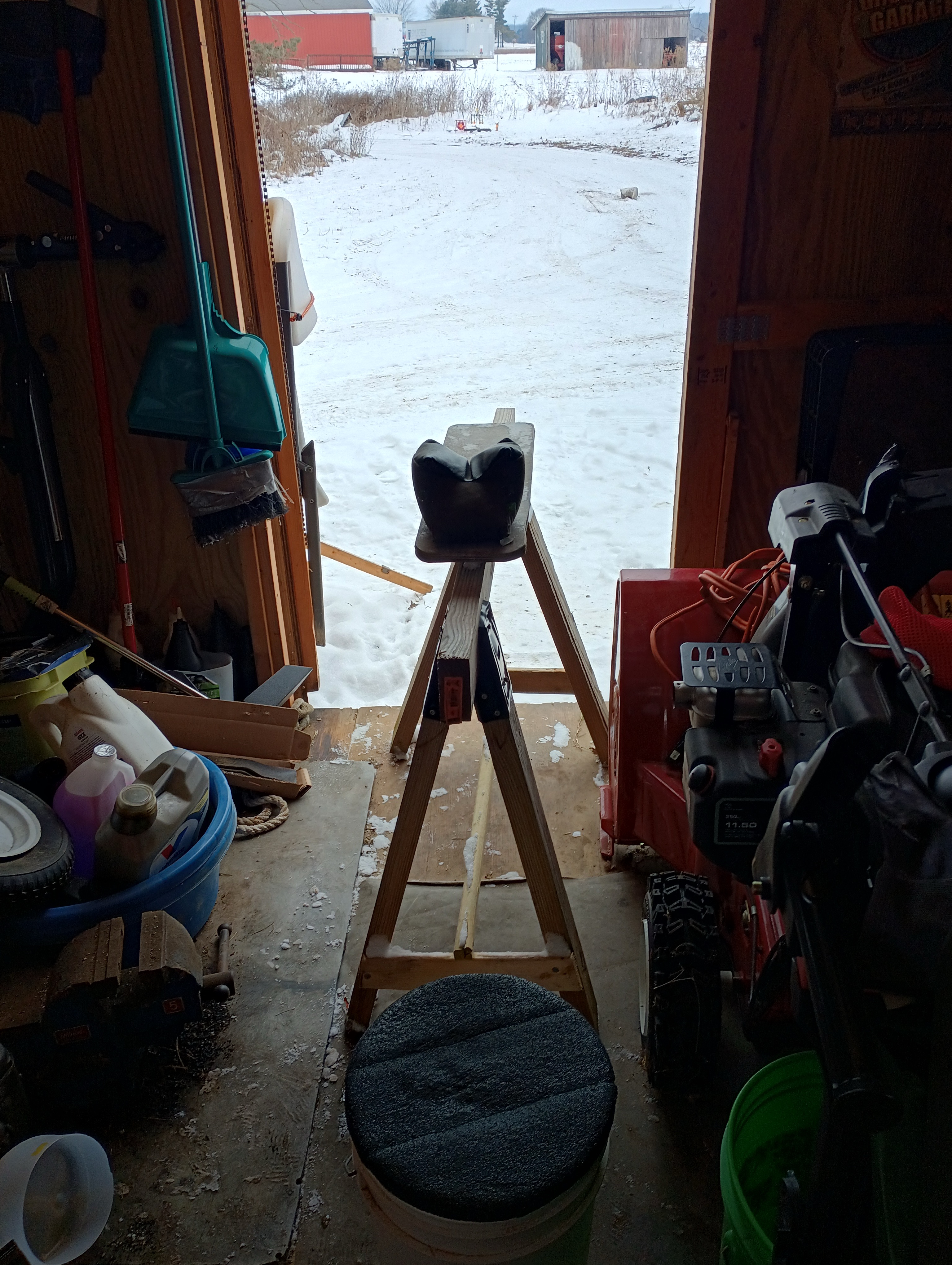

On that note I should make a 3” square foreend that fits on my one piece rest. There is almost zero friction with the roller bearing top.

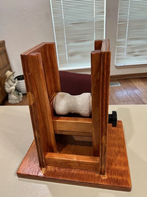

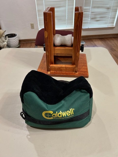

I too am one of those guys that like to take me out of the equation as much as possible. Especially when making a change to ammo or optics.
Here is a device I copied off of pictures posted on the internet. the original poster did not give any measurements, so based on knowing the paint roller was 4 inches across, I guesstimated the rest of the measurements. If I made another one I would make it shorter. For the benches I use I really didn't need something this tall. And I have seen simpler arrangements that accomplish the same thing. The roller moves very smoothly on a .25 in steel rod. Infact I have to be very careful because if I get the center of gravity too far back and let go the gun will easily roll off the rest and on to the floor. almost happed a couple of times:) I use a very plush roller (probably time for me to replace this one). This arrangement works very well for me.
I also have a Caldwell Led Sled, which is great for powder burners, but have not tried it with any of my springers for fear of the sharp jolt ruining a scope.
Man! Is that deluxe or what? Nice craftsmanship
