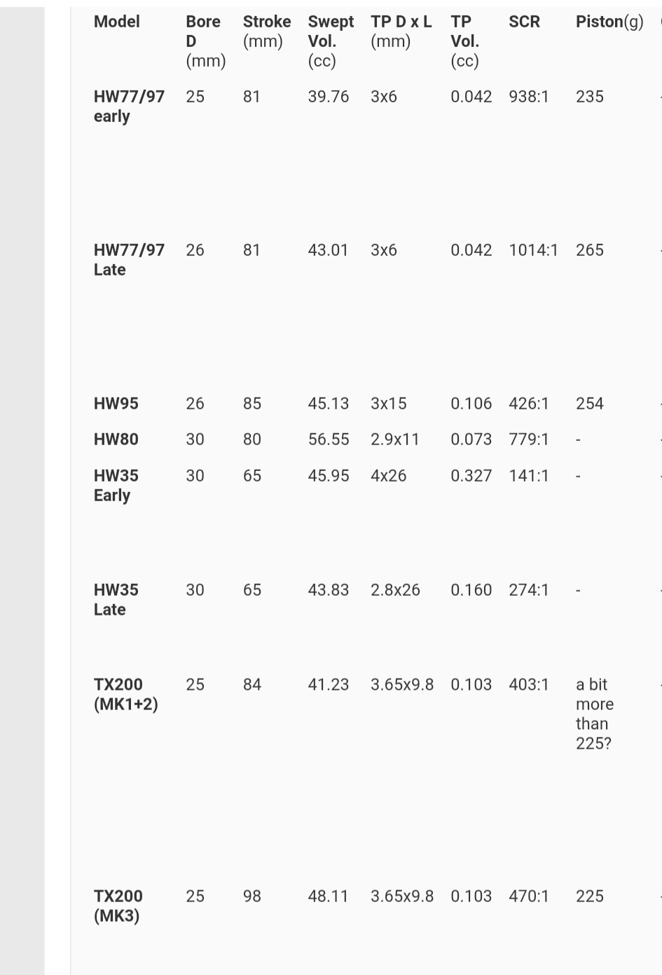

Here you go, with a few extra details (TP volume and static compression ratio) so you can get an even better idea.
Note the HW80 and 35, it's often said the 35 is just a baby 80 but it's not just the swept volume that as reworked....
This may help.
Pellet Rifle Swept Volume formula:
Rifle bore radius squared x Pi (3.14159) x piston stroke = cubed mm. Convert to cubed centimeter by moving decimal point 3 positions left.
Example:
HW95L .22 caliber 26 mm Bore radius = 13 squared (1/2 diameter) = 169 mm x Pi (3.14159) = 530.929 x HW95L Stroke 85 = 45,128.9 mm cubed. Convert to CC (cubic centimeter) = 45.128 or 45.13 CC for Swept Volume.

I'm always curious about bore and strokes on my Weihrauchs. It gives me an idea of power and build potential. I recently measured a few. These statistics can be hard to find on the net, so I figured I'd post them here for orhers to reference. These are approximates. Probably within 1mm.
25mm bores
Beeman R7/Hw30 -60mm
Beeman R8 -65mm
26mm bores
Hw50/99 -70mm
Hw77/97 (IIRC) - 81mm
Hw95 85mm
30mm bore
Hw80/R1 -80mm
Feel free to correct me or add to the list. I feel this is important information and should be correct and complete.
Be well all
Ron
