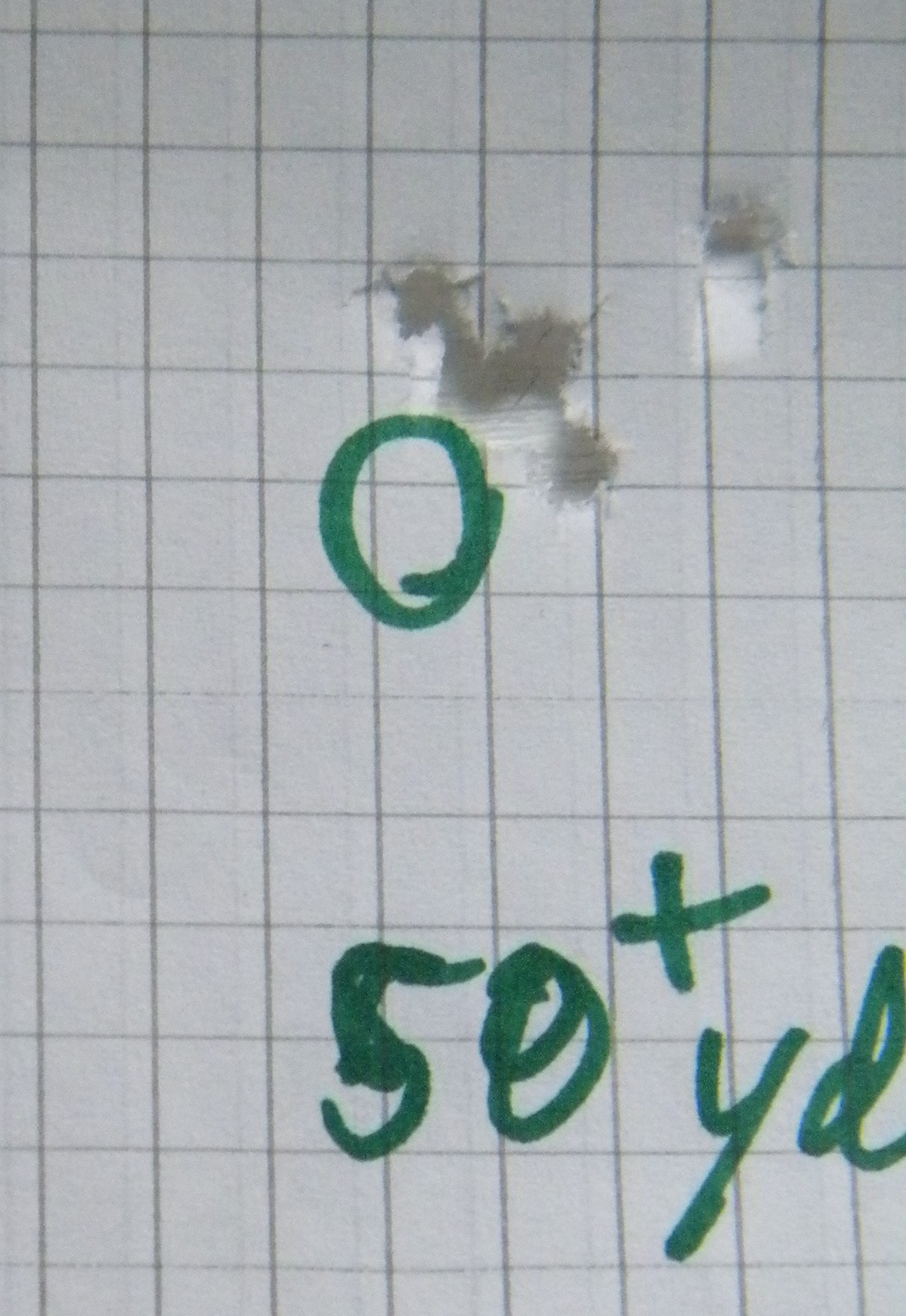

I do especially when first testing pellets, scopes, tunes, etc. After, if it's one of my FT rifles I go to shooting off sticks because that's how I will shoot in competition. There may well be a different impact point going from one type of rest to another but don't buy into you have to put your hand in between the bag and gun and other things. Here is a group from 51.5 yds (laser ranged) with my 97 directly on a front bag, I don't use one at the back. The squares are 1/4''

I do especially when first testing pellets, scopes, tunes, etc. After if it one of my FT rifles I go to shooting off sticks because that's how I will shoot in competition. There may well be a different impact point going from one type of rest to another but don't buy into you have to put your hand in between the bag and gun and other things. Here is a group from 51.5 yds (laser ranged) with my 97 directly on a front bag, I don't use one at the back. The squares are 1/4''

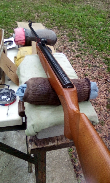

I always have my hand under it, even when shooting off a front bag. That way the gun reacts the same when I’m not shooting off a bag. I have several springers I tested with and POI changes if I shoot straight off the bag. Interesting stuff.
I'm wondering if we've noticed the same thing here. Bagged vs bagged with hand or from straight off hand I've found bagged to always move my POI a few MOA high

High and a little left is what I saw most. Still very consistent though, tight groups. Just POI shift. And I only did it with 4 (I think?) guns. Need to try it some day with the ones that are really hold sensitive. That would be interesting.
