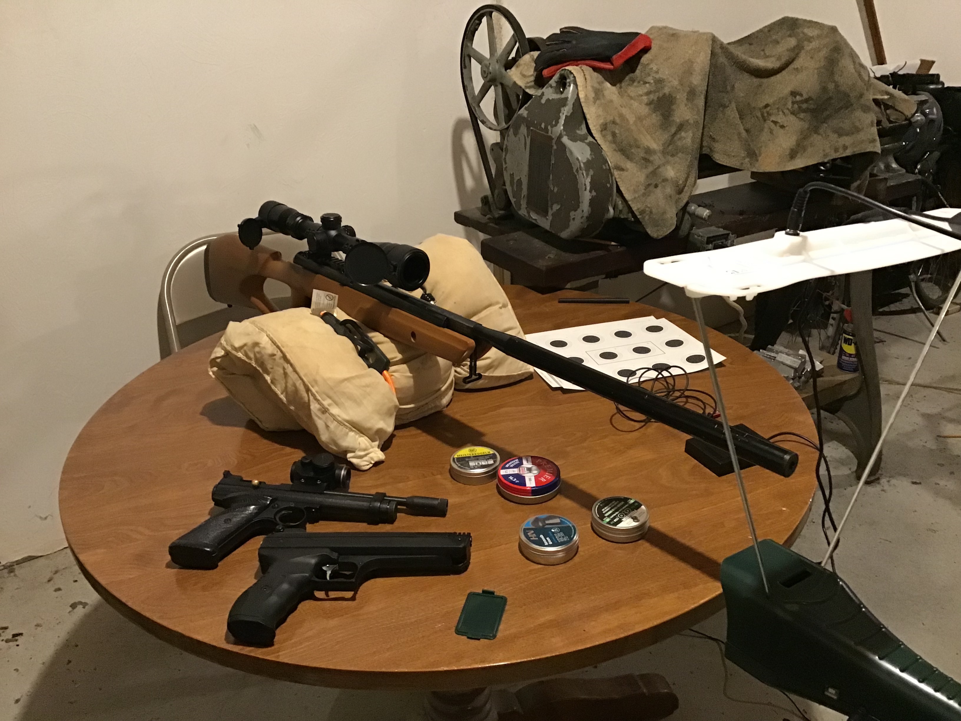

I made 3 the 2 you see in the picture i posted kinda 2 sizes depending on gun used and another indoor for pistol stuff.
Point is you got to find what works best for you and your shooting. Maybe ol stuffed scock or pro series shooting slead lock down cant miss vice thing ..lol. I seen some that all the shooter does is actually just pull the trigger , no shooting skill required ...
