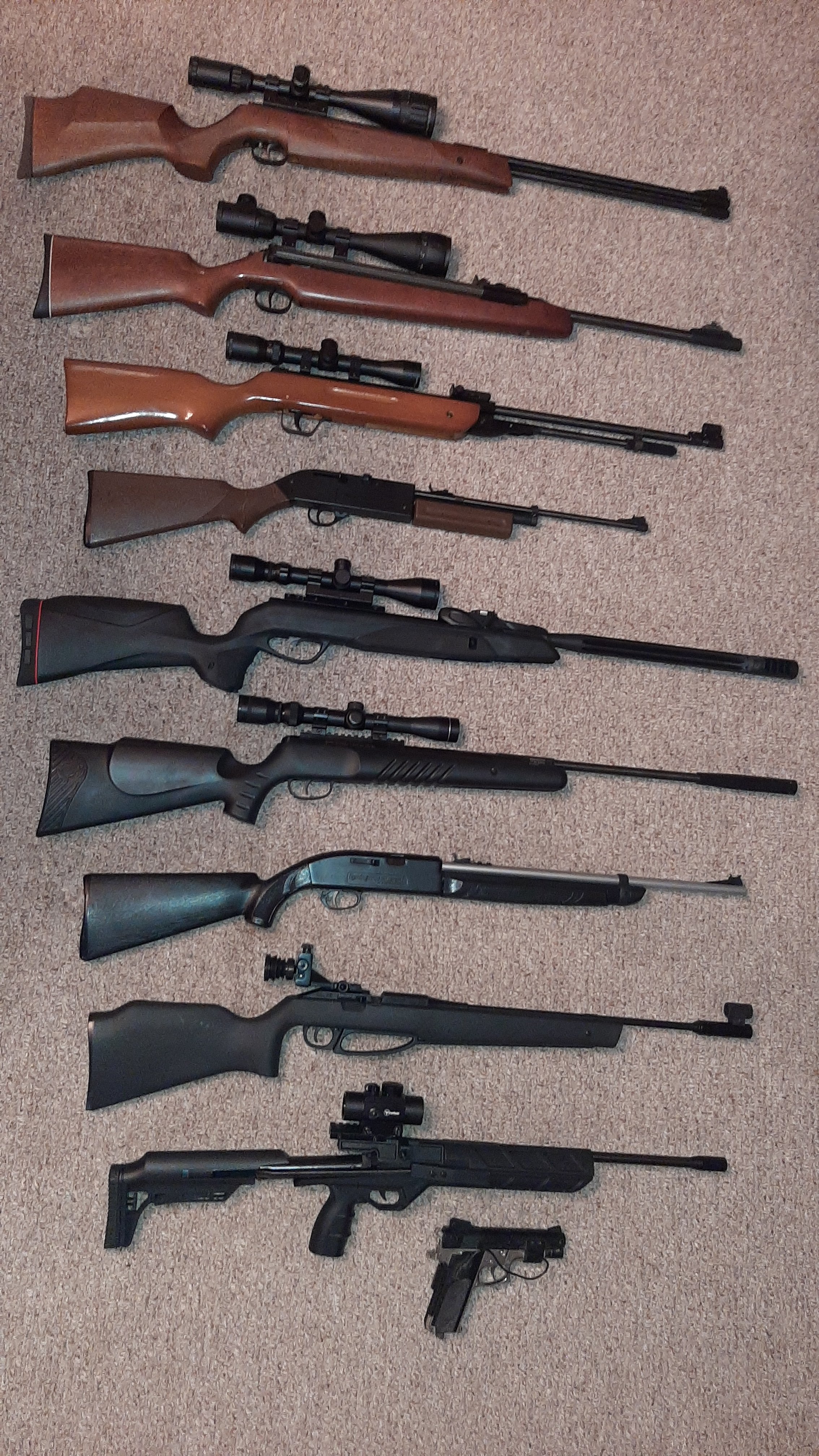

What spring guns do you have? I see what appears to be a 48 and a B3 in your profile banner. The B3 I'm not suprised you can feel the spring but the 48 I am.

HW 77, Diana 48, Air Venturi TR5, Gamo Swam Maxim, B3, Crossman Nitro, and a Gamo CFX with g4 trigger.
Diana 48 has the smoothest spring, surprisingly the HW has a strong buzz.
