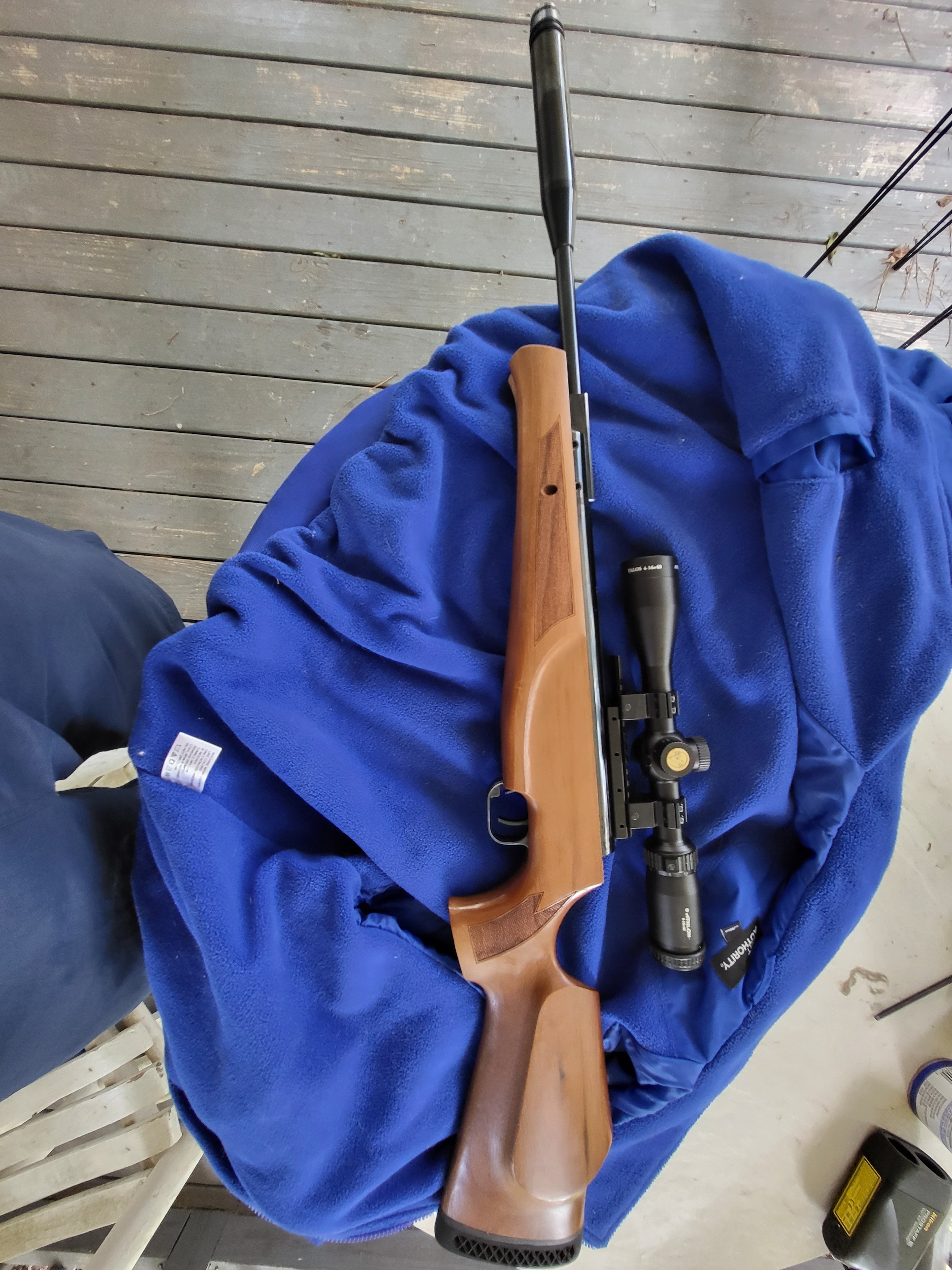

You can run my 1987 Sirocco Deluxe from about 12 to around 23 (never pumped it that high.). Running 17 right now. Not that hold sensitive. This is an early longer stroke ram. Not an HE ram. I shot it offhand quite a bit.
Rings can't slip. They're screwed to the action. No dovetails.
Weighs the same as an R9. The seals have lasted 34 years. Never been serviced. I have another earlier one in .22. I don't know it's history. It's only running 13ft lb for now.
