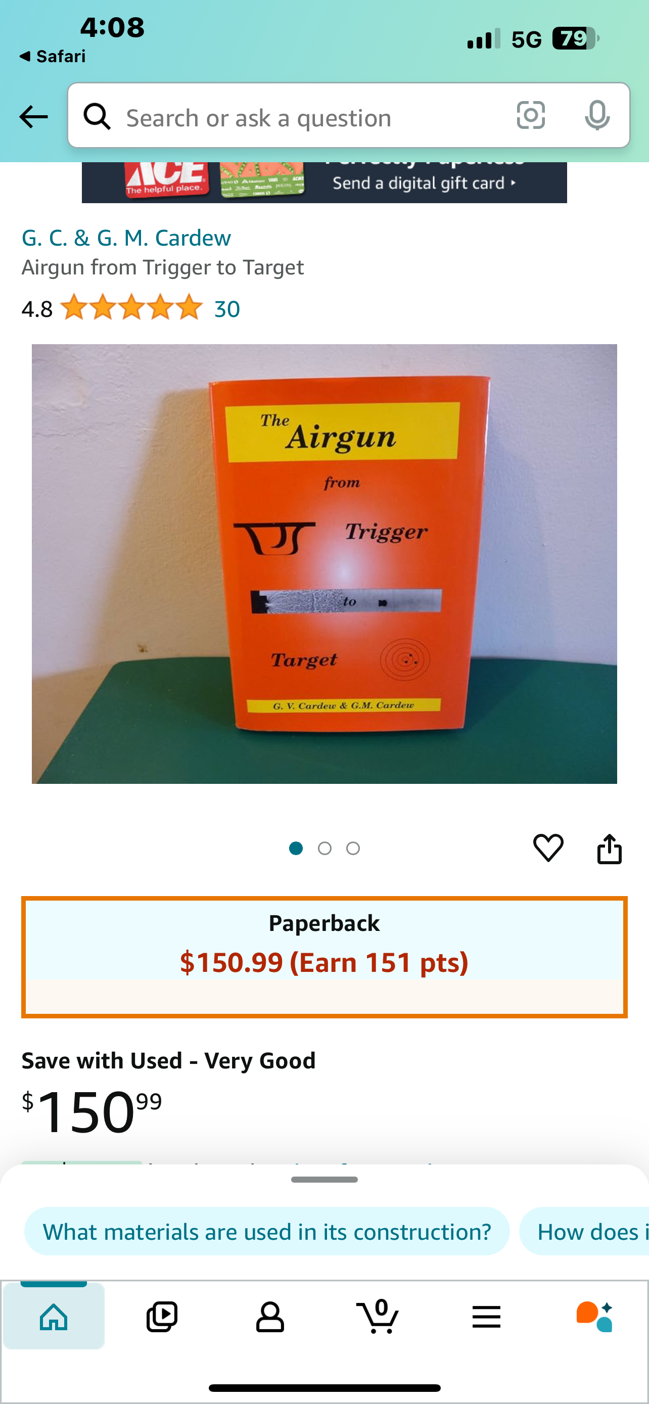

Read "airgun from trigger to target" 1st.

Little pricey lol
To the OP, read Cardews books. Wanting to shoot slugs 1000 ft per second out of a springer is a road to nowhere. If you are going to accomplish this you're not going to shoot the gun very often afterwards because it won't be accurate and it will tear itself apart.
