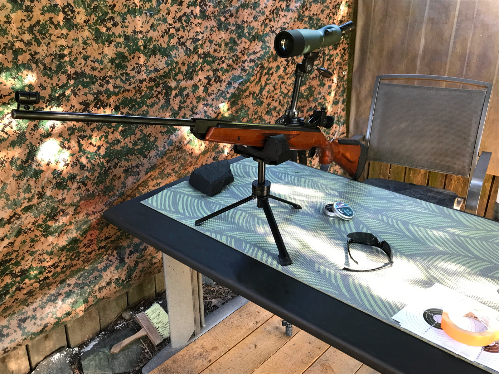

both of those are light shooting guns tho'. how's it hold up on a .22 magnum?
as i'm only 25Y #backyardplinking, i gave up having scopes on most of my guns.
