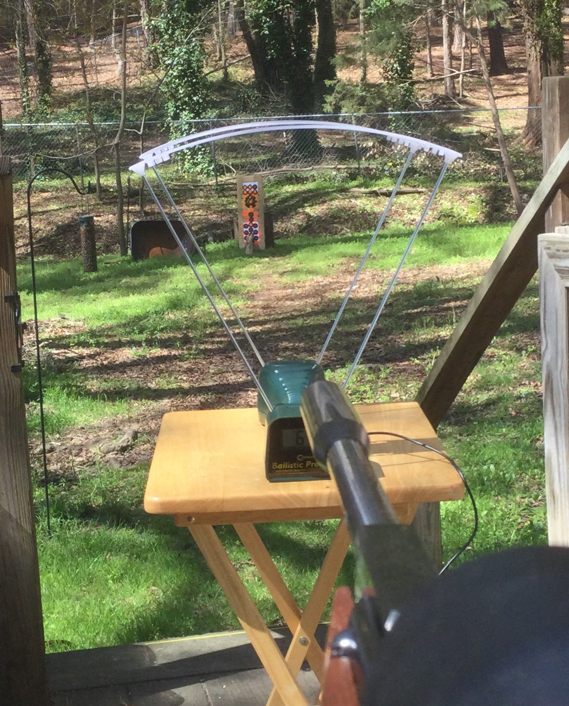

One thing i do is when i order i always get a extra piston seal or 2. Ive knicked them or had poor fits or degrading fps and had to swap to another. Anyway you may not need the extra but if you do need one your glad you have it right on hand .. ya get a crony. Without one your in the dark overall on where things stand
My Caldwell Precession chrono setup on the back deck, Chrono is connected to my iPad which has a Caldwell APP for data collection and storage.
