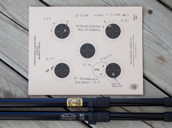

​Now that I have my TX fixed up the way I want it, I thought I would pit it against my Streamline PCP using my favorite field shooting position, sitting with a pair of telescoping Stoney Point shooting sticks. Shooting distance was 50 yards. Wind was fairly steady at about 5 mph from the right, although I did get caught by a sudden reversal of wind direction on the last group. Since I could see that my wind streamer had flipped completely around, I felt justified in excluding that shot and taking one more to make up the group of five.
​The results were more or less as expected, the TX is able to shoot some outstanding groups when you are in the "groove", but just can't compete with the Streamline for consistency, at least not without a lot more practice on my part. I guess that added challenge is what makes shooting springers so much fun! Group sizes were as follows:
​TX200HC, JSB Express 1.51 0.51
​FX Streamline, JSB Exact 15.9 0.65 0.72

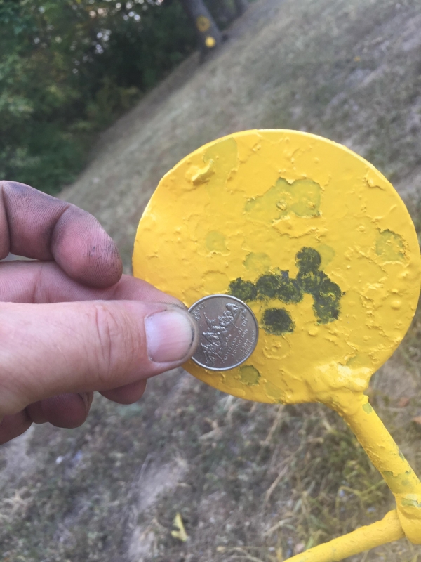

My TX200HC with the Vortek PG2 SHO kit seems to like the H&N FTT pellets best in terms of accuracy. I don't yet have the velocity for those pellets, but based on several other 14g pellets, I expect around 14fpe. Consistent groups of 0.8" at 30 yards with a non-optimal rest. I would guess I could shave another .25" off if I use a solid rest. My rifle doesn't seem to like the JSBs.
