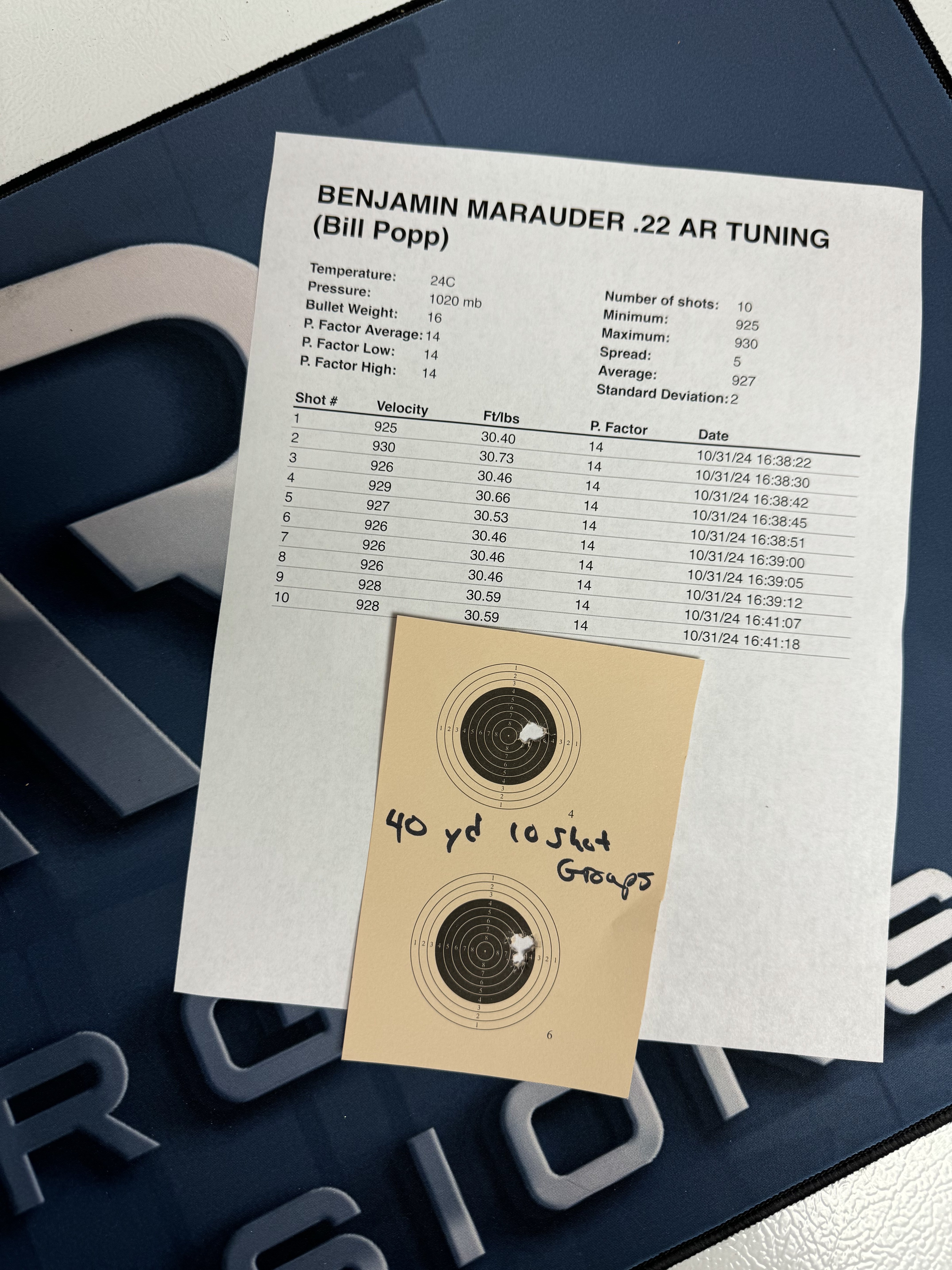

This is a set-it and forget it system. My setup will also tune the valve as well giving the gun regulated consistency. All velocity settings are done with the velocity metering screw. In .22 a factory gun is capable of 16g shooting 930fps. Unmodified. Of corse can be set lower for more shot count.
This is way cheaper and less parts to go bad over an expensive regulated gun that needs machine work to match same performance.
Go to the website and have a read.
Just sent this tuned gun out today for reference. Customer may shoot 18’s as well, reason for the 928 in 16g

So this shot string and groups were shot with an Unregulated gun with just your ssn-hammer kit and no regulator? How many shots (within 2% SD) can a person get with an Unregulated 22 marauder? I just received my LW barrel unit from you and plan to add the ssg in the near future.
