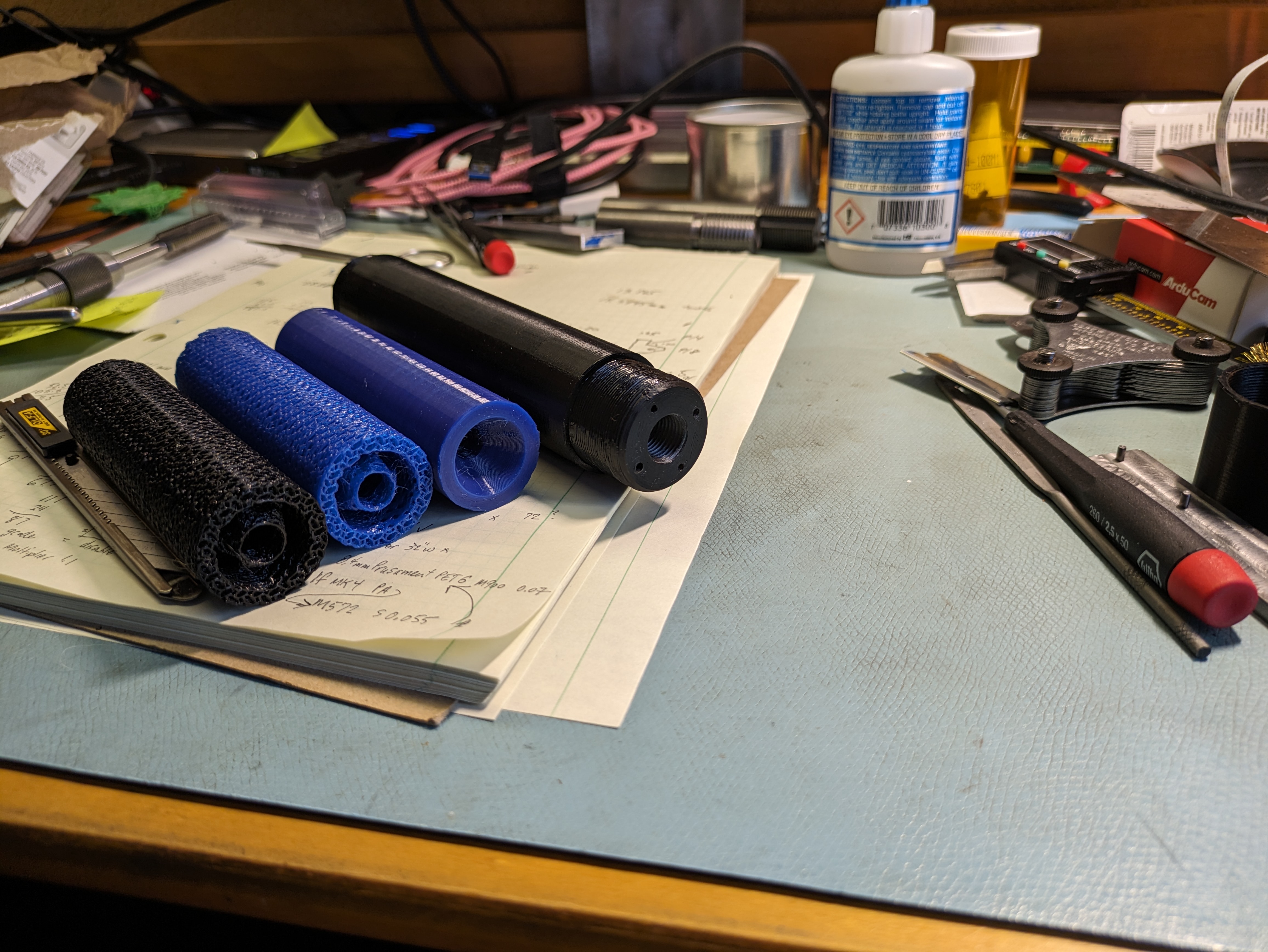

Yesterday, in fact. Didn't use a hex though, used a pin spanner instead for a cleaner look. In fact, @OldSpook this is one of your designs... Gyroid PETG, Gyroid TPU & Solid TPU. But I do like the fact that the threaded sections shown above mate to the flat of the tube for registration, that's better than what I did. FYI boys and girls, those are functional 32 TPI threads on both ends of the tube. You'd probably be better off with coarser ones, but these work if you use silicone oil.

I know you did... An acknowledgement is always appreciated, even if borrowing ideas. Moving right along.

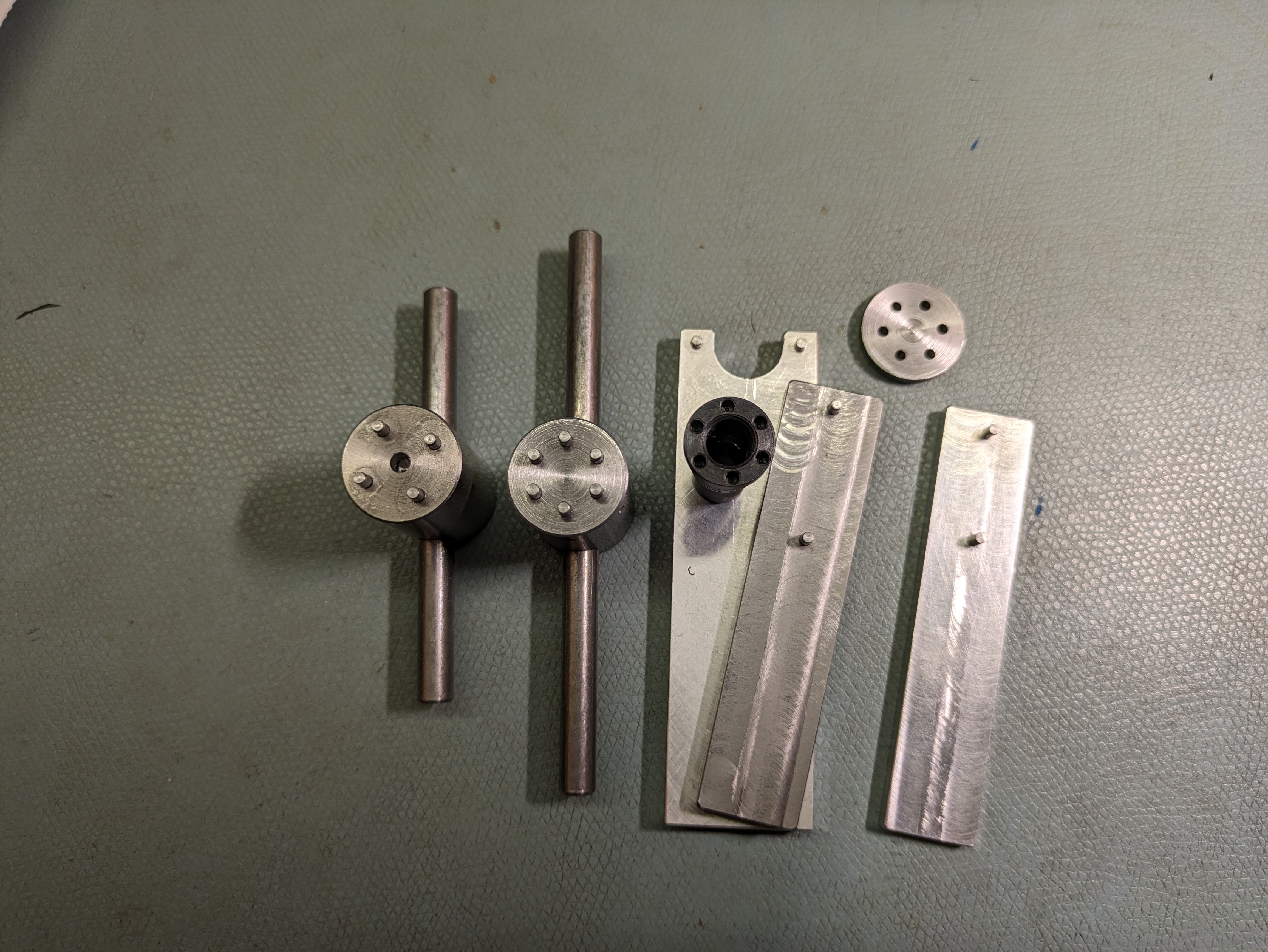

Think you are on the right track with making the threaded piece register to the tube. That gets the flat face perpendicular to the bore. I do think this rig will be good for testing. A pin spanner is more elegant than a big old hex, but I do realize that most can't just make custom ones with an arbor press. I had to make a lot of custom pin spanners to service my PP700SA recently, so using a pin spanner came naturally to me. The PP used an awful lot of them, and I had none. They aren't too hard to make, once you get the sizes right. Finding a 1.95mm drill that didn't drill oversized was the hard part. 2mm pins pressed into a 1.95mm hole.
