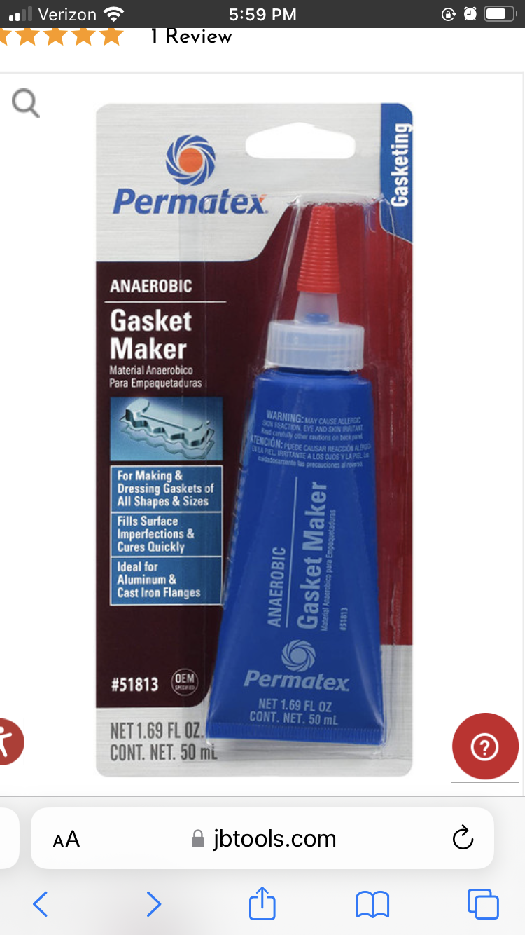

Gerry, when I rebuilt my Hatsan lightning I used this, especially around the water channels-
Your local Napa will have it.
Of course 100% clean and grease free on all areas before applying, and let it fully cure before water gets back in the system.
If rebuilding the piston area with new rings, apply a thin coat of assembly lube like lubriplate on the piston and the inner walls the piston reciprocates in

I was under the impression that the gaskets (most do) have a sealing layer built into them. During heat cycles, this becomes more and more stuck to the surfaces. Once you pull it apart, it normally tears. I did not use any sealer on my gaskets. I've worked on a lot of engines and see the same thing. No sealant used, but the gaskets look the same when you take them off. Usually split/tear
