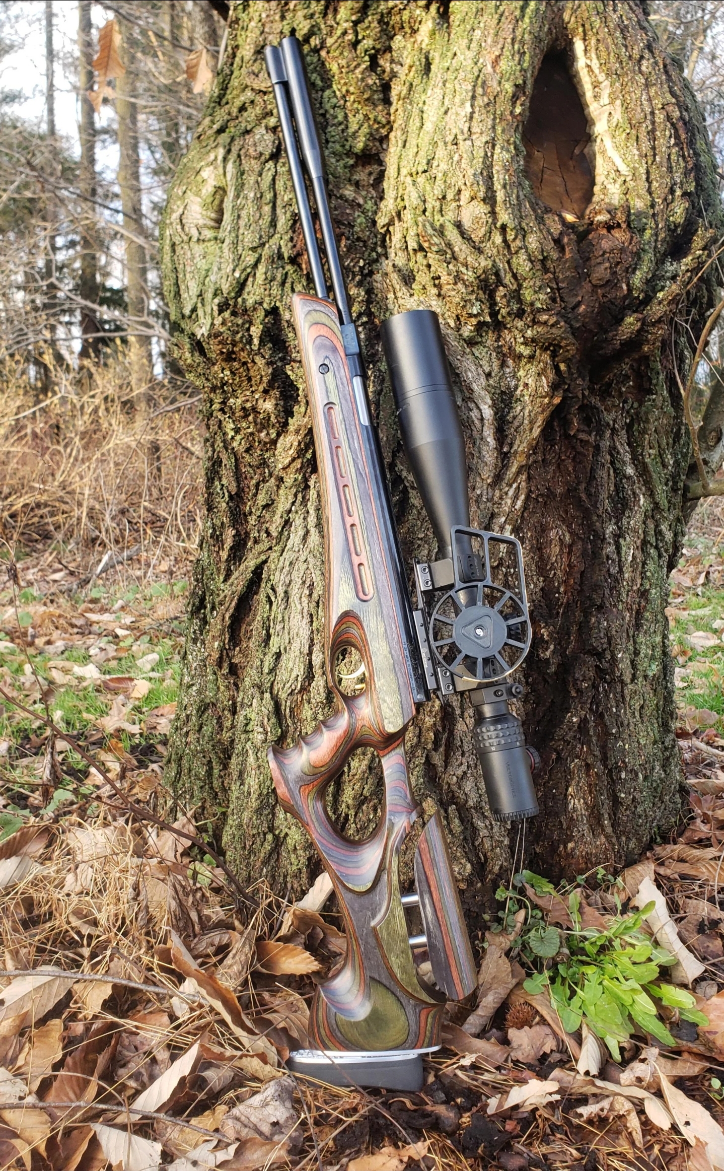

Craftsman Vit stocks give you both as well as an adjustable butt pad. I have one on my 97K and like it a lot.
Another vote for the Craftsman Vit. Pricey, but everything including the shipping is included in the price: adjustable buttpad, adjustable cheek piece,allen wrench to adjust both, longer stock screw you'll need, just pick your color. He may even make you one in wood instead of laminate, but you'd have to email to ask.
My 95 .22 in Ocean Grey Laminate:
