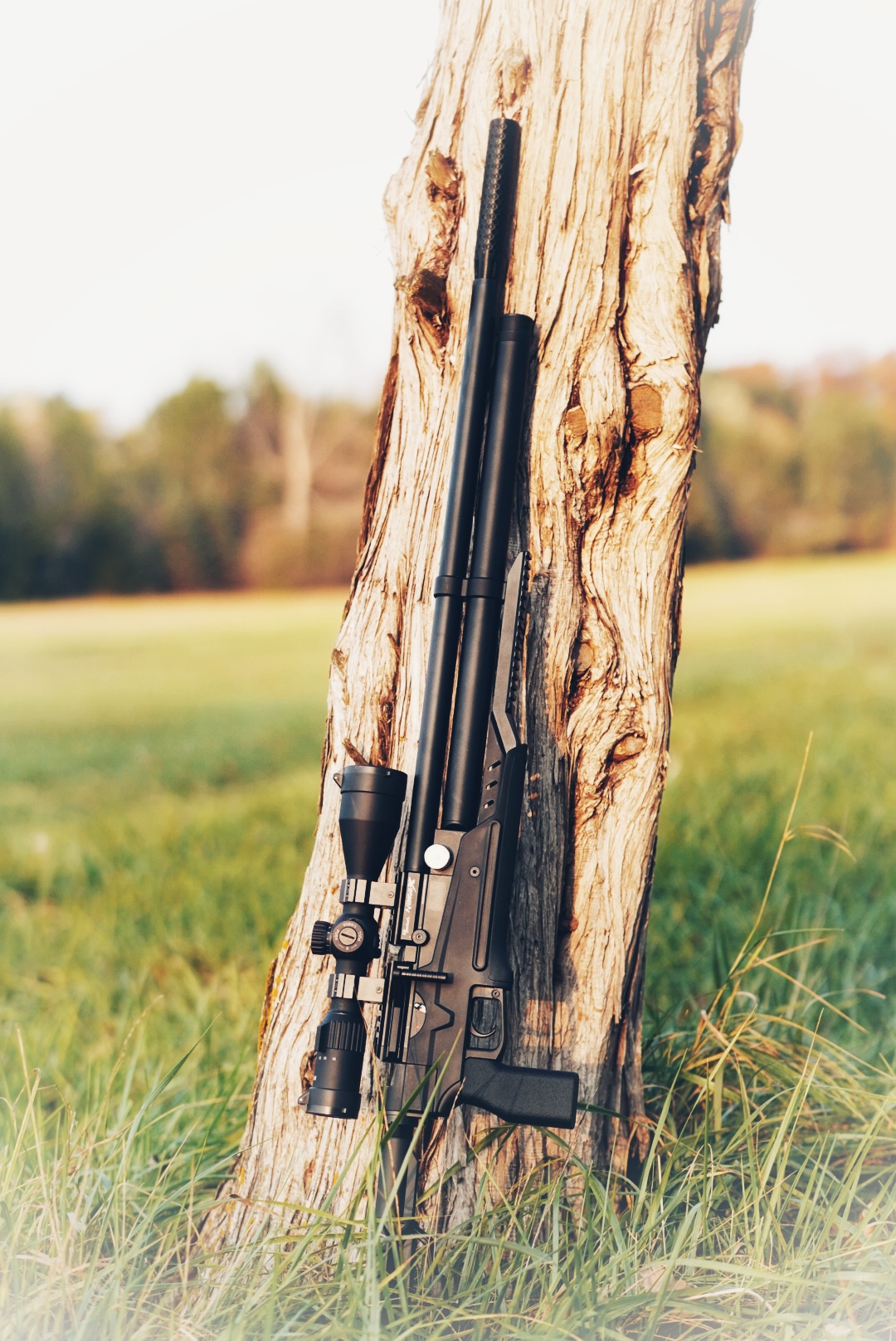

I’m personally partial to the Avenge-X in .25.. I was in the same situation as you and went with the avenge-X tactical. I liked it so much that I Expanded into airgun accessories and have continued to expand into the hobby / sport. They just launched a carbine version that looks pretty nice also but I don’t think it’s in stock yet At PA.
Another vote for the Avenge X as an all around good PCP, very versatile, great value, you can replace different caliber barrel for cheap, lots of parts available, super easy to tune, very accurate and very efficient. You can get the .22 and swap to .25 within minutes, the barrel kit is only $69 so you get to swap back and forth. Many different layout to choose from and swap to, be it traditional wood/synthetic stock or tactical, or bullpup. It isn't just a good "entry level" PCP, it is a great PCP! Accuracy wise I don't think the .25 is more or less accurate than the .22 within 50 yard, but from what I have seen, at long range at 100 yard the .22 may have a slight edge due to a little higher BC, it really depends on the projectile, barrel and many other variables.
