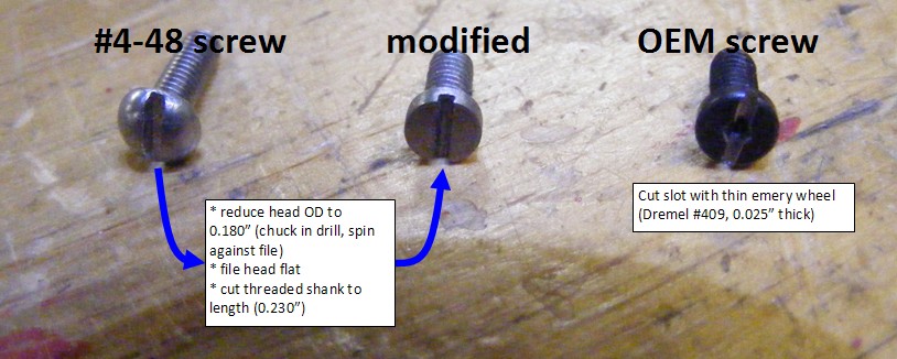

I do the same as Long_Gun_Dallas. Dremel with a thin cutoff wheel to make the slot. Practice on a scrap screw to get the hang of it.
Or buy a slotted screw and modify it.

I asked how to remove the hammer screw without stripping it but everyone seems to be telling me how to manufacture and install a new one.
The screw that I am talking about is the one that inserts upwards into the rear of the handle assembly and secures the round cap that restraints the long hammer spring into the bottom tube.
