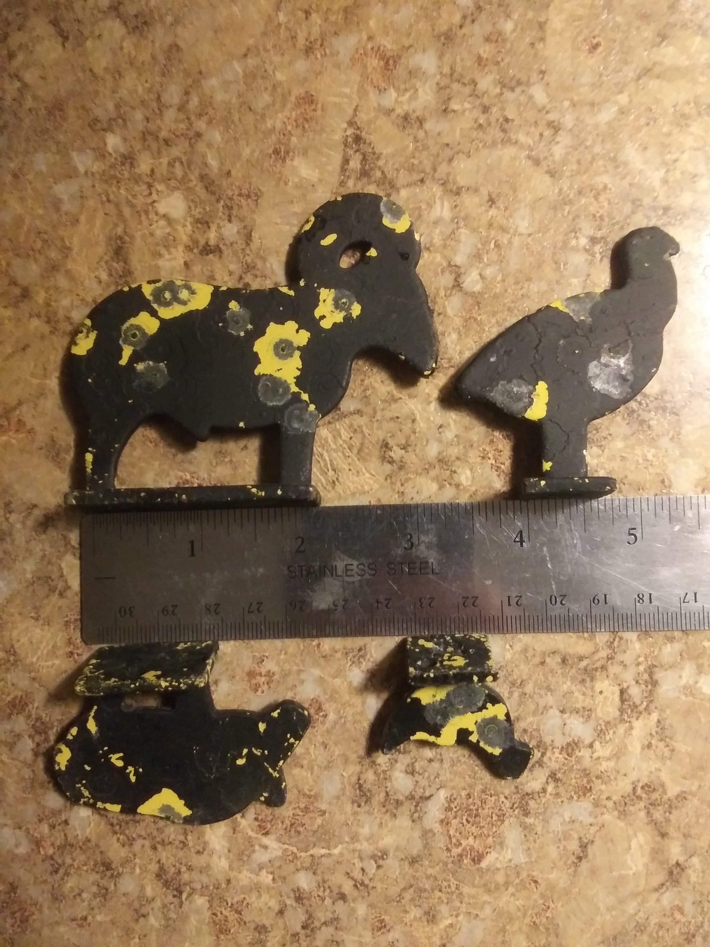

The little shillouettes are standardized. I have 10 sets of each. You could find the specs pretty quick on the internet.
The chickens are at 20. Pigs at 30. Turkeys at 35 and rams at 45.... I think that's the way it goes. The 45 yard ram is a couple inches high and maybe 3 long. The little chickens are pretty much 1" circles. The pigs are probably 1.5 high and 2.25 long. The turkeys are about 1.25 circles with a head and legs.
You can get a set at Wal mart for a pattern. I think they are 10 bucks for a set of four. Easy to make.
The chickens are worthless. You spend more time looking for them than its worth. You bend them and rip them off the base. You blow the paint off them every shot. But the rest of the regulation size shillouettes are a lot of fun. I replaced the chickens with a 410 shotgun shell and it all worked out.
I painted and repaired so much steel I got tired of it. I found kids dinosaurs at the thrift shop. About the same size and bigger for longer distances. They take a licking and keep on ticking. I think they react as well as steel. But the regulation shillouettes are pretty cool. They make a nice sound, go down hard and they are a challenge to hit using regulation rules.
