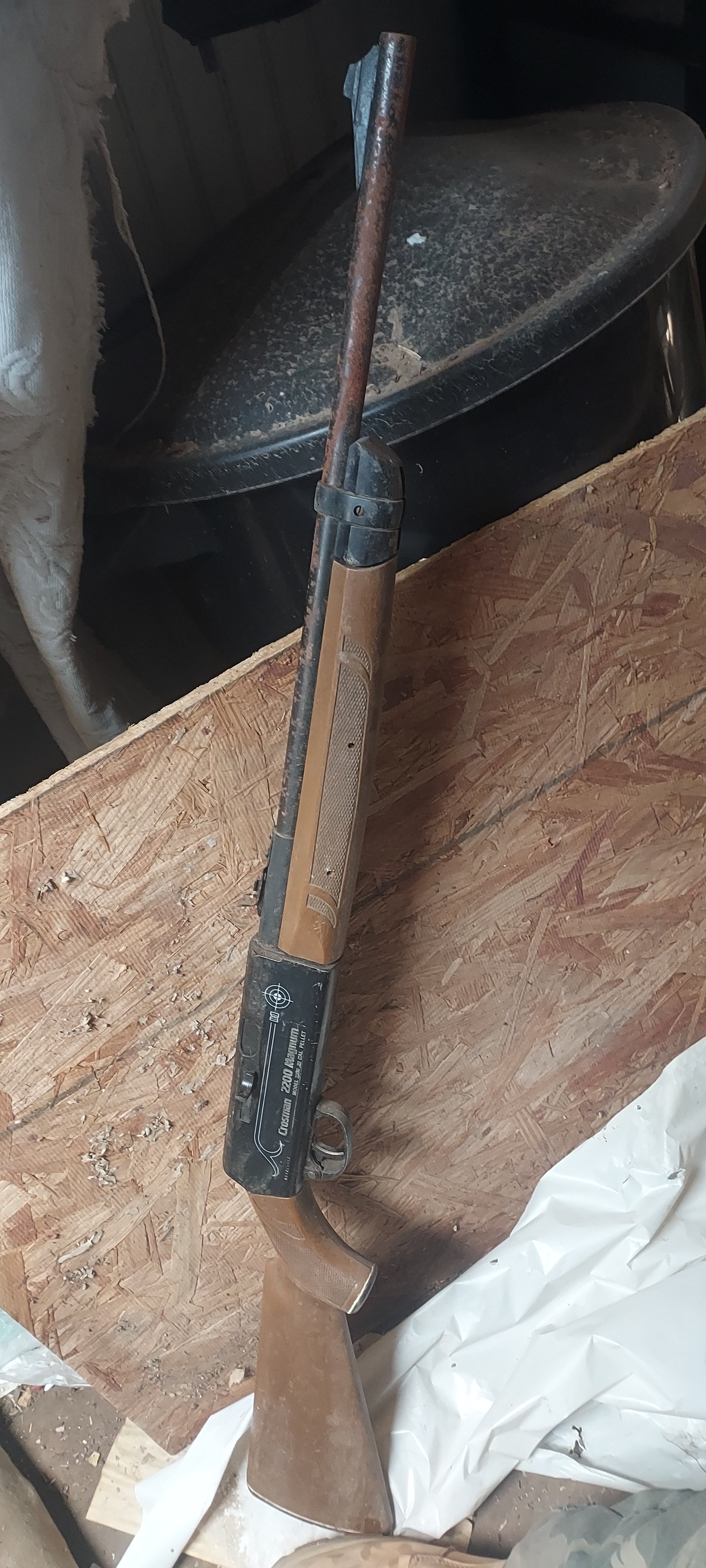

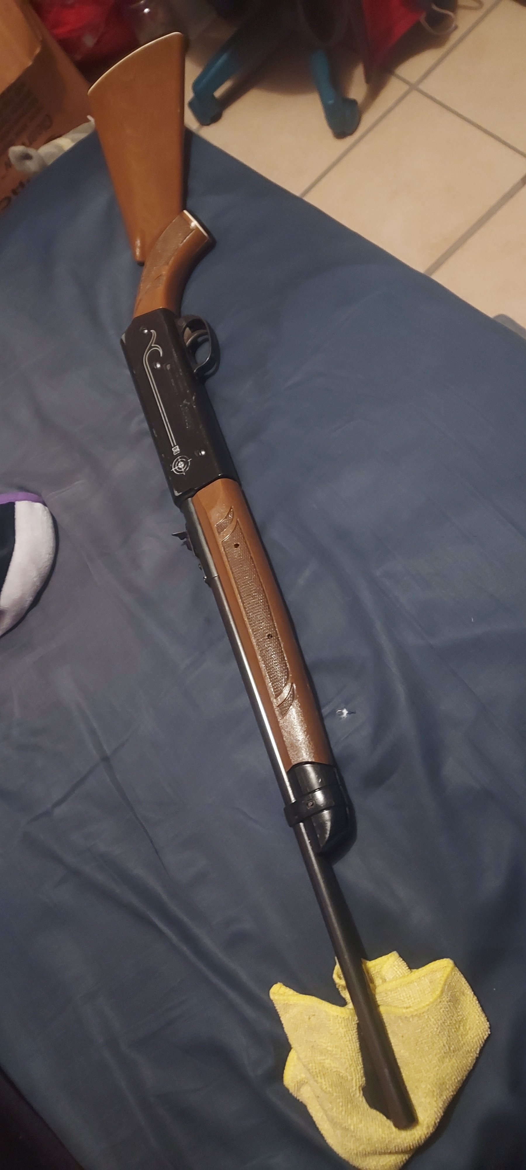

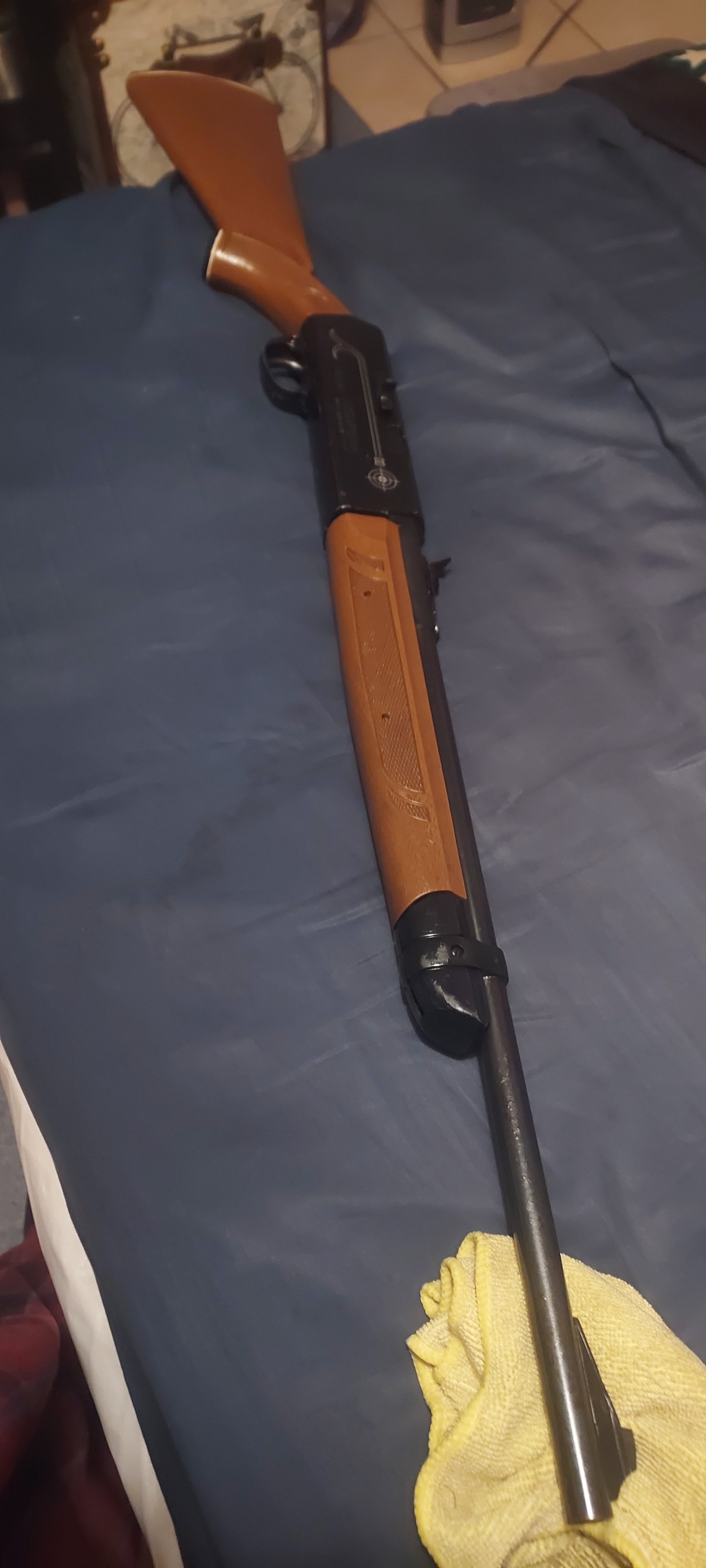

Steel wool: must have for rust removal
Get some! Got 3 big bags of different grits and had at her!!
2.5 hours to remove 25 years of rust*worth every second*
Ooo🤨 the process...?
Frustrating but worth it🤣🤙

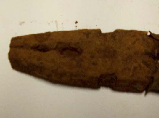

So i started a experment . Found these pliers and figure id soke them for 24 hrs +/- in plain white vinegar ( the best of great value) .. we'll see how well it does . If anything close to useable call it a success.. ( soak time started at 11am)

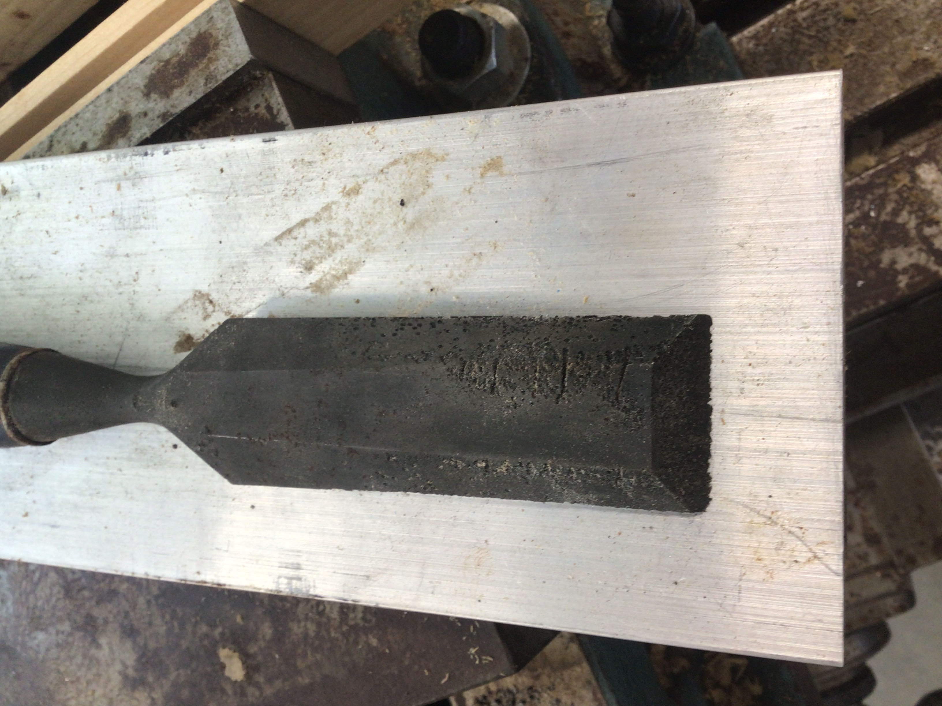

Not necessarily…the vinegar works on everything…like an old chisel for example, that has different hardness steels not evenly distributed thru out the blade….the pitting will occur where the less noble areas occur. Example of a chisel I stuck in a can with vinegar and forgot about for a few days…

There is a stronger cleaning vinegar but, i still have to suspect poor steel porosity / rust penetration for plain white vinegar to scar like that..
Then what do i know in the end..

Heck as bad rusted them pliers are i may find nothing left but the rubber handles in the glass..lol
