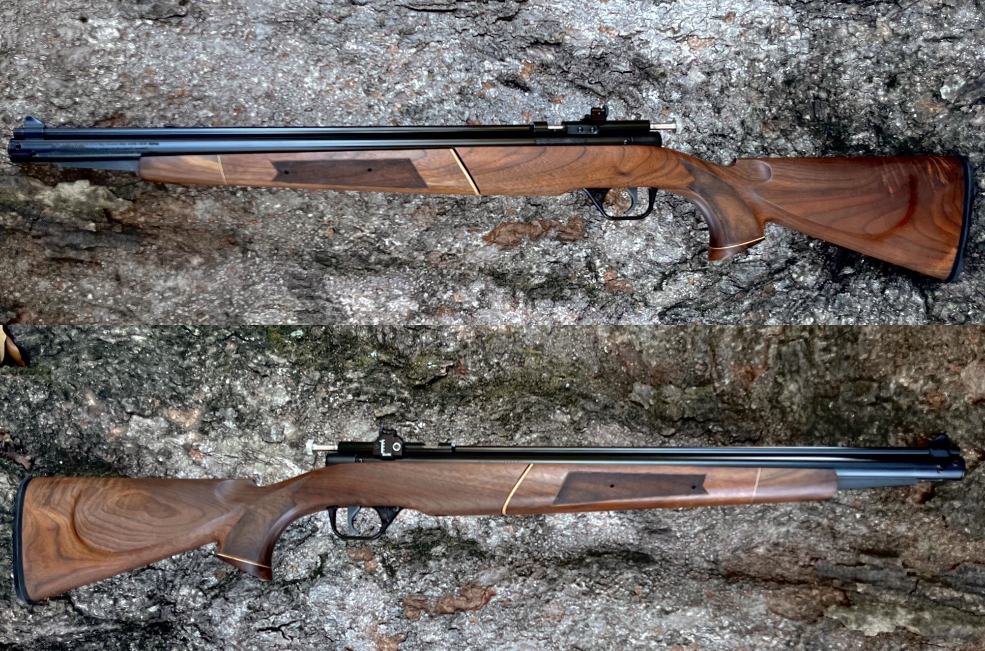

Thank you. I didn’t build it however. Someone made this special rifle and I am blessed to be the next caretaker. It’s a Steve Corcoran stock.
Of course. That makes sense it's a Corcoran... every time I see his work I drool.

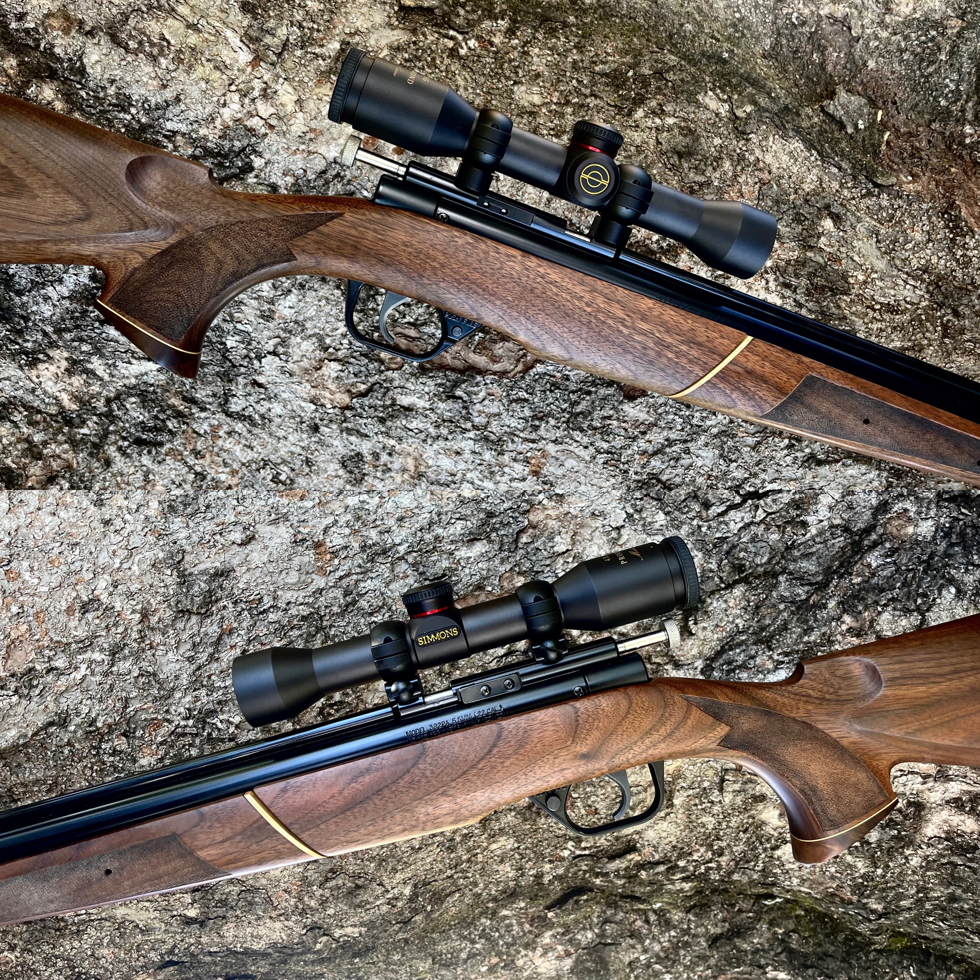

Talking here on AGN is a good thing. A couple days ago a member here reminded me of something that I have totally overlooked and forgotten. Funny how this happens. He mentioned the scope grooves on my custom steroid. Asked if it had them. Wow. I totally forgot this. So yesterday I dug around in my extra scope department and came up with this 4x32 Simmons Shotgun scope. The parallax is set to 50 yards for a shotgun scope if memory serves. Which clearly it doesn’t. Anyway, this Simmons can be manually adjusted through the front objective lens with a tool I made. Moves freely back and forth. Also has extra eye relief. The scope fit the 392 perfectly. Easy to cock, pump and load. It’s a very light weight scope also. Shot it in this morning at 40 yards using CPHP‘s. Five pumps and it’s sending them around 625 fps with very good accuracy. Thank you rokonman.View attachment 548220View attachment 548221
This is a beautiful pumper —- holding it and shooting it only impresses you more!
