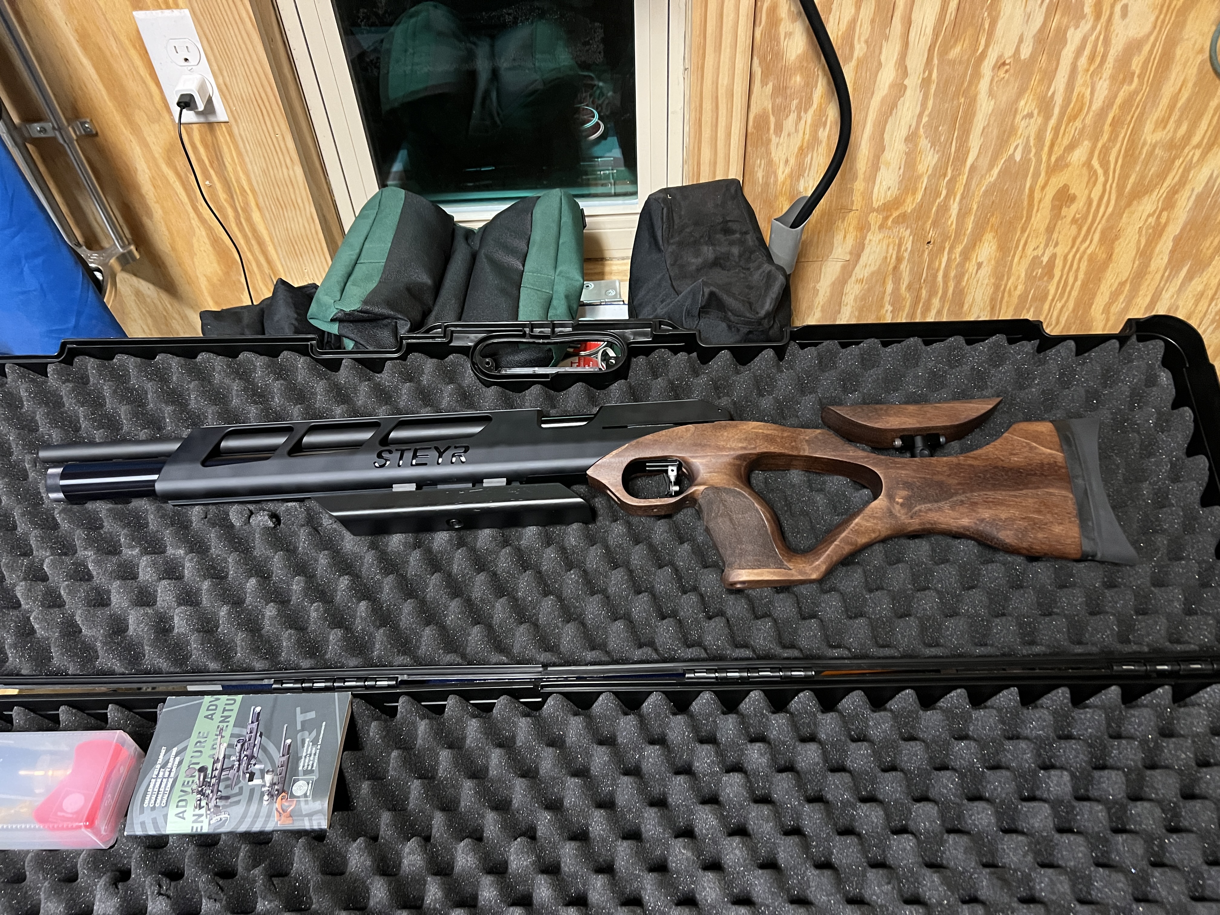

I ordered this on 17 Nov 22 and it finally arrived - totally stoked with the quality!! I’m curious if my Steyr hunting 5sa airtube is the same?

I swapped air tubes out this morning for a "same length" version that uses a fill probe and manometer at the end - aka fill probe with QD fitting ! mucho more nice than having to pull the air tube to refill or swap air tubes to recharge.
I also added a very nice 16.1 mm threaded adapter to the end of the barrel to accept the 1/2 unf moderator(s). Pretty tight fit... choices via Rowan are 16.1 mm or 16 mm for barrel dia. To me the barel was more like 16.15 mm. Best fittings offers a 16.2 but it slightly loose and only uses 2 grub screws.

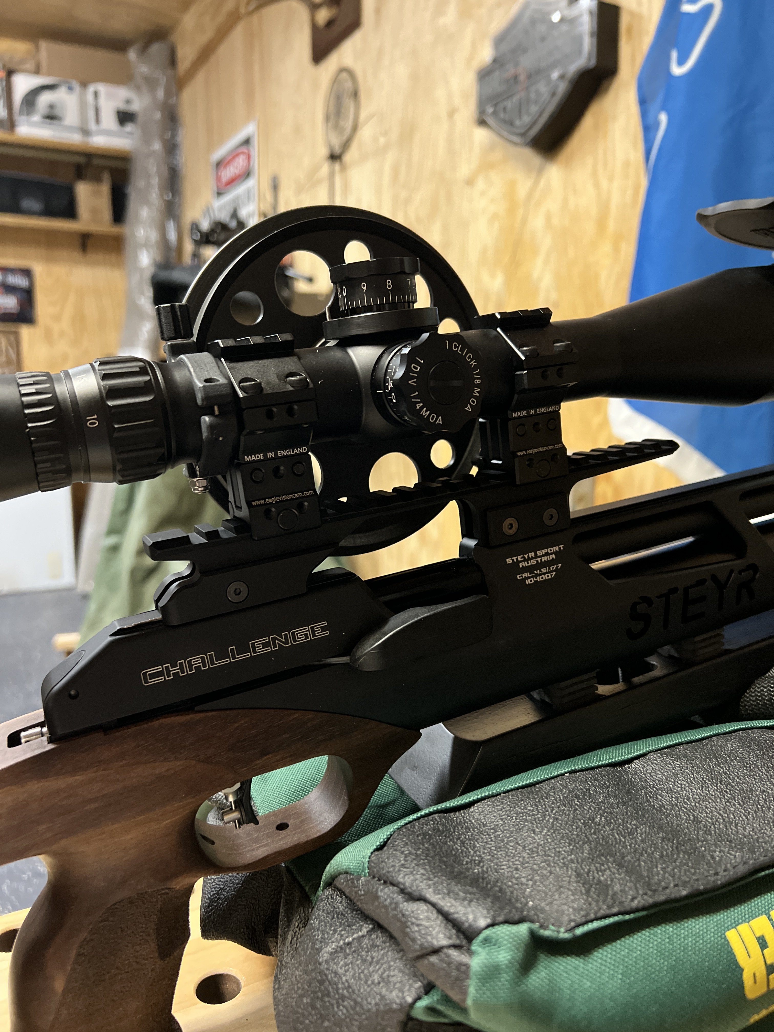

Gonna Scope her this afternoon with a March I picked up here on the forum.
Reactions: Haganaga
Tomorrow she will be sighted in and a dope chart created and my wheel marked. Who will win my heart on the HFT circuit? The Steyr, the Redwolf, the Crown, a BSA Goldstar SE, a FX Dreamline in FT chassis??? A lot of guns might shoot ok from the bench.... or sticks ... but what happens on a knee or when standing will sure make a difference. Money doesn't always guarantee the big score... practice does.
