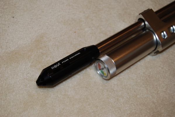

The poopty thing is that the Steyr air stripper is mounted on the outer diameter of the barrel, and the fact that a barrel bore can be off center quite a bit.
If that is the case, you're not shooting though the center of the hole in the stripper, and the airflow behind the pellet is not symmetrical anymore.
If the gun shoots fine without stripper, I'd leave it as is, or add a mini silencer like Tom said. (If allowed where you live of course)
Be aware that the already heavy bark of a Steyr will be even louder if you add an air stripper.

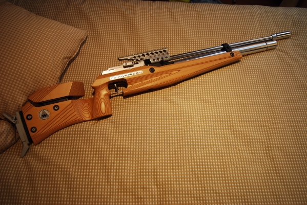

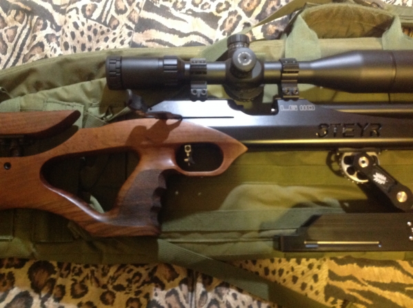

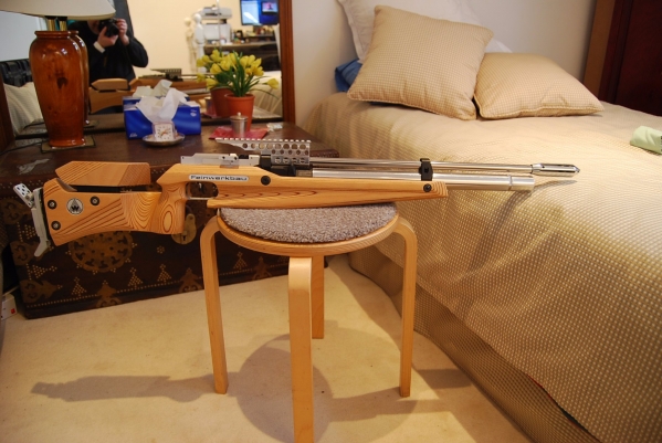

Sorry I'm a little late with the pictures, I've been a little bussy
here they are
the scope on this rifle, is a Hawke Sidewinder 4 - 16 x 50
In Canada I shoot Hunter Field Target with this beast of an air rifle

These fotos do not do the rifle justice

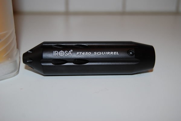

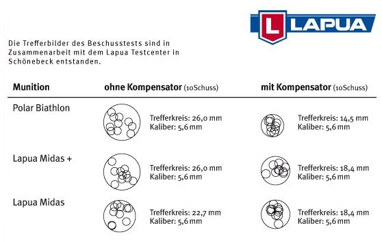

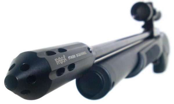

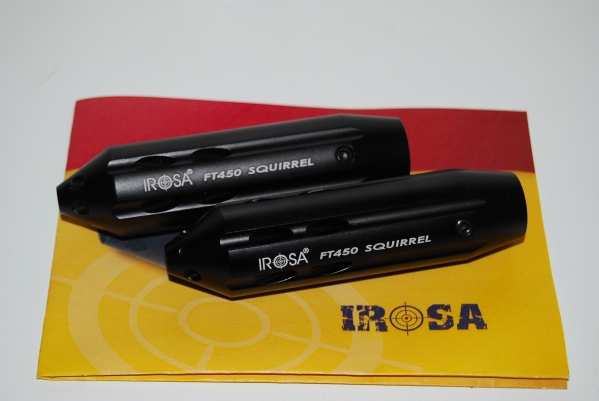

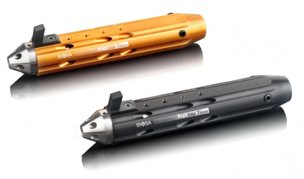

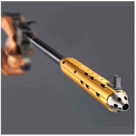

This is NOT a silencer ; in Germany they call it a 'compensator' (air stripper) .... made in Germany... tested with rimfire bullets which apparently get the groupings down...as per 2nd picture onleft - without, and then groupings on the right, with the IROSA compensator
Air rifle > Kompensator Fieldtarget[/QUOTE]http://www.irosa.de/irosa-profiline/kompensator-fieldtarget/embed/

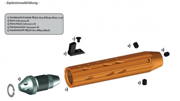

TECHNICAL DETAILS:
  • Caliber: 4.5 mm / .177
  • Total length: 100 mm
  • Length before the mouth: 75 mm
  • Weight: 87.6 g
  • Diameter: 26 mm
  • Running diameter: 16 mm,
  • with reducing sleeve 14 and 15 mm (The barrels must have a cylindrical shape at least 25 mm from the mouth backwards)
  • Material: aluminum
Do not fall for the LDC will do the same as an air stripper. It "could" do the same thing with a LOT more design work and testing but 99% of the LDC units will not achieve less flip.
It may be each rifle would benefit from a slightly different stripper ( if needed) and if using a mass produced unit it needs to be very adjustable , like the above pictures tho I've no experience with that brand.
John
yea im sure those 12 fpe brittish air guns are hard to control....muzzle flip all over the place.
That said the Lapuas biathlon is my Anschutz favourite ammo. and thats a lot tighter of a grouping. I dont think me buying one and randomly mounting one would net me the same results. Biathlon is a bit louder than normal match ammo and i rather keep my silencer on for it.
