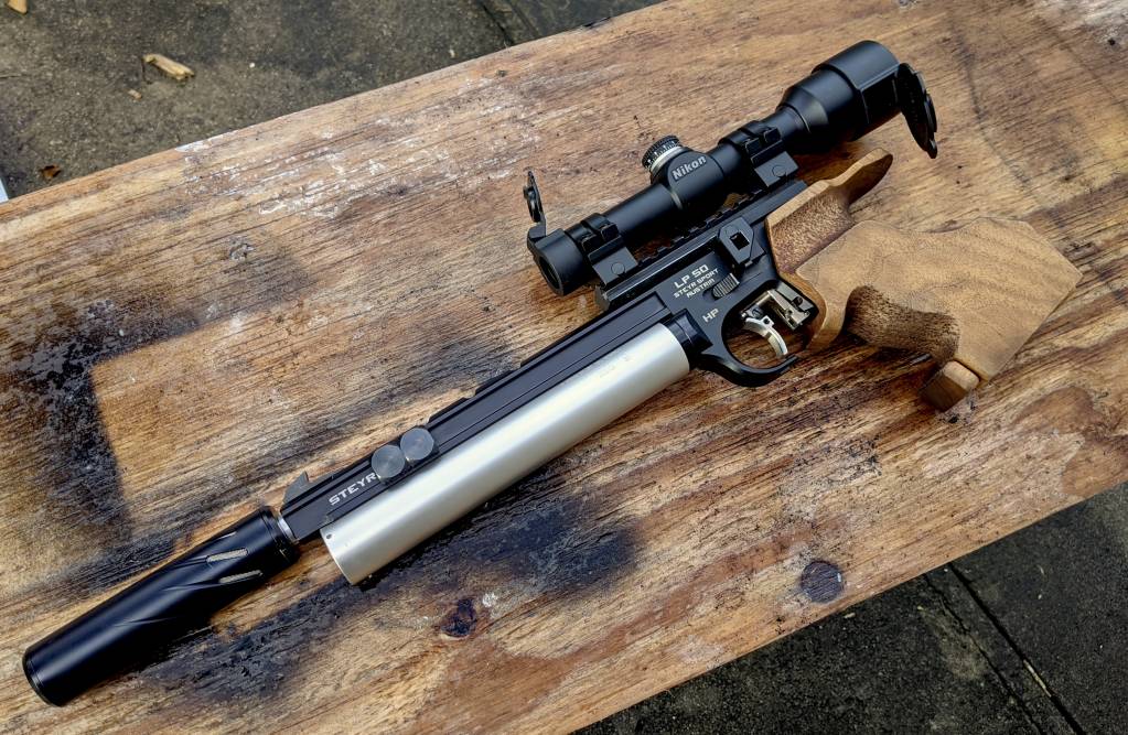

I agree with Gwelo, the Steyr LPS is a great pistol. I bought a used one and had AZ tune it up in power and put on one of his shrouds. It’s shooting at 720 using the JSB 10.34 heavy, for about 25 shots. The grip is very comfortable and not bulky. Before the shroud it was definitely not backyard friendly, a very loud pop that turned heads. Incredible accuracy with the pistol too.
Hi Dave! Glad to see you are a member here. The LP S in my picture above is the one you now own! Would love to see pics of what it looks like now that AZ has worked his magic on it. Cheers!
Nick
Hey Nick, the pistol is fantastic. I just sent it back to AZ because he’s making a part for another one and needed to actually see the part in order to be able to copy it. But as soon as I get it back I’ll post pictures of it, and groups too. With his shroud that loud pop is now completely gone. And the extra zip makes it a 40 yard bench pistol! And best of all the same accuracy as when it was the 10 meter gun.

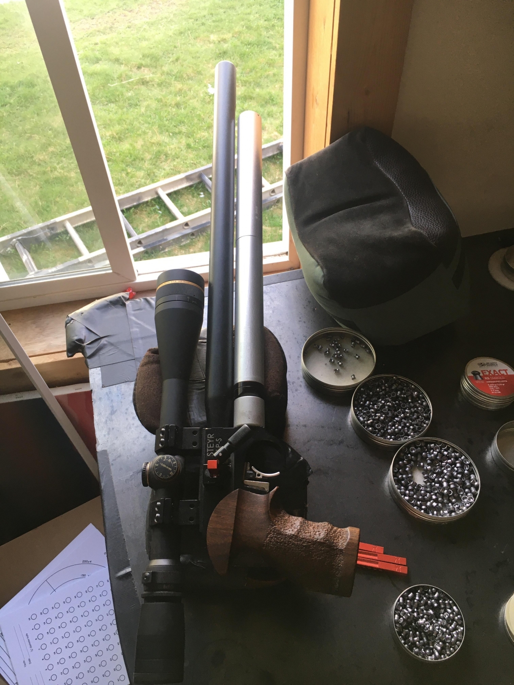

I was just taking to Allen about a problem with the cycling of the stick magazine. When it was stock it had no problem ever with cycling. Then after AZ did the work l noticed a slight difference in the way it cycled, it still worked fine but it had a bit of hesitation as you worked the cocking lever. Finally after many tins of pellets it started to stick at the hesitation point and you would have to help it through the cycle manually. Allen walked me through the barrel adjustment and it made more room for the stick magazine to glide all the way through the five shots. He explained to me that there was going to be a bigger puff of air coming out by the magazine because of the looser fit. It works great again and I don’t notice that much difference in the puff of air. The magazine snugs up against a o ring and that’s a problem spot if you try to change this type of pistol. AZ said a better choice for a super quiet long range pistol is the single shot because there’s no magazine moving and all the air goes out the muzzle. I still love the gun though, and I’ll post pictures of it and groups at 35 and 60 yards. I wouldn’t recommend changing this type of pistol though. And I must mention that AZ also joined the two air tubes forming one long tube, that’s the only reason it gets that many shots!

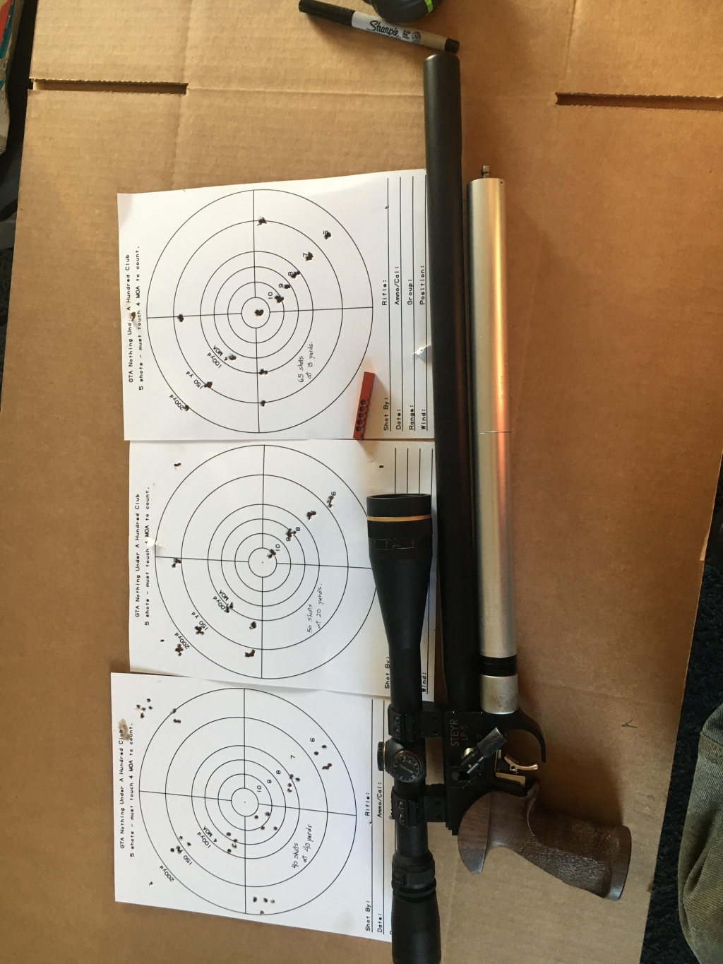

I really like my Steyr LPS custom. It’s got a shroud and it’s really quiet. Here’s some groups I just shot this evening. It’s my favorite pistol by far ( even though it’s a mini rifle without a butt stock!) lol. It loves the JSB 10.34 grain pellet. I really like the 5 shot stick magazine. Shooting was off of bags and bench. A.Z. did the custom work, he joined the two air tubes and made the shroud. I really like this style of grip, it’s not too big and my hand can adjust to it in different positions when shooting off the bags. There’s quite a few different choice’s of grips I think. Including ones that you carve to fit your hand.
