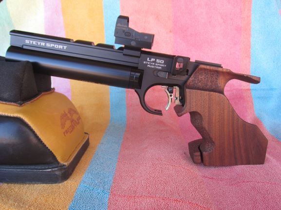

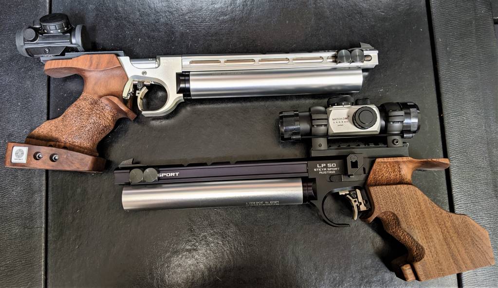

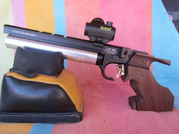

I think the standard version is plenty as long as you get the long barrel rather than the compact. My LP50 (4/2019) came shooting the 7.72 JSB Match pellets at 524 fps avg over a 10 shot string. I use it for 10M target, A/P silhouette out to 20 yards and plinking. It has good knock down power on the rams at 20, no experience with pesting. I mainly shoot with a red dot but have mounted a scope for a bench rest silhouette. I have turned up the velocity to 550 for a 7.0 pellet and never has an issue with cycling. The mount below is capable of mounting either a dot or scope. The EVO 10 shows my mounting of a red dot closer to the shooter than the Steyr barrel mount, which I have also used in the past. With the EVO, the cocking arm has to be accounted for. The Steyr mount also works on the LP50 but limits position to the barrel shroud.
The bottom pics show the Steyr mount. It has only one cross slot so can be used for short tube type (Bushnell TRS-25) and reflex type dots (FastFire III shown). I have used 2 of these for scope mounting.

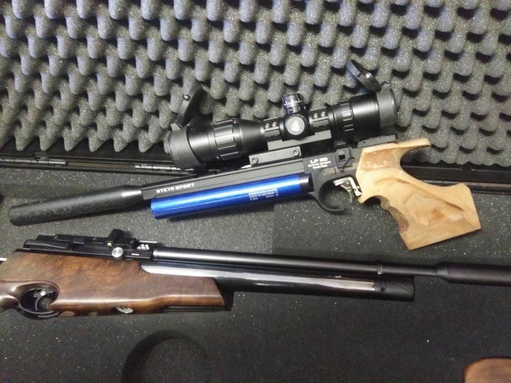

Here is one of mine that had already been hot rodded to shoot 50+ yards that had taken out a lot of birds too many to count up to 60 yards with this one. Dovetails we're machined for scope mount. Dont laugh it's a UTG Leapers Bug Buster with under 5 yard close focus and it's small enough thats why. Putting a custom Shop reticle Leupold EFR 3-9x33 later. Trigger blade grossly canted perfectly to contour my trigger finger for quickest semi auto shooting that's why it looks so weird.

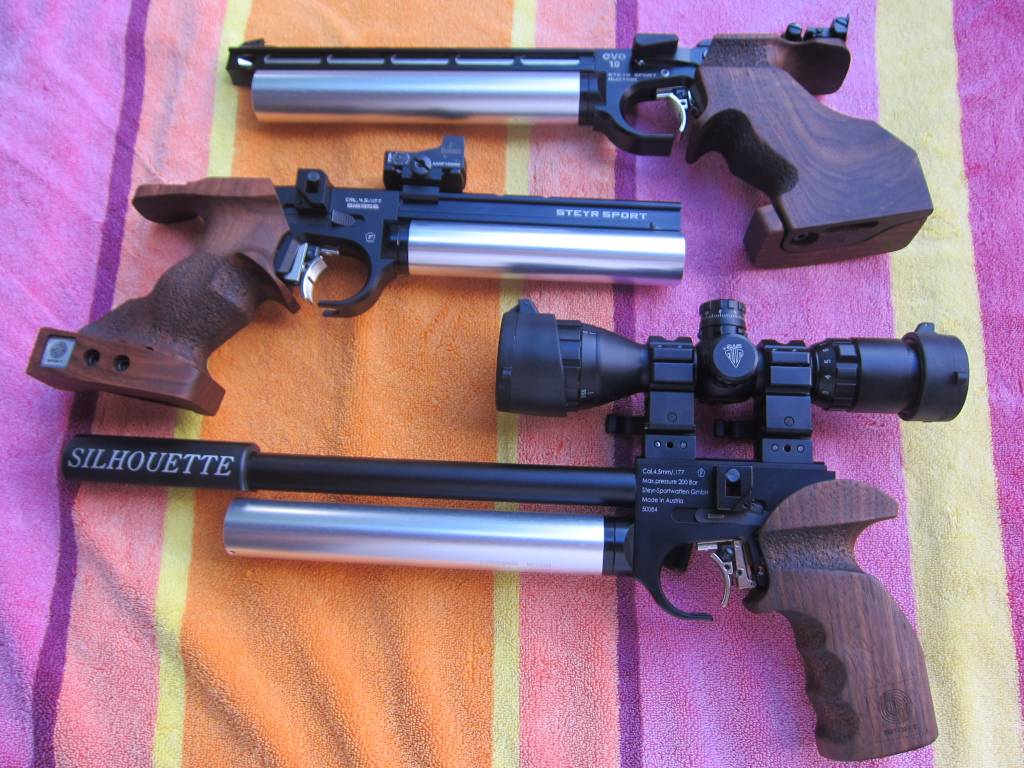

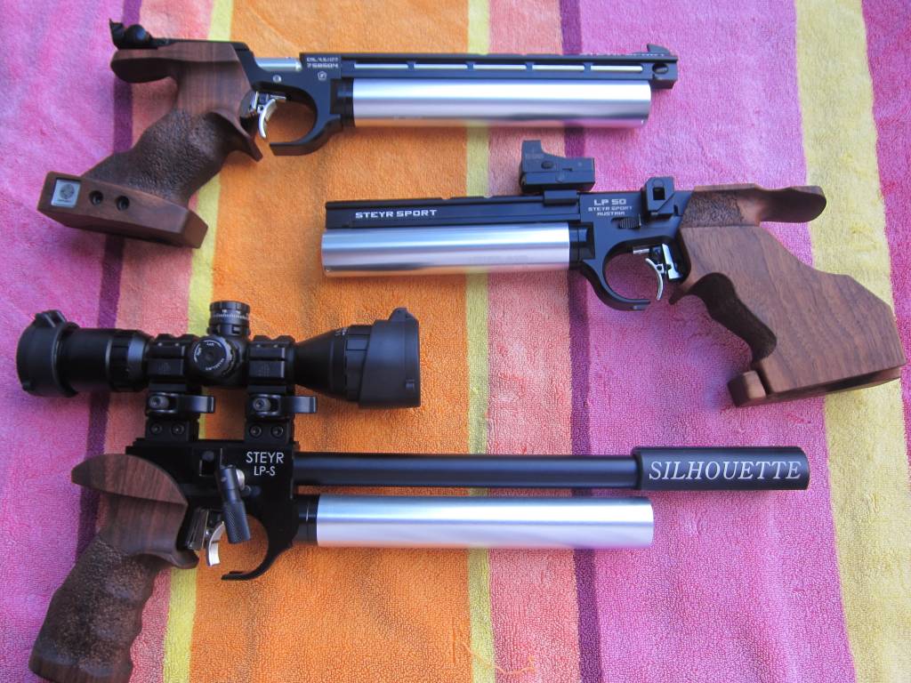

If you want more power, they used to sell a shilouette version
The LP-S Silhouette model was discontinued about 2016. You are correct, they shot the 7g pellet at 600 + fps thru a 10" (IIRC) barrel. They used a 5 shot magazine which was cycled by a side lever. They came with no sights but had a 11mm rail on the action and front barrel weight for mounting the sight/scope of choice. I had one for awhile before regrettably selling it. Luckily it went to forum member davelarson here on AGN. Also the grip was changed to a more upright position (think 1911) from the "standard" 10M target grip that better supported the one handed shooter. The new grip had a much better feel for shooting two handed. They hardly ever come up on the used market, don't think I've ever seen one f/s.
