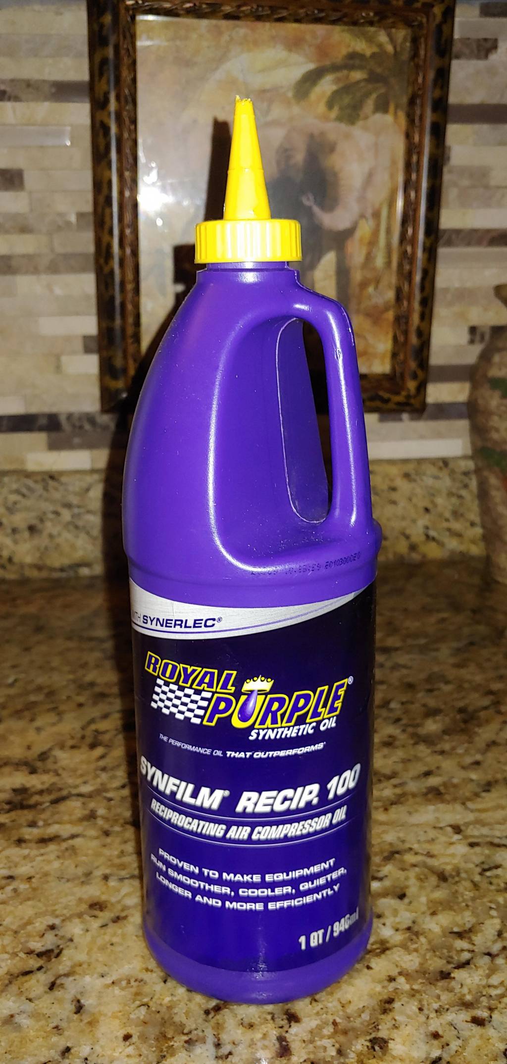

Mine has been going strong for a cpl years what more can I tell ya take care of it “don’t overheat” keep oil changed, I’ve never used a single drop of purple, this is what I and others up here use

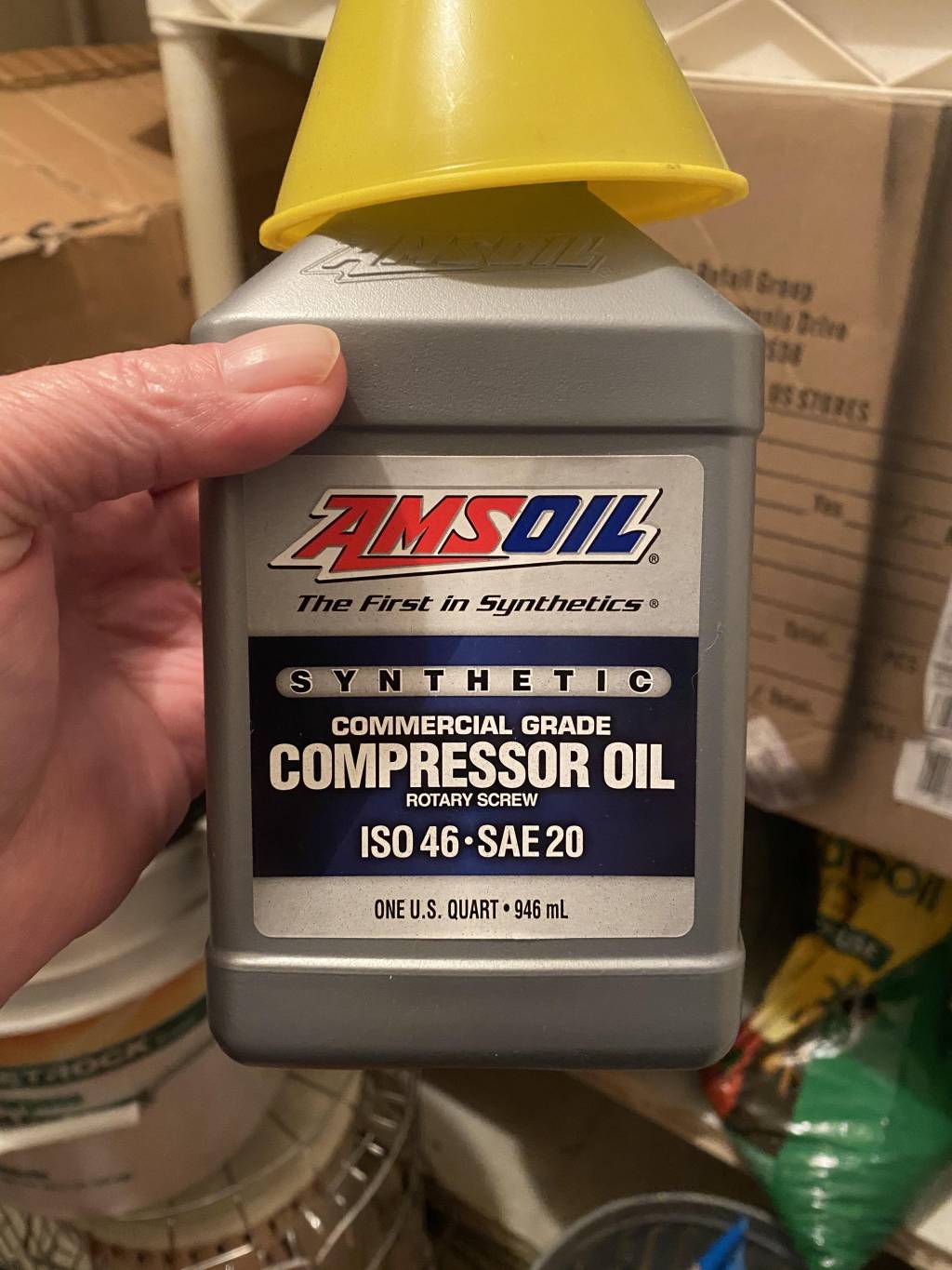

the Amsoil compressor oil flash point 262 C, 503 F degrees

Amsoil quote "The correct viscosity grade compressor oil is recommended for use in rotary screw, rotary vane, reciprocating and other compressor applications. Compatible with PAO, ester- and petroleum-based compressor oils. Not compatible with glycol- or silicone-based compressor oils."
there is a LOT of difference between mineral based oil flash point and class V synthetics
https://amsoilcontent.com/ams/msds/pck.pdf
