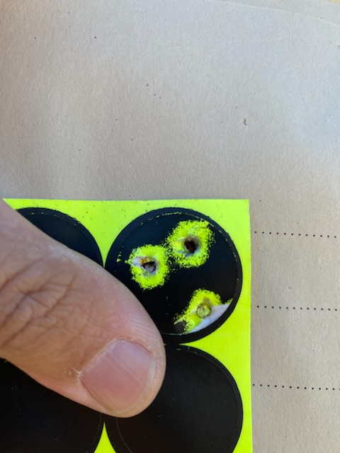

I happened to had great luck with my crown with 500mm 177 barrel shooting 12.5 grain NSA.
This was .56 inch at 100 yards, could shoot at it after the third shot.

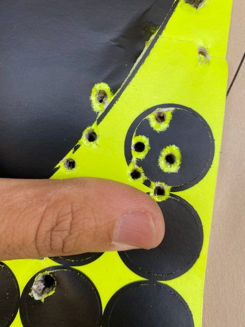

Same day, bigger group thanks to misreading the wind but still just over an inch from 2 almost 1/2 inch groups at 100 yards in the wind.
For those who thinks FX can’t shoot 177 accurately or can’t shoot 177 slugs accurately, I can say from first hand experience that is not true.
Same day, bigger group thanks to the wind but still just over an inch and 2 almost 1/2 inch groups at 100 yards in the wind.
