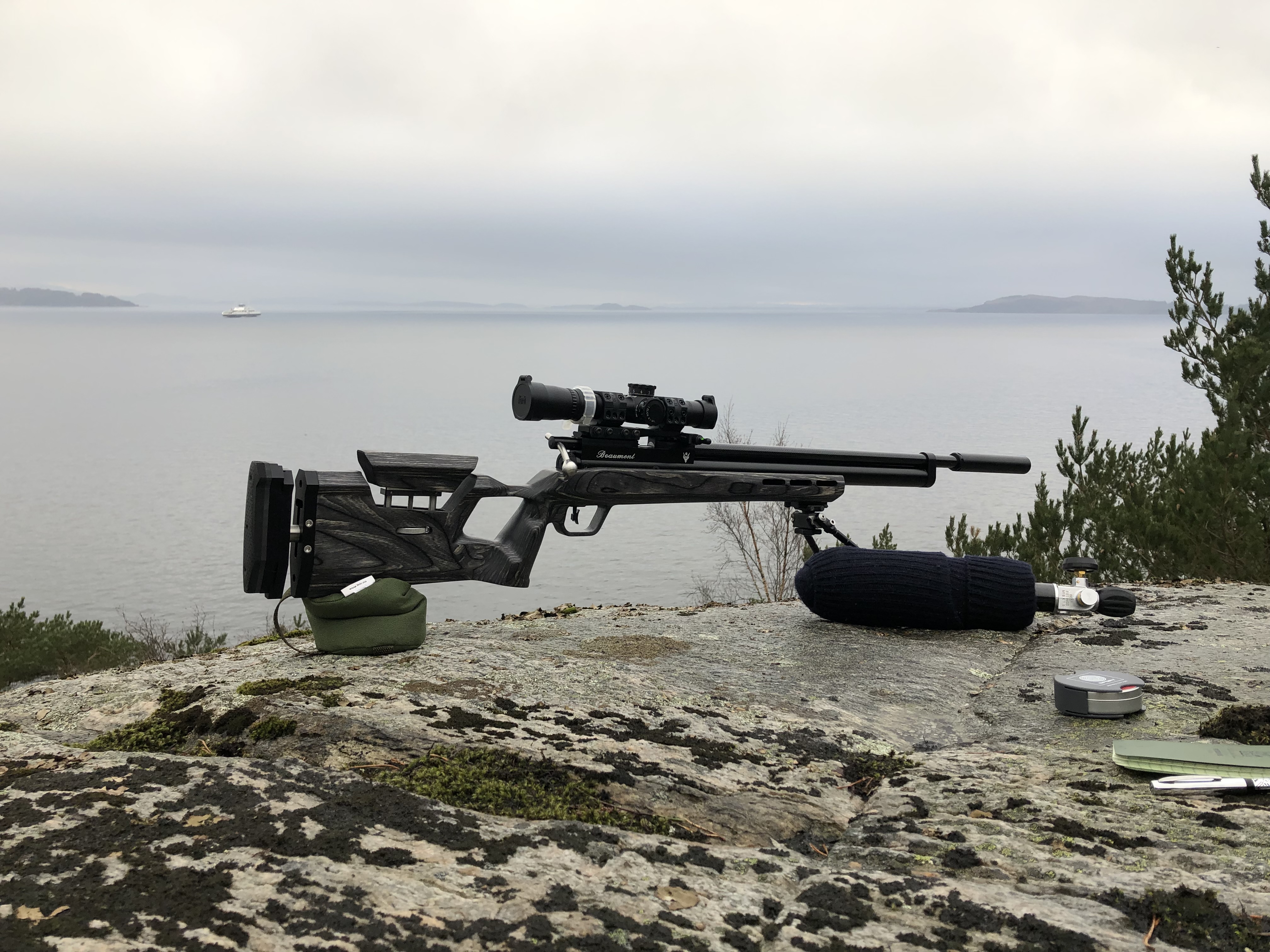

I have posted several images here how well my Daystate Revere shoots 16-20grain ZAN slugs. I am in process to have some 22grain .177s made. I too want extend the .177cal beyond the 150m. The Daystates like the RW with conventional land/groove rifling stabilize the slugs ekstremly well. I hope the Skout Eepuck with all its hightech can do up to some 50 ft/ibs with 23-24grain slugs in 177cal.
