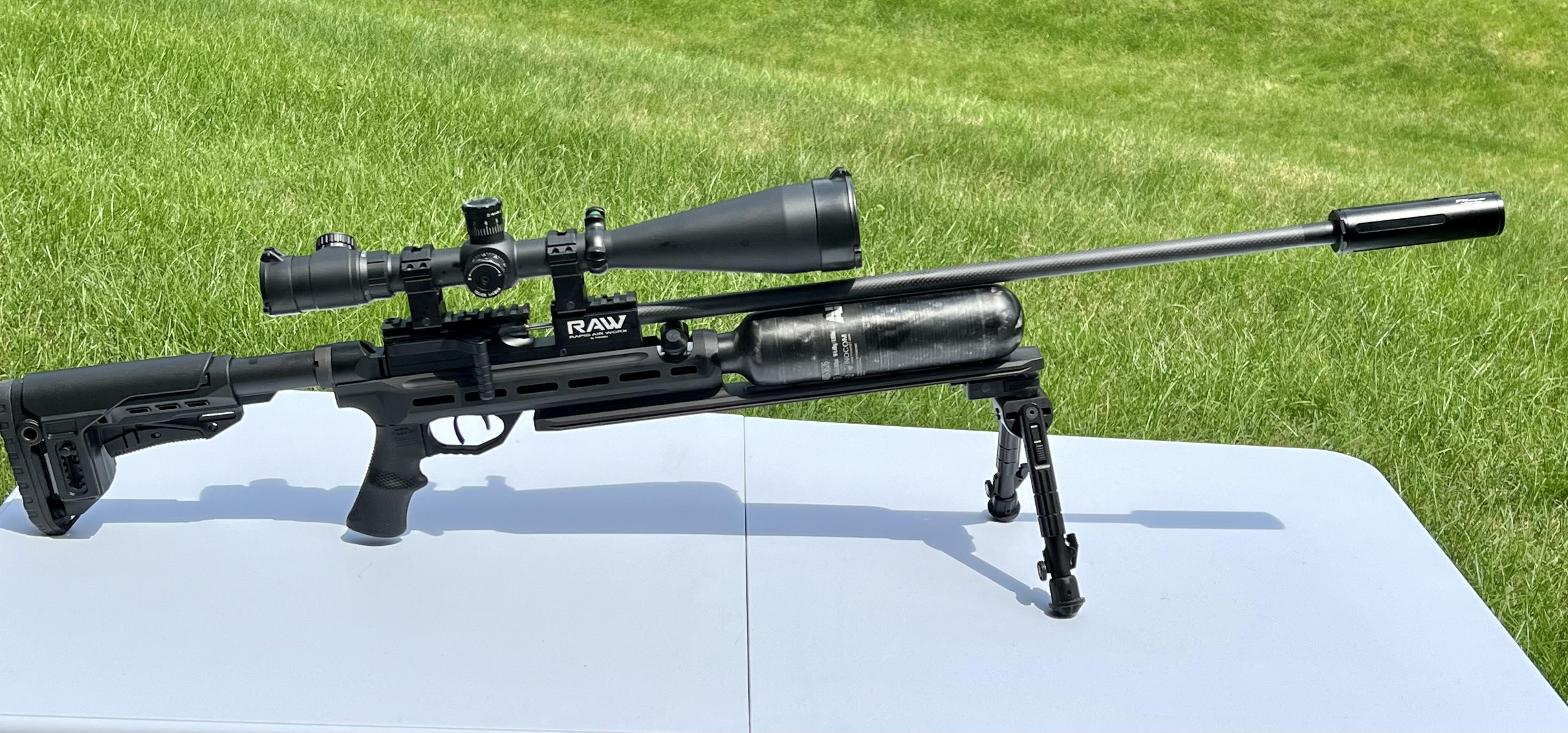

Since my post in January 2023, I went out on a limb and had a RAW HM1000x built for me by Martin Rutterford at Airguns-USA in .177 caliber. I have been competing in100 yd EBR style events along with some top shooters in the country who typically use 30 and 22 cal rifles. I wanted to see if the .177 could be competitive. My rifle shoots 13.4 gr Zan slugs at 1010 fps and it will run with the higher caliber guns any day. Sadly, Martin no longer builds custom RAW rifles any longer, so I got one of his last. He still has a few that he's finishing up if anyone is interested.
