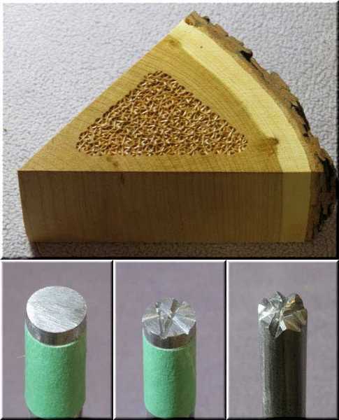

I make/refinish my own gunstocks and will often stipple them with a homemade tool. Wrote up a guest blog for Pyramyd Air on that if you are curious about how I do that...

Nice! Thanks for the info.

Excellent blog.

I've never tried to put a pattern over/below checkering on a rifle stock. Nor with a router. But the striking tools above work great, require very little skill or special tools and produce super nice edges. If I were to put a pattern on a gunstock that's what I would use.

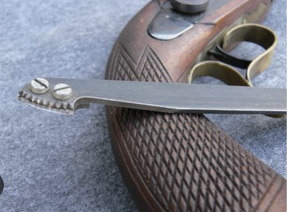

With a checkering “clean up” tool, you could deepen and make the current stamped checkering feel and look like hand checkering. Fairly easy using the old as a guide. Borrowed picture.View attachment 512370
Make your own cleanup tool by heating the end of needle file red hot and bending the tip to make it curved. Works very well. Doesn't seem to affect the hardness of the hard chrome teeth.
the issue with that is their checkering is pressed in or laser cut and opposite of hand cut with tools
it’s not so easy to recut and isn’t just deepening it. it can be done but actual 60 and 90 degree cutters are needed
you have to actually recut the diamonds and sharpen them from the top down.
