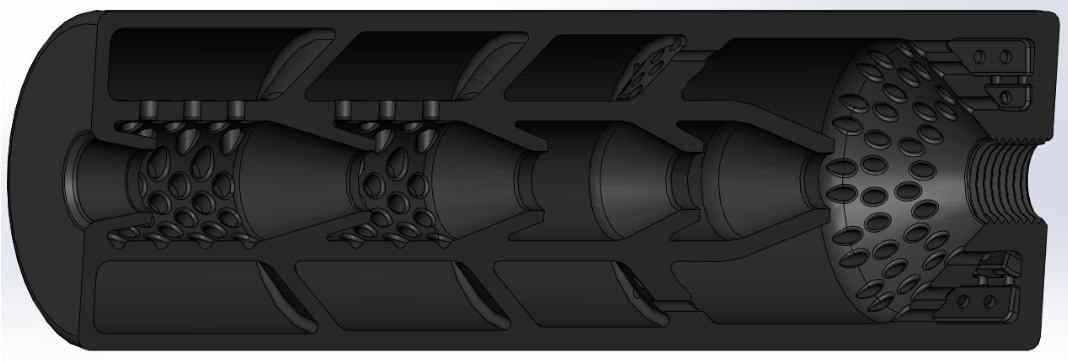

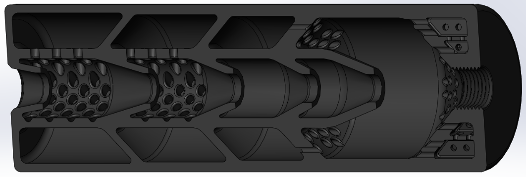

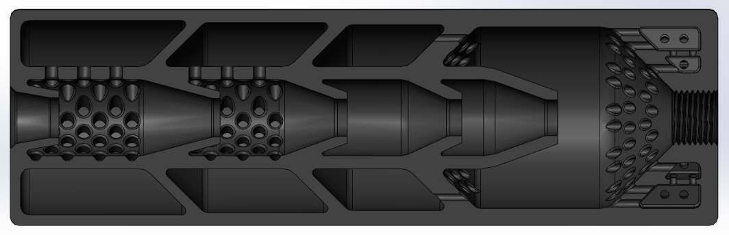

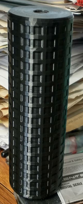

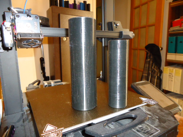

Mackeral5 also has a number of custom mufflers and inserts that I designed for him. Some work better than others; which brings me to a side-note: The usefulness of factory-made moderators as benchmarks. So, when you have your Sarrisa in hand, I would like you to compare one of my custom mufflers against it. I do not expect my 6.5 x 2" OD effort to match the Sarrisa, but to give it a run for its money, at a quarter of the price.
To facilitate such a comparison a .25 cal 6.5 x 2" muffler with a half 20 thread will be on its way to your shipping address, by the time you read this, free of charge. The only costs you are expected to incur are for your pellets and air
This cylindrical muffler was derived from the oval offset moderator I designed for the Huben pistol, shooting at over 60 FPE. And, it works very well in that application. The wall thickness is heaviest around the blast chamber; then steps down as the pressure drops towards the front, to keep the weight down.
Anyway, I would not dare suggest that you try my offering first, to see if it meets your needs, before your decide on the Sarrisa. I would rather you rank the two mufflers, taking into account the absolute performance, size, weight and cost. Then post your impressions or results on open forum.
I shall close my topic deviation with; I trust that your Sarrisa will live up to its reputation.

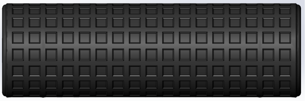

Note that the waffle pattern ribs were added to the OD of the smooth muffler version that is shown in section below:
