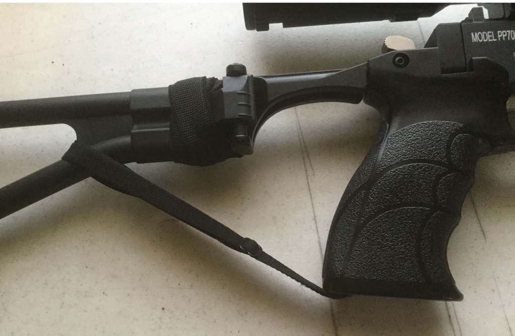

Anyway the stock is wobbly as is and I was expecting that from previous posters so I used two elastic bands to make the stock a tad more solid. The band from stock to pistol grip is just looped through stock and a hole through the band allows the bolt at the bottom of the pistol grip to thread right through. Works simply without permanent mods to gun or grip.

Niiice!
Congrats on your new toy! I just love my PP700, and I'm sure you will too!
Great mod, that's a quick efficient 'fix' for the oem stock wobble..
You'll have to keep us posted on how it works for you as time goes on..

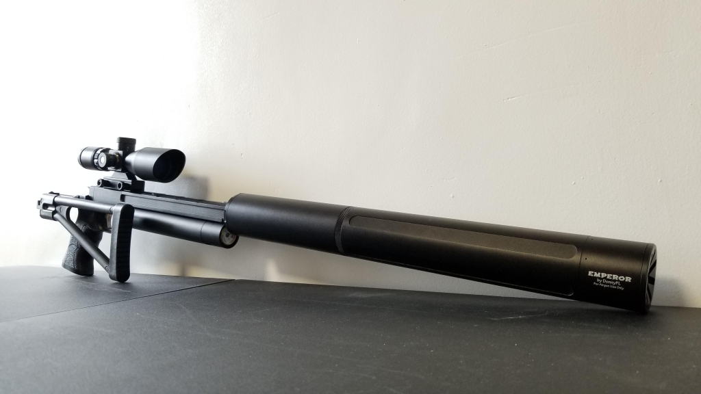

BTW, the Extended Emperor V3 suppressor started out as a joke,
but OMG did it make that thing quiet!! 😃
