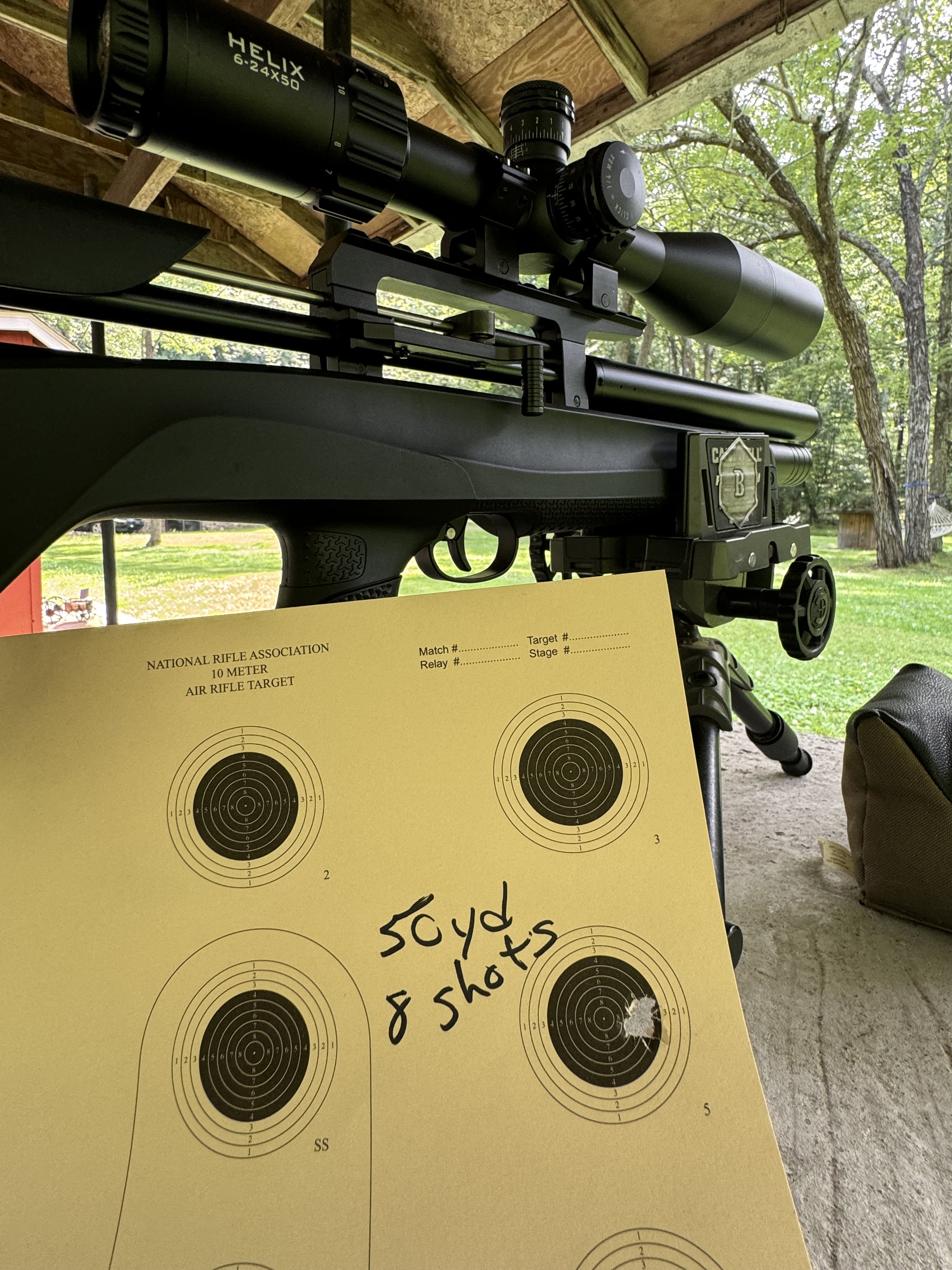

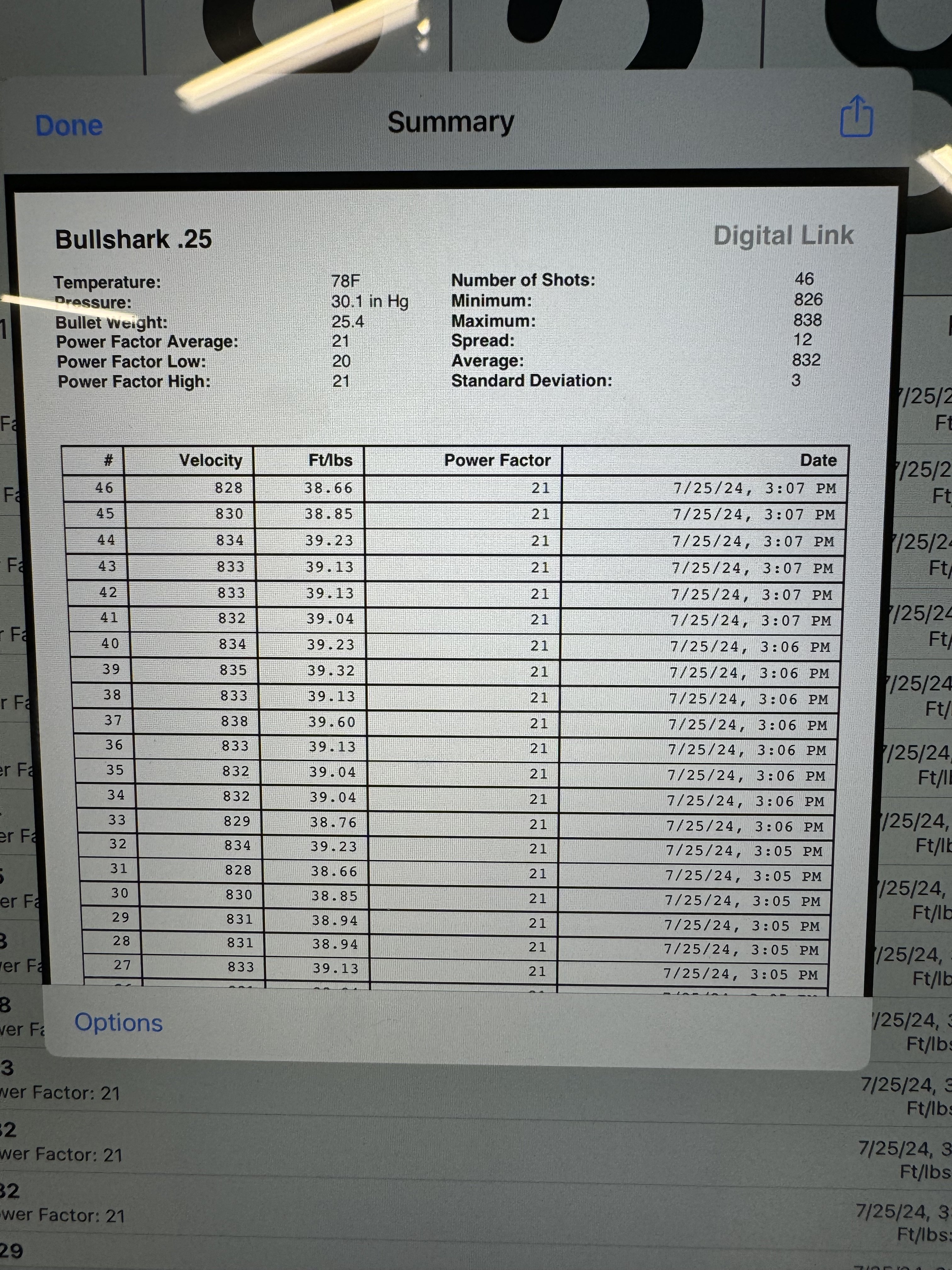

Stoeger .25 Bullshark performance specs
Velocity = 832fps with 25.4g
Shot count = 46 on reg and 55 usable to 45yd
Weight = 6lbs
Mag = 8 round
Regulated = Yes
Max fill = 3600psi
This is as tested @ Airgun Revisions and currently available at Airgun Revisions.
The .177 will be up next in another thread. A along with the Scout and Ranger that’s currently available.
All the best, Rich

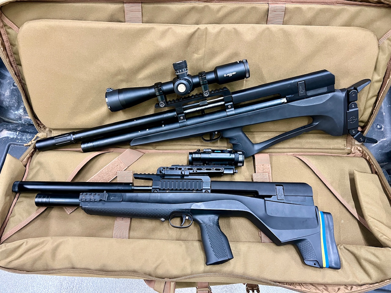

Yeah all that is going to be the same. Huge difference is the stock being used offhand way nicer. The grip up front allows the gun to be pushed to the shoulder easier and supports the gun better for charging the next round. So offhand shooting I found this design really nice. Especially with a red dot.
Reactions: Florida_Man
I wish the previous owner of mine didn’t hack the stock up. I had to secure the front with a longer screw and a washer. What little they put back together, the valve spring was backwards. It was an adventure.
They are great bullpups. I’m with JimD and would have bought a Bullshark 25 if they were available when I bought my P35. The rifles are currently swapped stocks.
