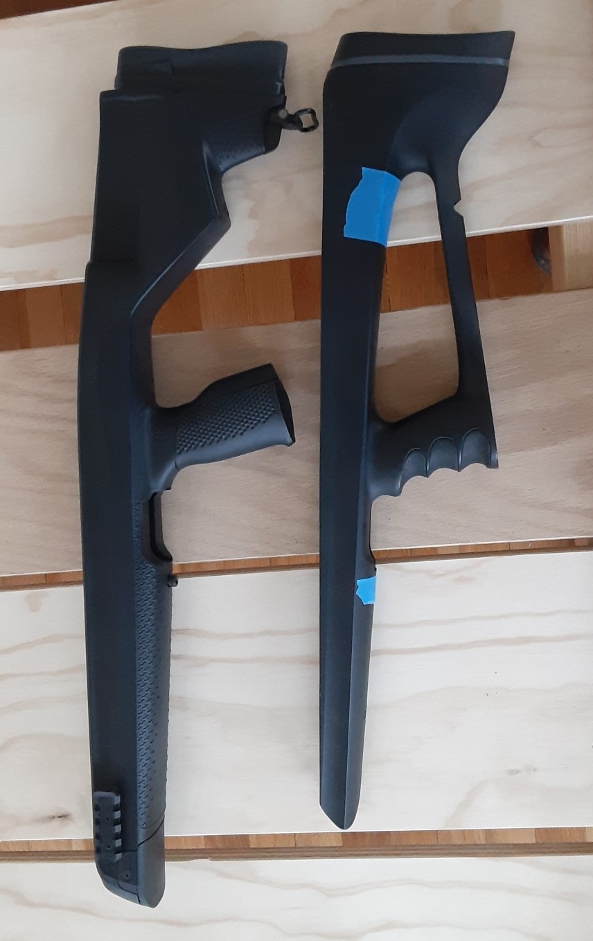

First difference is the weight. I used my old electronic fish scale to obtain these weights so I am sure they are off by an ounce or two on some measurements but they give us a pretty decent idea. My P35-22 in the cherry stock I normally have it in weighed 5 lbs 4 ounces without a scope. That bare action (no stock or scope) weighed 3 lbs 13 ounces. The Bullshark action weighed 3 lbs 15 ounces. That extra 2 ounces is probably the 40 mm longer barrel primarily. My original plastic P35 stock weighed 1 lb 2 ounces. The Bullshark stock weighed 2 lbs 2 ounces. It's a bigger stock as will be illustrated with a picture but an extra pound for the stock seems like a lot. I made wood stocks for all my P35s mainly to get them to fit me better but I would do it for sure if I had a bullshark. I think this difference favors the P35.
While we are on stocks, both rifles have about a 13 inch length of pull in their plastic stock. I consider this grossly small. I want about 15 inches. I also want a larger distance from the back of the handgrip to the trigger. I put those differences in my wood stocks. The softwood one is thus larger than the plastic original but still weighs about the same. The hardwood ones are bigger and weigh about 1/4 lb more. I liked the bigger handgrip the owner had put on the bullshark better and I think the fact that include options on the handgrip and cheek rest is an advantage for the bullshark. Their length of pull added pieces are so small they don't seem to do much, however.

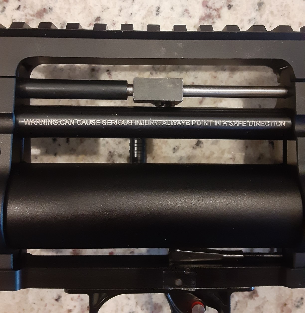

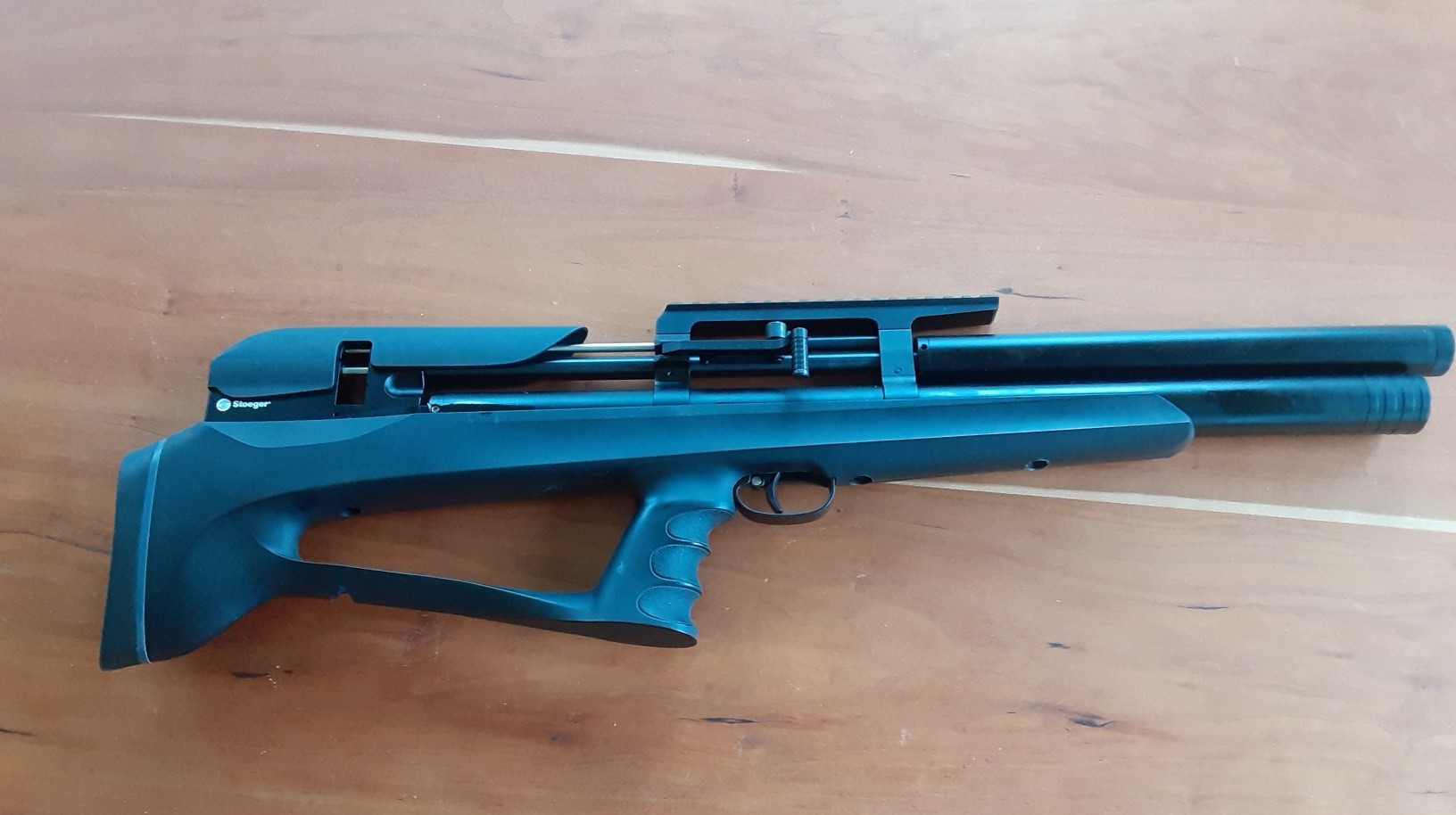

A silly little difference that does not favor the bullshark is the additional warning label on the barrel that I'll include a picture of. Not a big deal but not an advantage to me, either.
