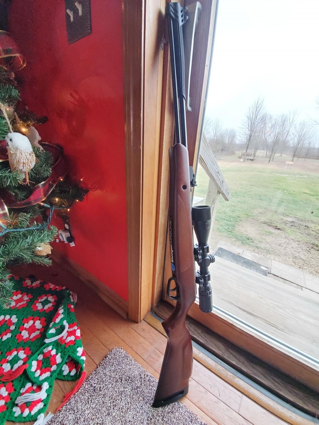

So I just got this in, it was a combo package with scope not too shabby. Can't wait to see how it does. Has anyone ever messed with model ?
Yea I must say its actually a nice rifle . So far it's the typical mushy long travel on the trigger and I ran the chrony and so far I'm getting an average of 640 fps with some 14.3 grain pellets . I'll post some groups after I run a couple hundred through the barrel. It's a little noisy in the cocking effort but it seems they I mean Stoeger could do much better im sure. Only cause its spring powered. But no biggie I wasn't expecting too much for 230 bucks. However it seems to shoot pretty decent. I'll try to get some groups soon. For now it's about 13- 15 ft lb gun that's pretty safe to say. Once the barrel brakes in I'll get some pics of some groups and all.

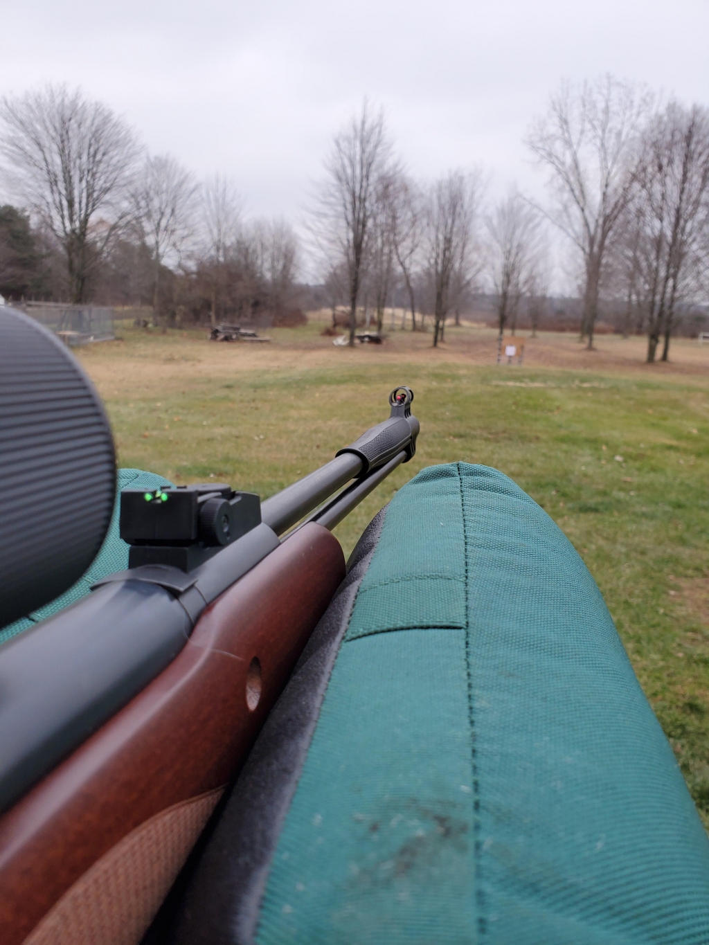

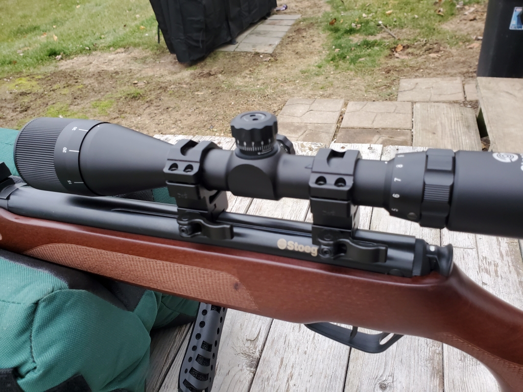

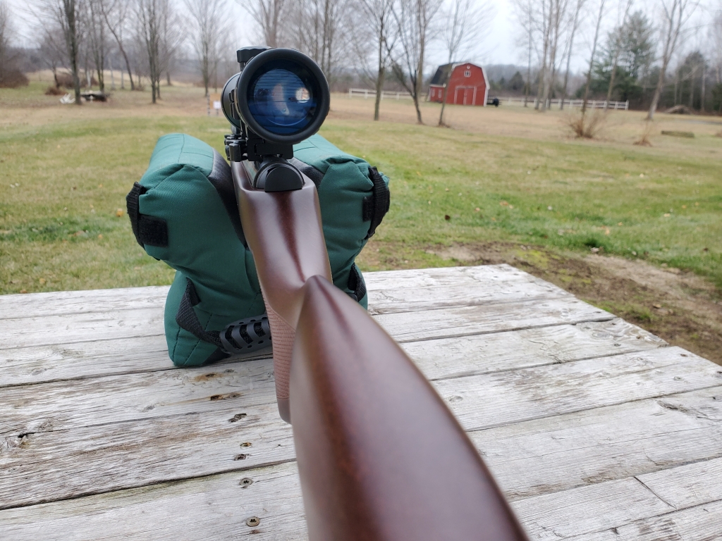

So here a couple more photos. I was gonna try for groups. But damn the wind and 34' degree temps were really putting a hamper on things. I went ahead and shot a few only cause I haven't really sighted in correctly. At first it was sending pellets all over the place @ 35 yards. Then the wind was blowing easily around 5-10mph. It was just not going to happen. HOWEVR when the wind slowed down it would seem to hit the previous hole I did earlier, then it would just wander off. Cheap scope? I think so. Cause sometimes it would drop them within less than inch. Then sometimes just wander off . So I decided to to check stock screws. Sure enough they were not even snug, they were hand loose. So when i snug them down i notice the wood stock was starting to stress. I stoped there and took a closer look on the inside where the screws mount and sure enough the wood was starting to fracture. I stopped there and sent an email to Stoeger since its covered by a 5 year warranty and asked if I can send them my stock for a replacement. Kept on shooting and so far it was still shooting straight however the wind was just really not working for me for now. But the gun is kinda loud there are no baffles in there so I figure that's pretty much it. As for the scope I'm gonna keep using it but I need a zero wind day to check its accuracy. I thought of using my basement though LOL .
I did a few shots but I returned the gun for warranty issues on the stock. There is a problem with the cocking lever pin not sitting flush. I fixed that with grinding it down a bit. But I'm taking caution not to tighten too much,but rather snug it down and use thread locker. ALSO I did chrony it with 14.3 grain pellets and it shoots way too slow fo my liking . Like 528 fps. Way to darn slow. Could be maybe the piston seal not perfectly round cause I did pull it out and saw a little deformation kinda like a flat spot on the seal. I dont know if this could cause issues with losing power? Anyone know about that?. However I had a gamo varmint spring laying around and it has like about 4 coils more that the stock spring and I stuck it in there and also got a 3mmx10 screw to replace the stock adjuster for trigger and it now breaks soooooooo much cleaner now . I'd recommend that for sure . However I've hadn't much time to sit down and give it the time yet to adjust and see how it performs let alone run the chronoy test. I might get my sony cam out today and try that and post the video today . I do have a couple videos on this rifle on YouTube now . You can check it out if you all like to. Search Stoeger F40 OR S6000A. . SHOULD pop up. But I've also got the deal of the Century with Cabelas, I bought a MARAUDER .25 CAL. LAST week for like 346 bucks ! I been kinda playing with this a little for now also.
