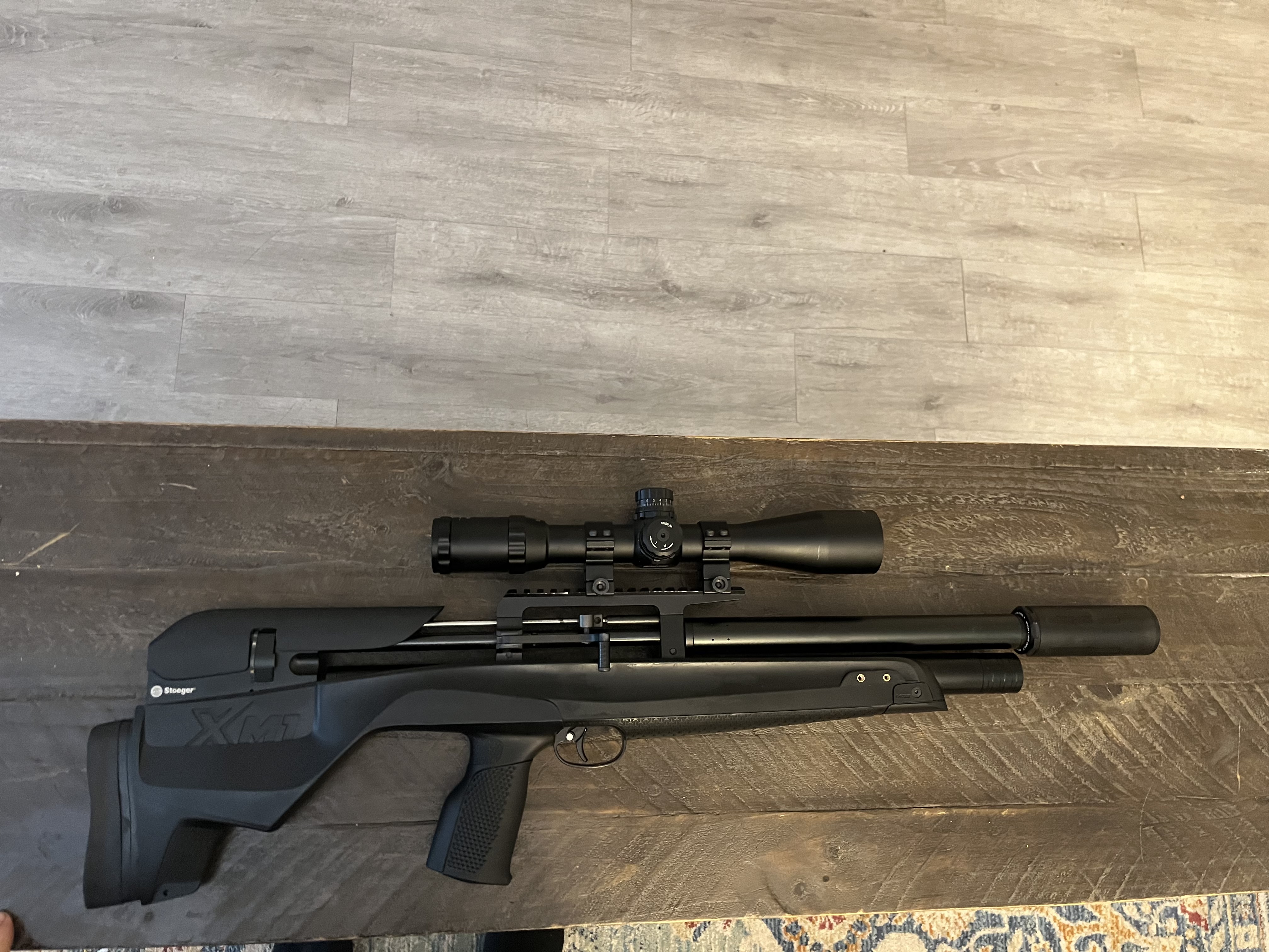

My buddy has the stoeger xm1 .25 although it is an anemic .25 it is perfect for iguanas. It prefers to shoot the 25.39gr jsb and it can easily take down iguanas even out to 60-70yds as long as you don't have too much wind to push you with the low velocities. The low velocity helps with not overpenetrating or still having tons of velocity after going through them.
