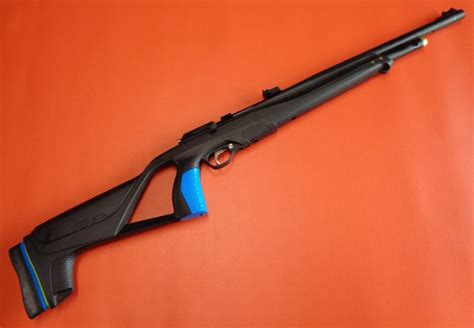

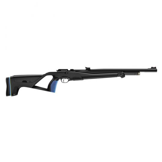

Hi. I just purchased a new Stoeger xm1 ranger. I have a couple of questions if someone could answer them , I'd appreciate it. Firstly,ion most pcp air rifies you turn the hammer spring to the right to increase velocity. It doesn't say in the manual and I wanted to be sure. Next, there's a round tube that has a small hole on each side of it which the manual doesn't even mention. What is the purpose of that and lastly should you leave the regulator set at the stock settings because I've heard a lot of ppl doing that with good results and you have to degass and disassemble the air tube to adjust each time. I haven't had the chance to shoot this rifle yet because of the windy and cold weather but, I was just trying to find out some information about it first. Thanks Robert.

The small round tube with a hole on each side is a tool to take out the gauge on the front of the air tube and yes you turn the hammer adjuster right to increase and left to decrease power in a manner of speaking I turned mine a one and a half turns out and am still pushing 890 fps but my shot count went from 45 shots on reg to 62 shots on the reg they seem to be great guns for A low cost

The hammer spring should be clockwise to increase preload and counter-clockwise to reduce preload. Personally I would test the rifle out at the stock settings first and try some pellets you like. If you decide you want a little more or less speed play with the hammer spring. If you are really off the maybe think about the reg, but I doubt you will ever really need to.

SPA does not provide good manuals with the guns I have from them (3 P35s). You will need a chronograph but there are inexpensive ones that work well for about $30. I start with the regulator setting the gun comes with but I adjust the hammer spring to see what the peak velocity is for a pellet the gun seems to shoot accurately. Then I back off the hammer spring to put the velocity 3-5% under the peak. That will give you good efficiency and reduce noise. If the velocity with the stock regulator setting is not what you want you can adjust the regulator. You degass (there should be a screw at the back of the airtube for this) first and use that tube (it is a thin socket) to remove the big nut on the end of the airtube the gauge is mounted to. The regulator will be at the other end of the airtube. If you have a long extension and a long straight bladed screwdriver you can fairly easily loosen the lock nut and adjust the regulator. Clockwise will lower the regulator setting. I wouldn't move it more than half a turn at a time.
My guess is your Ranger is like my P35s and came with a regulator setting about as high as the hammer spring can open (about 145 bar). If so you can reduce the regulator but may have difficulty increasing it much.
