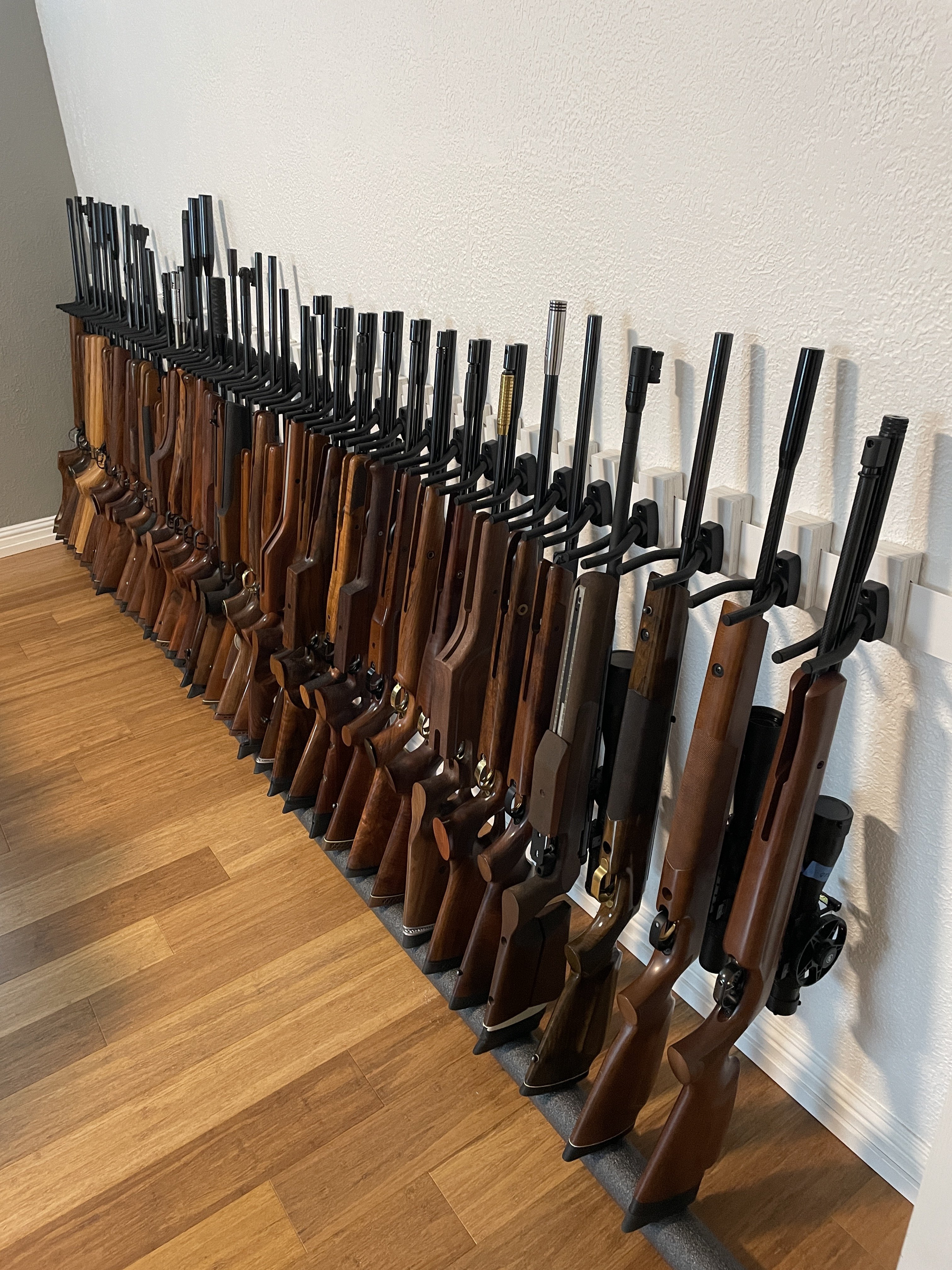

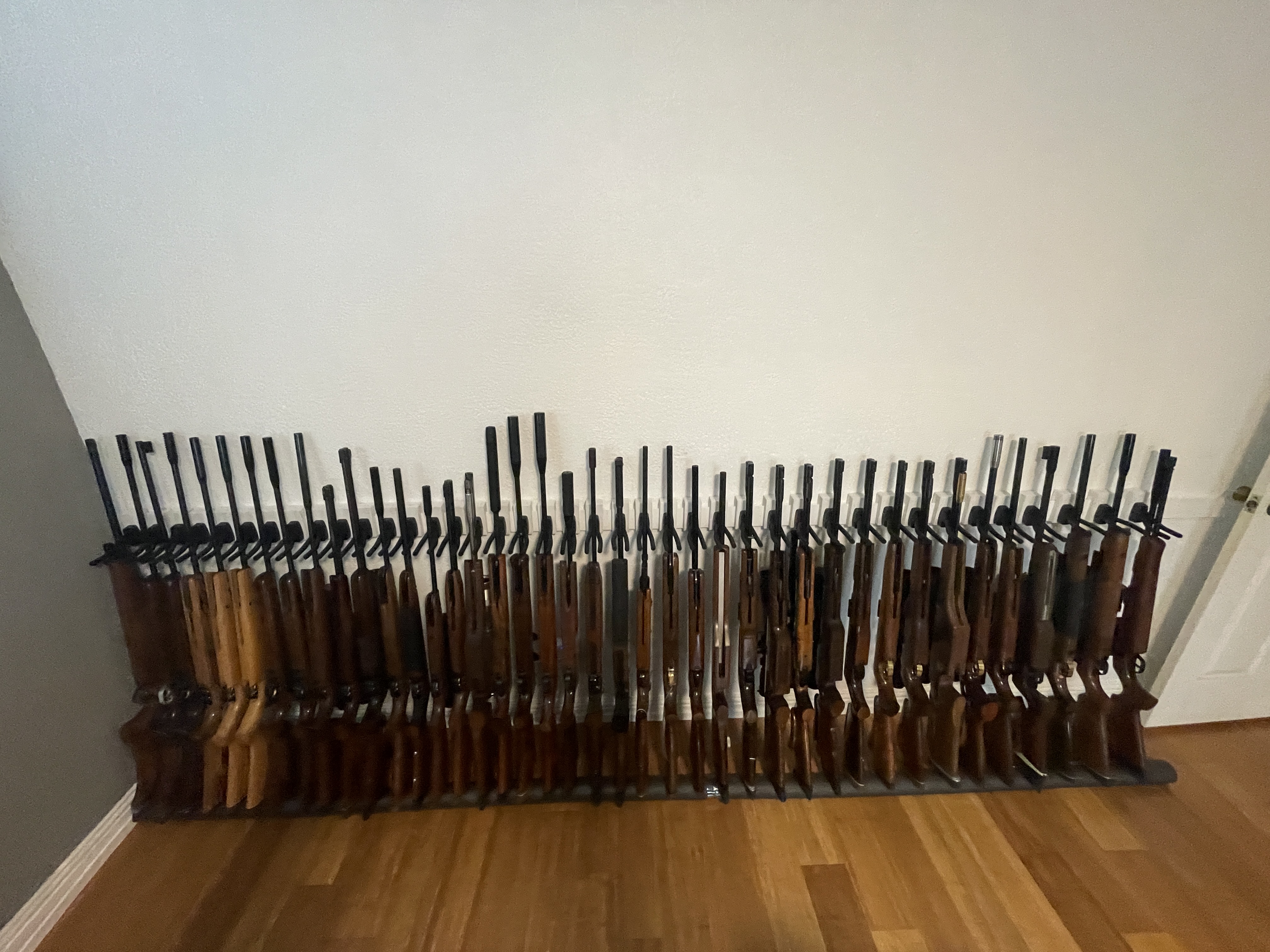

Funny you should bring this up. I just finished making a rack for my springers.

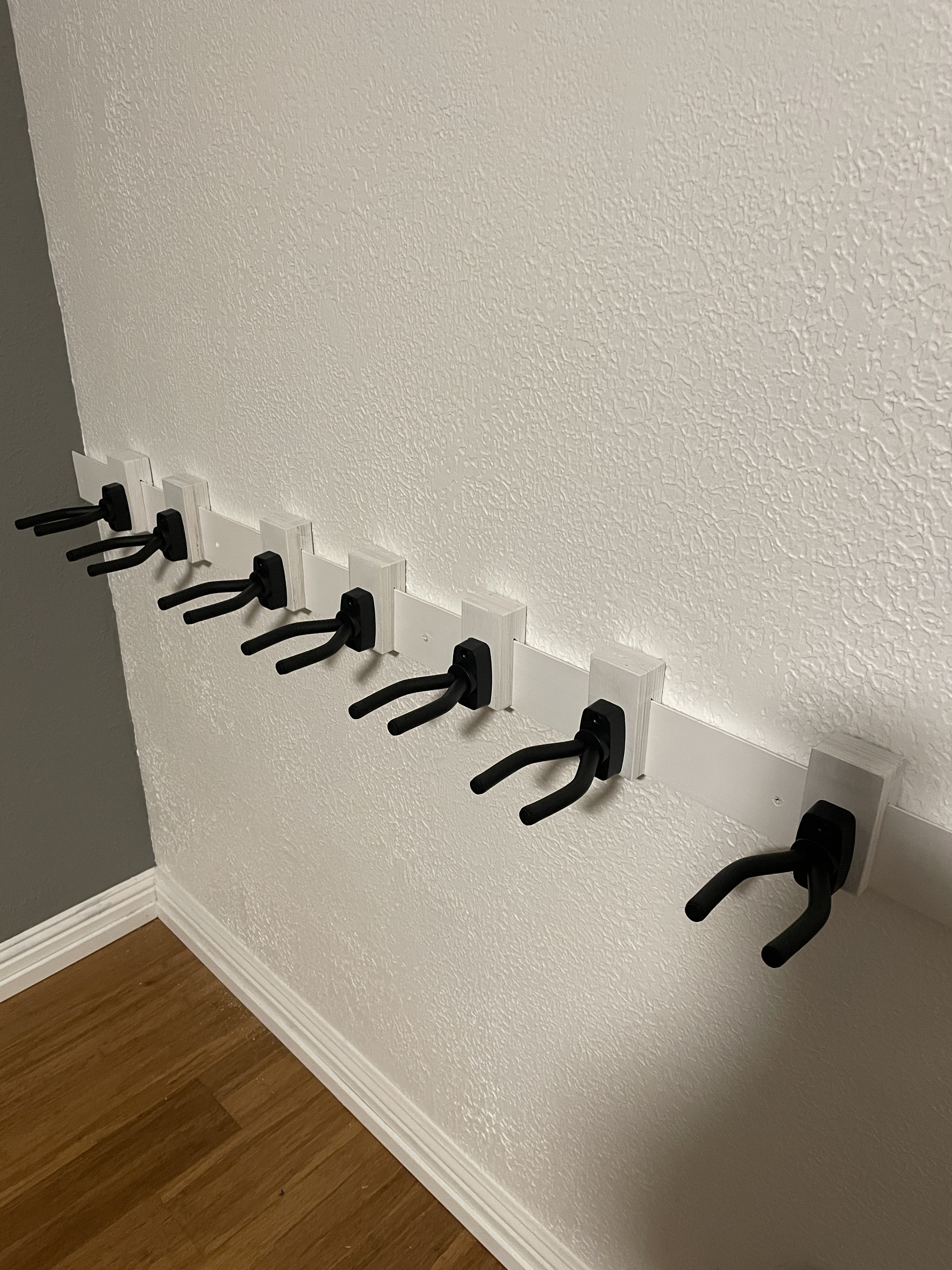

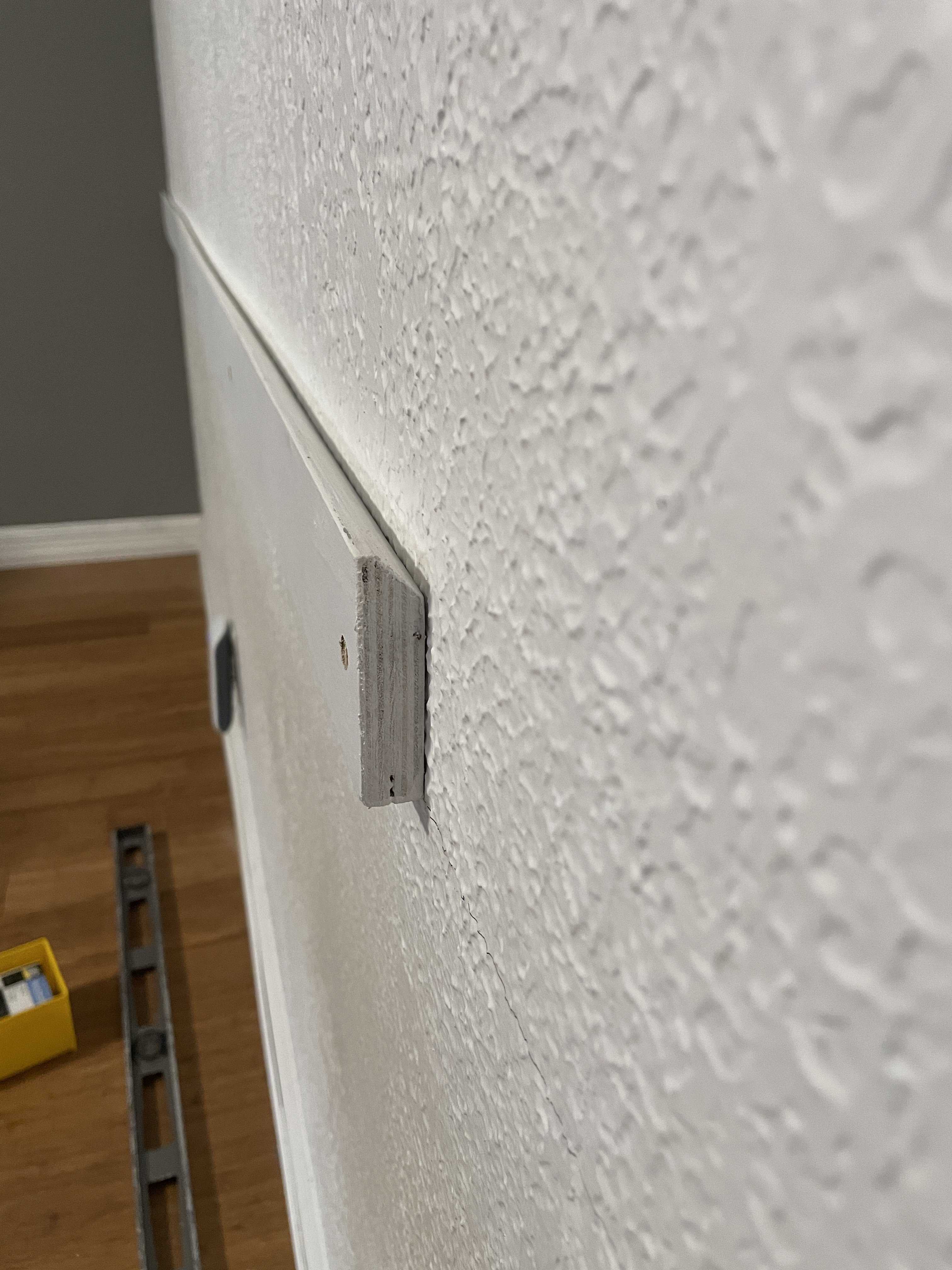

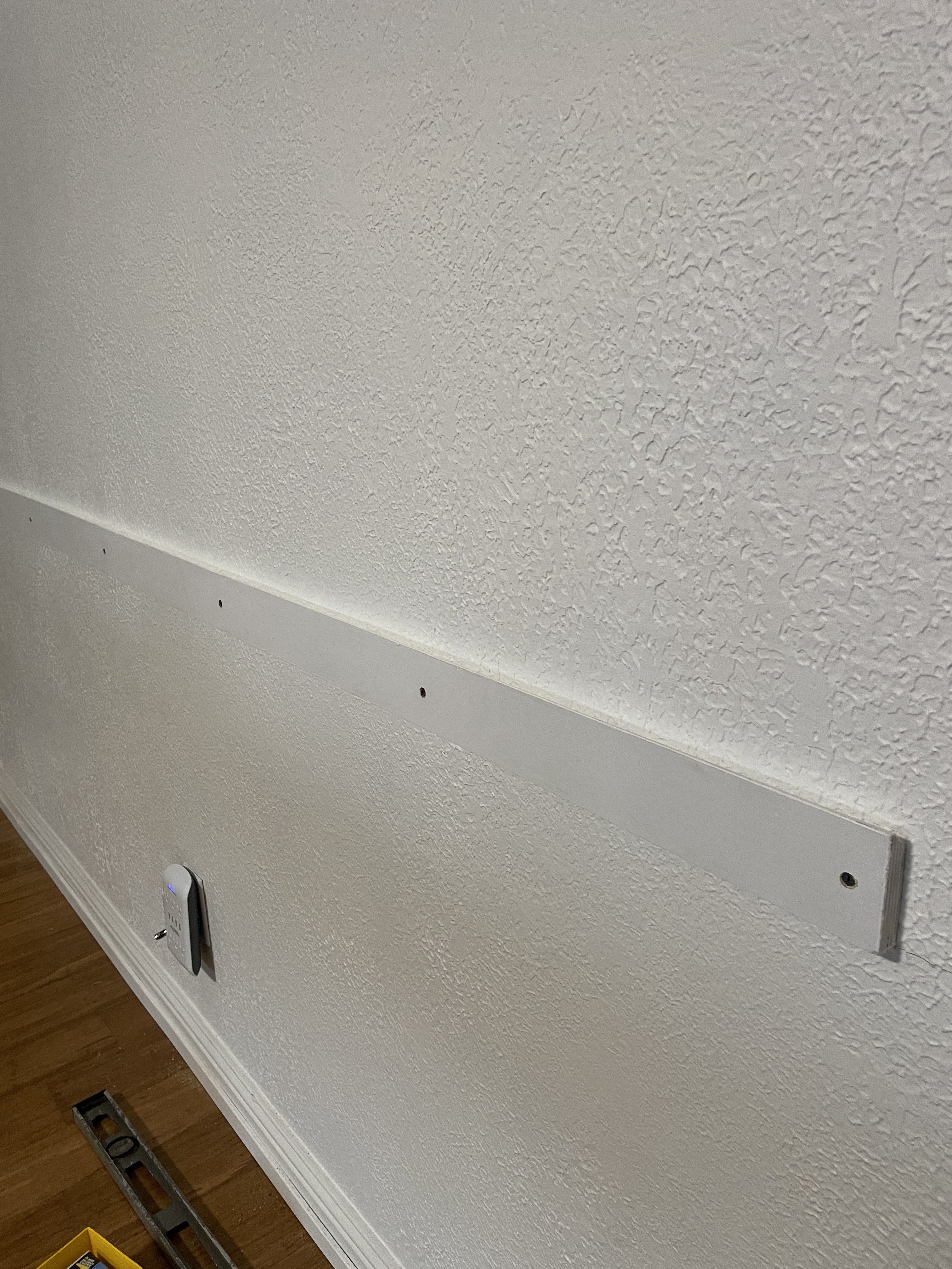

I made a French cleat rail and adjustable blocks that can be positioned at any place on the rail.

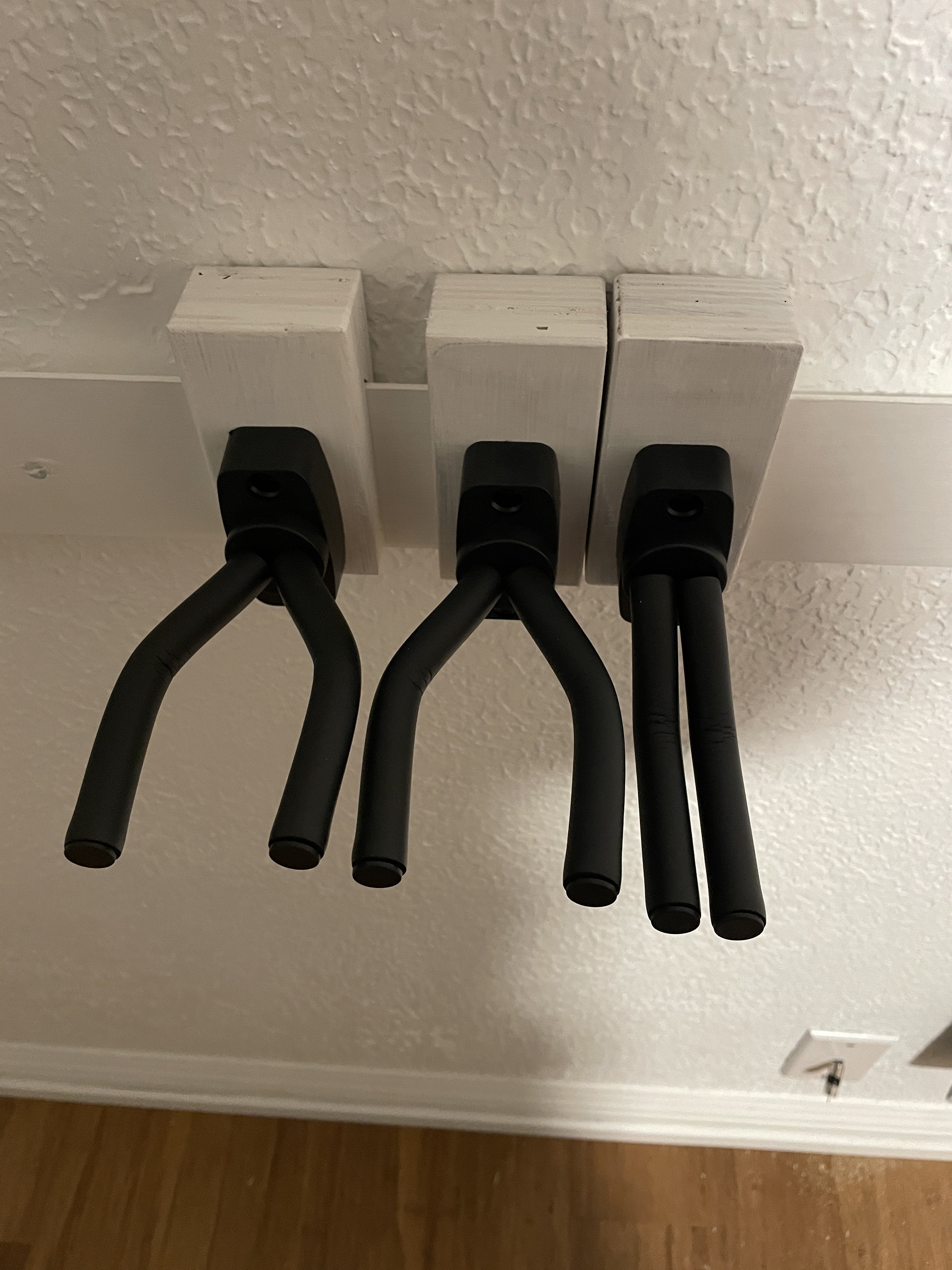

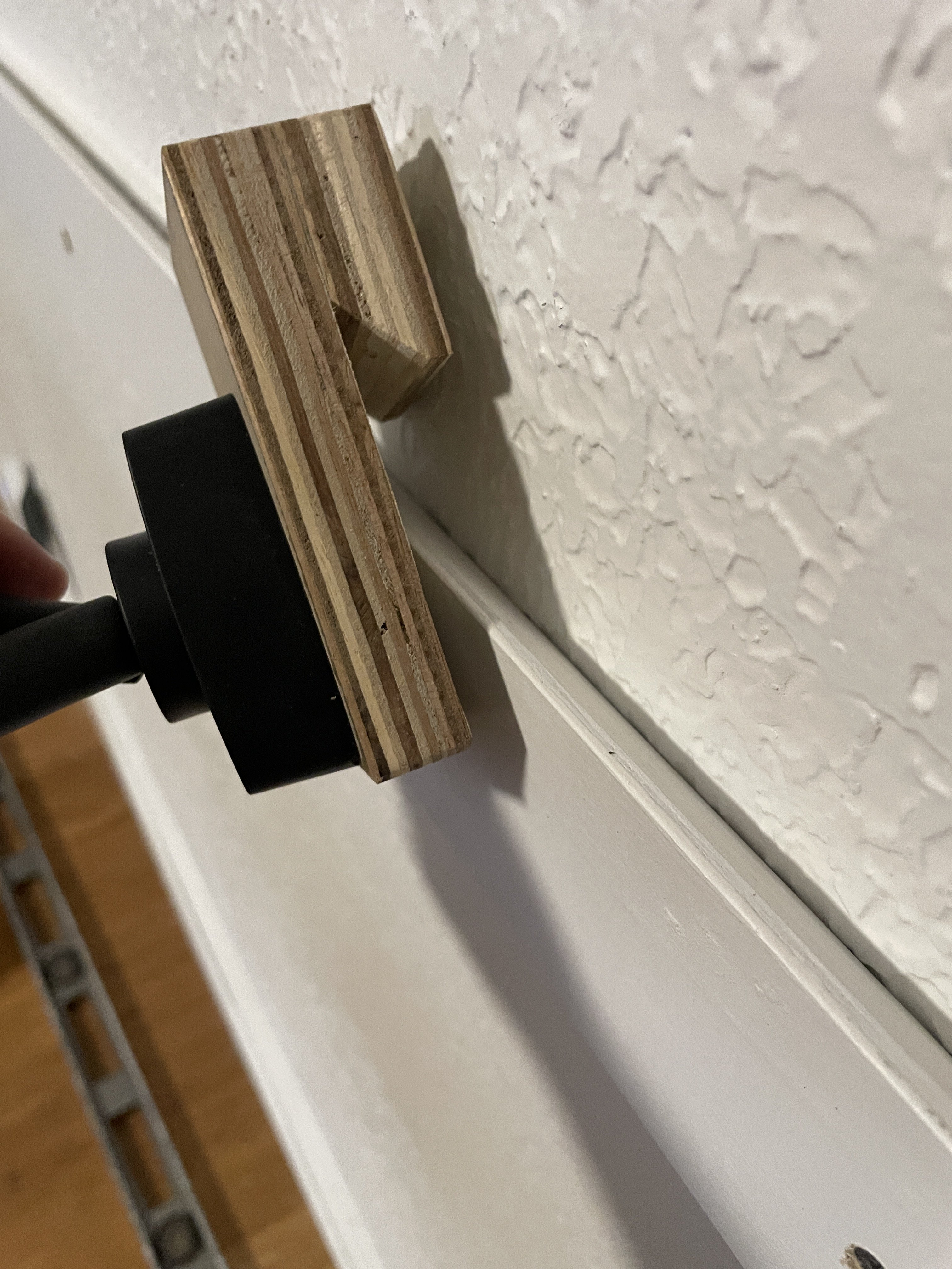

The blocks each have a guitar mount attached. The width is adjustable by turning the arms to fit your action or barrel.

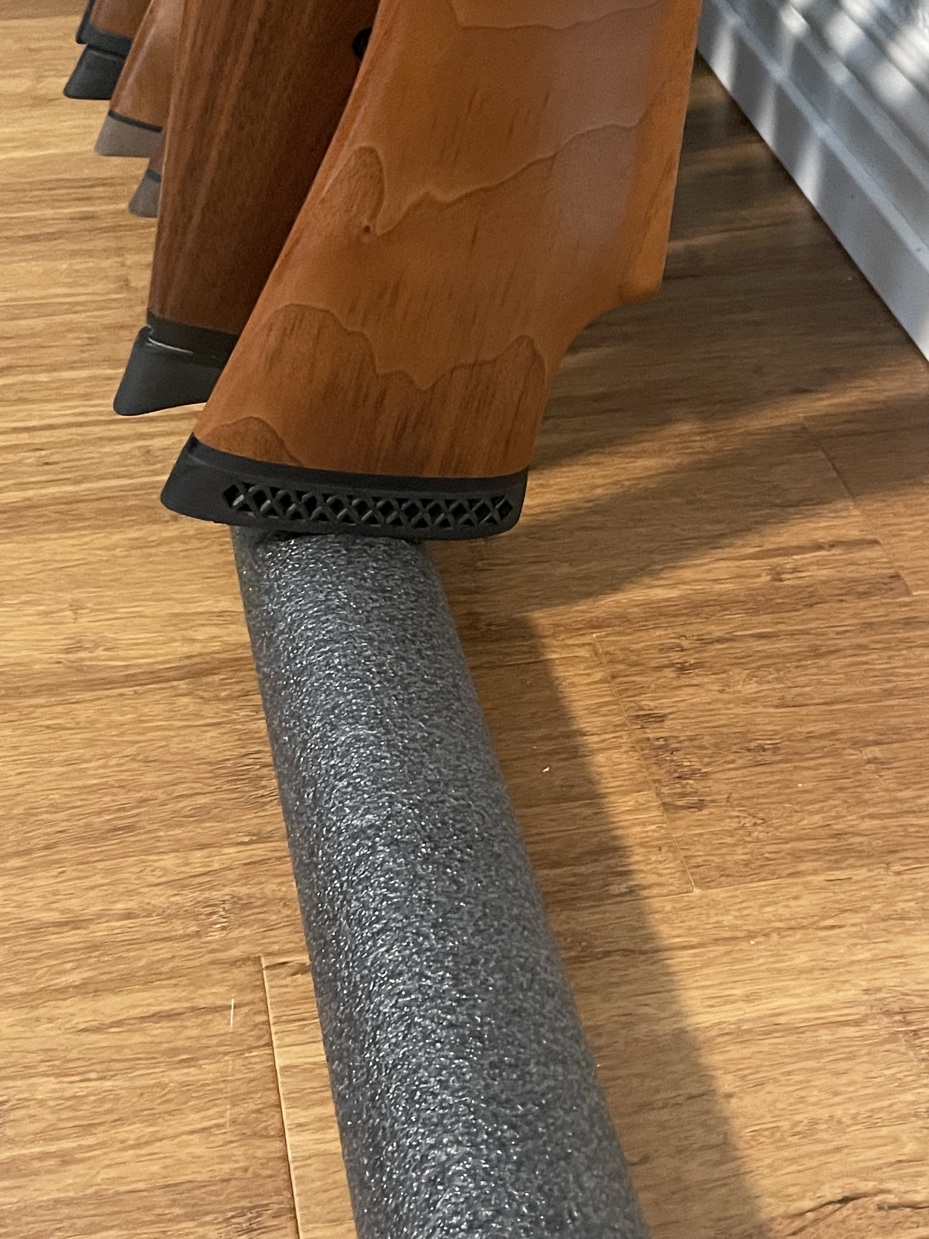

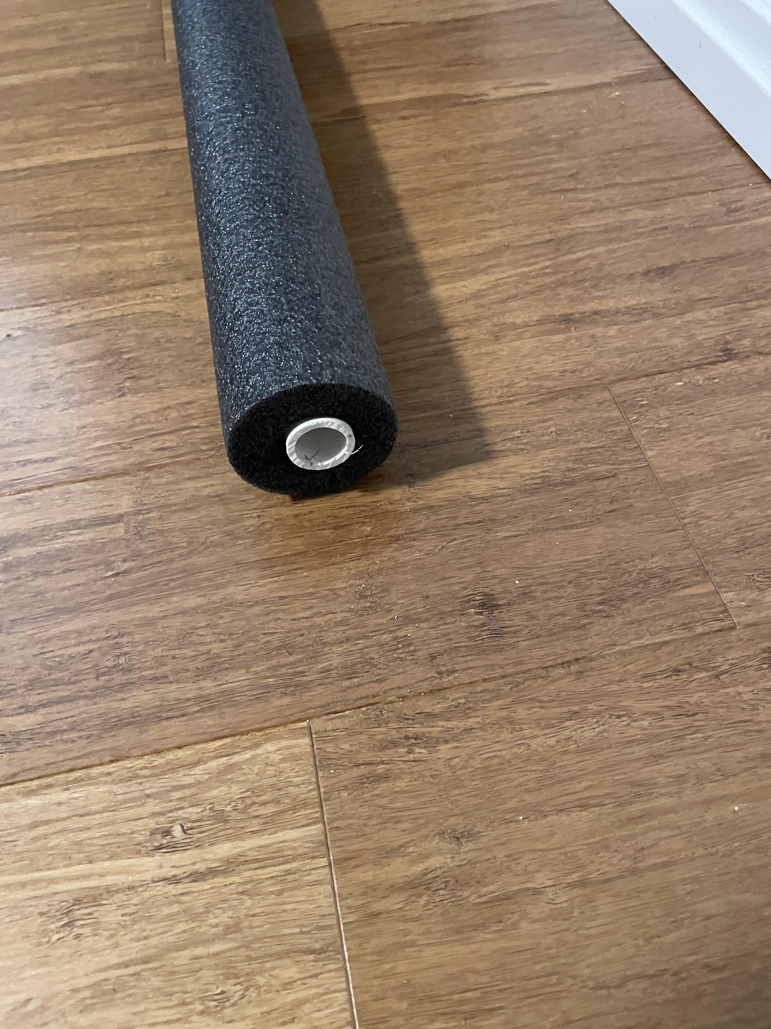

A piece of pipe insulation over a 3/4 inch pvc pipe creates a rest for the butt that won't mushroom the tips over time.

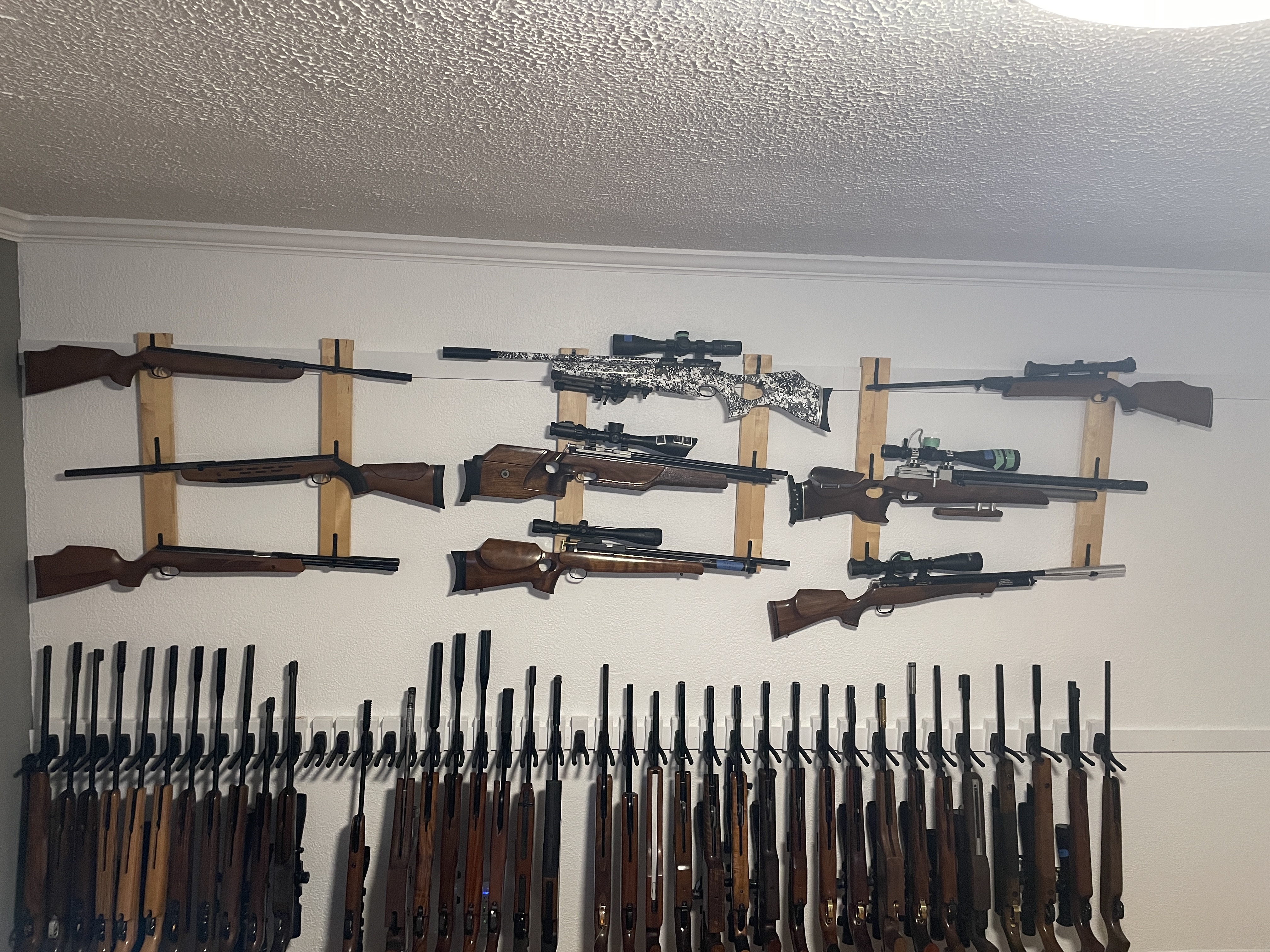

Now on to the other wall for the PCP's. Should be simple now, much fewer of those.

Lewis the butt pad, pad is brilliant
too many rifles are damaged setting on hard surfaces
could there ever be a domino effect and all come tumbling down and dust in the future
nicely done
but where are all the pistols LOL

The only domino type of failure would be if the foam but pad pad was yanked out from under them all. Pretty unlikely but not seen in the photo are two small boards cut at an angle on both sides to prevent any rolling.
I only have a couple of pistols, they just sit in a closet.
