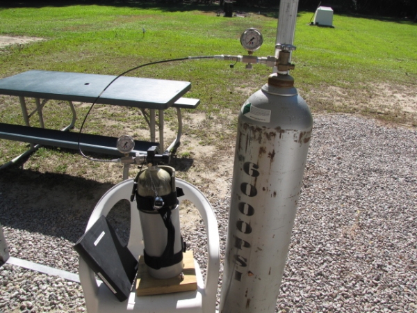

I have a huge 6000 psi steel Nitrogen tank that stays outside strapped to one of the supports of my metal carport. Been using it this way since 2014 with no problems. In the summer, I top off my 4500 psi SCBA tanks as soon as the fresh nitrogen tank is changed out. That way I have a buffer if the Nitrogen pressure expands from the heat? I keep my SCBA tanks inside though!
You can actually tell the pressure fluctuates on cold days verse hot days when filling my SCBA tanks from it. It usually lasts me 8 months before I have to change out for a freshly filled tank.
