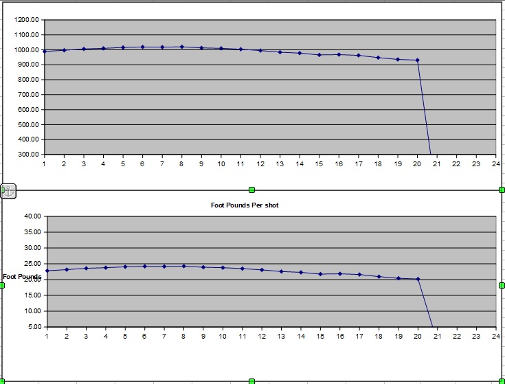

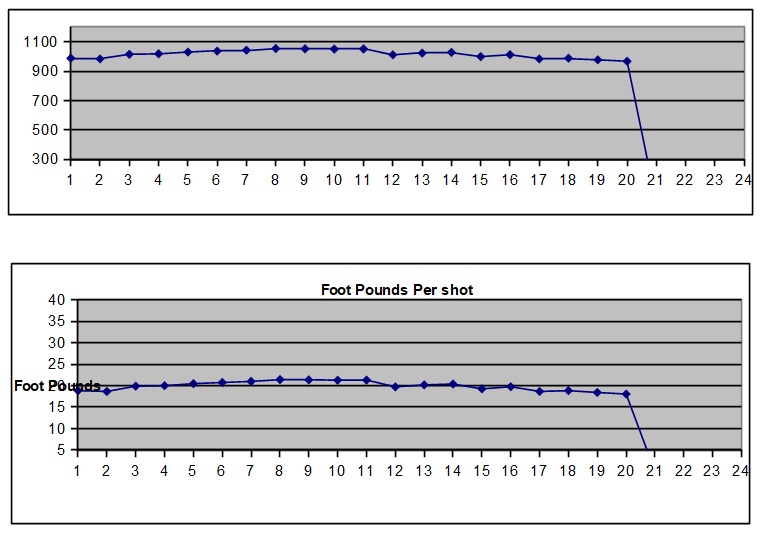

Diana says the rifle is a 20 FPE rifle in 0.177 and a 24 FPE rifle in 0.22. It turns out that my rifle is a 26 FPE rifle in 0.177. I suspect the transfer port is calibrated for a middle weight 0.22 pellet as it was a Rabbit Magnum II pellet at 15.74 grains which gave me the following shot profile. The rifle started the string at 200 BAR and ended it at 140 BAR.
Looking at the above graphs we can see there is a nice string of ten shots (#8 - #17) which give us the following statistics:
I think that string starts around 185 BAR and ends around 145 BAR on that charge. With my hand pump it took me 20 strokes to get the valve to open and another 90 or 100 strokes to pump the rifle back up to 200 BAR. I would not normally pump this gun up to 200 BAR given that pellet. I would use 190 BAR as my start point. That's not bad for a $200.00 unregulated air gun. The gun, shooting this heavy pellet, was exceptionally quiet. The ping of the hammer and the clank of the pellet hitting the target were much louder than the (non-existent) muzzle report.

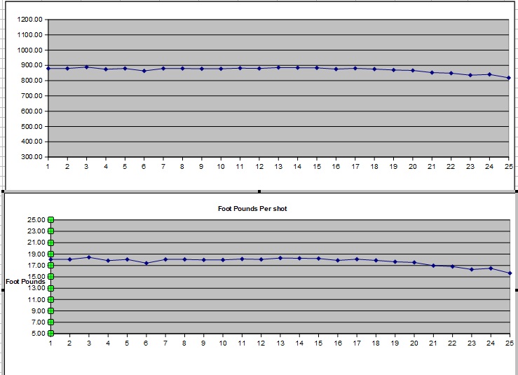

That was a very pleasant surprise. I decided I needed to see what the rifle was doing with a moderate weight pellet and shot H&N FTTs (8.64 gr) for the next string. This is what they did:
The above string was shot starting with a 200 BAR fill and ending with 135 BAR remaining in the tank. The best part of the string also falls between about 185 BAR and 145 BAR. Again I looked for and found a nice string of 10 shots which gave the following statistics:
A sharp eye will notice that there is a longer string than ten shots which could be used with this pellet. The H&N FTT would give you more like 14 or 15 usable hunting shots but I am cherry picking. This is almost 21 FPE with a moderate weight pellet. The report was slightly louder with this pellet but still back yard friendly. Pyramid Air rates the noise level of the gun as a 2 but I think they have not done it justice. It is very quiet. Regulated it will be silent death for squirrels.
Again that just ain't bad for a $200.00 unregulated air gun. This rifle is doing exactly what the vendor says it will do and a little more.

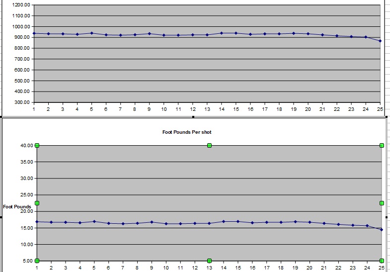

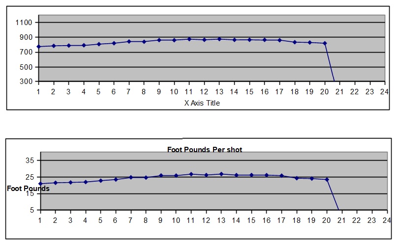

This is for the H&N FTT 8.44 grain pellet. Twenty five shots. I cherry picked the first 20 and the stats are shown below.
Cherry picking those first 20 shots we get:
So we picked up 10 additional shots and have 16 FPE on tap. Twenty shots and an SD under 1%. 😁 I think 30 shots at 12 FPE would be pretty easy to accomplish by just turning the reg down about 20 BAR.

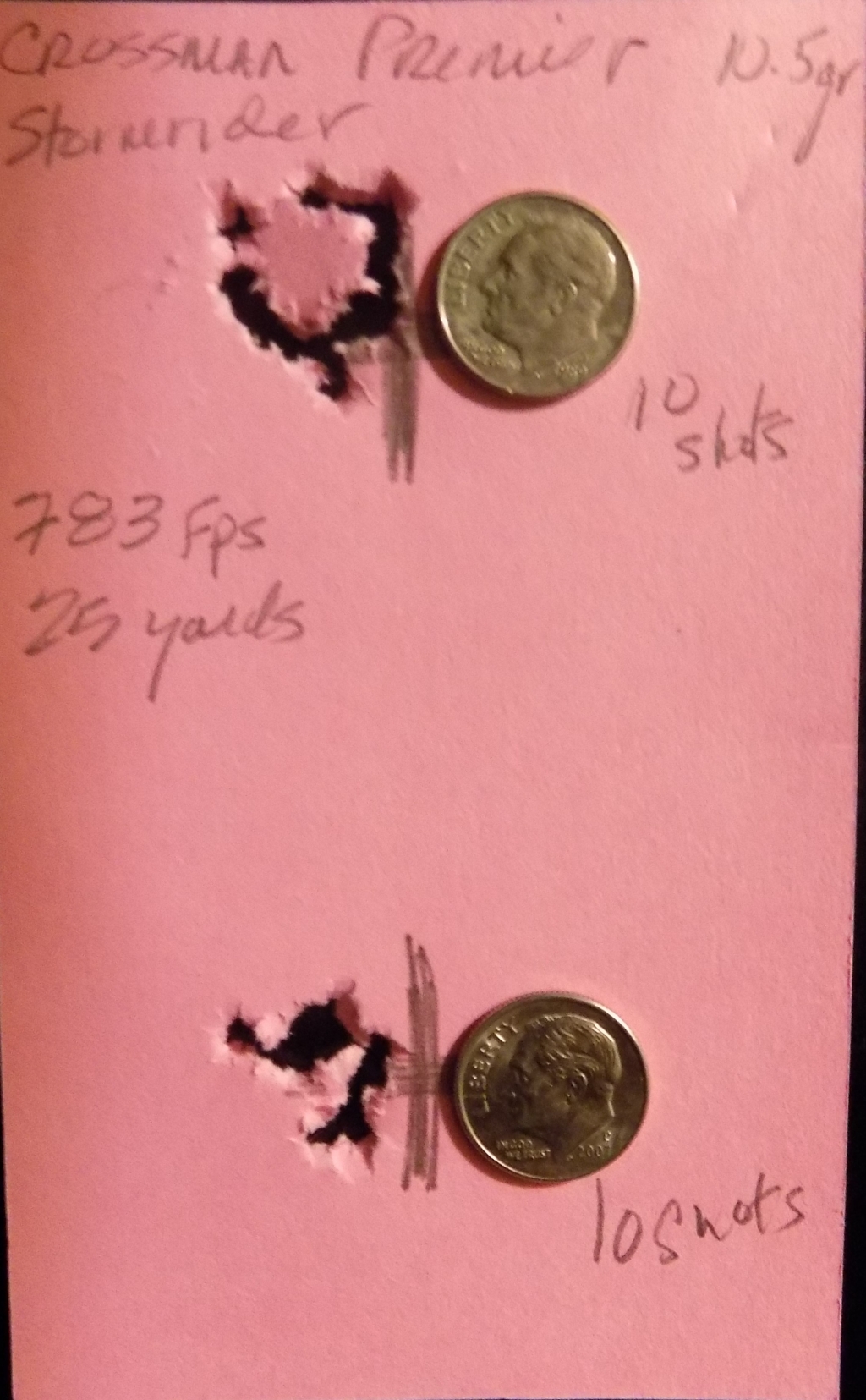

Now we have the Crossman Premiers in at 10.5 grains. Same setting on the regulator and again we see this power plant likes heavy .177s.
Again the first 20 shots are the best and we get these stats:
We picked up 2 FPE and still got our 20 shots with an SD below 1%. Not bad.

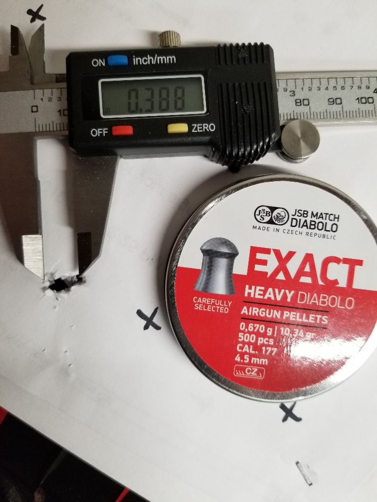

Today I shot the rifle for groups. I was not very happy to find that the H&N FTTs at 930 fps were shooting only 7 out of 10 shots into an inch at 38 yards. The Crossman Premiers were shooting about the same. So I got out the Rabbit Magnums and they were shooting groups about the size of a saucer at that range.
Backtrack a little here. I added the second barrel band last night. Then this morning I put the rifle on the bench shooting Iron Sights. At 25 yards the first shots were within a couple of inches of zero. Tweaked the rear sight down about 3 inches (1/4 turn, and there are no click stops). That put the ten shot group centered on the bull and the group I shot was about the size of a golf ball. I thought it was me but not so sure at this point. I tried the H&Ns and the Crossman Premiers, neither shot exceptionally well. It would do fine for pesting rats out to 25 yards but I want more.
After that session I took the rifle in and mounted the Leapers UTG 3x12x32 Bug Buster. The scope mounts on the rifle without removing the rear sight IF you don't use the sun shield that comes with it. I wasn't happy with that and so pulled the rear sight and put it in the parts box. Mounting the scope was trivially easy and I would recommend that particular model if someone were looking for something small, light and not too expensive with a mildot reticle. It is a true mil/mil scope even though the turrets are marked in MOA. One click is 1/3 inch at 100 yards. The math will show you that is one CM at 100 meters and that is 1/10 of a mil. So counting clicks still works.
I ran the numbers in Chairgun and got a 1st zero of 15 yards. I went out to the bench and zeroed the rifle at 15 yards. Chairgun said the second zero would be at 38 yards for the H&N FTT. The first shot at 38 yards was dead on for elevation and about one click left for windage then the group fell apart. I put seven shots under a quarter but the last three shots opened the group to the size of a golf ball. I saw the same thing with all the pellets I shot today.
So I pulled the barrel and cleaned it, then lapped it with a few strokes of 800 grit followed by 1500 grit and finally 3000 grit diamond paste. I stoned the mouth of the chamber very lightly to knock off any burrs and taper it a tiny bit. I cleaned it really well again, lubed it and put it to bed for the night.

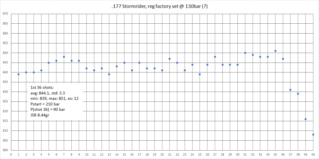

Hey, I had the same issue of the red part of the reg being 180 degrees off! Took me quite a few shot strings to figure it out as well. Funny thing is I bought two regs, one in 22 and one in 177, and the 177 reg was off but the 22 was fine. Here is the 177 shot string now , which I am happy with. Haven't adjusted the 22 yet, just got the reg installed. Based on the starting (non-reg) bell curve, I'd say you are right about them having optimized 22 and just retooled for 177. The 22 bell curve peaks right around 27- 28 fpe shooting 15.89 jsb. Seems like a pretty capable platform. Somewhere I read about someone grinding the end of the reg install rod to be a screwdriver - I did the same and it's a neat trick to avoid having to pull the reg everytime for adjusting it.
Very nice. I just got mine shooting "sort of" ok. Keeps throwing a flier every five or six shots. No idea why.

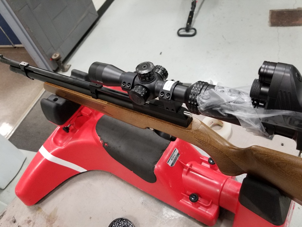

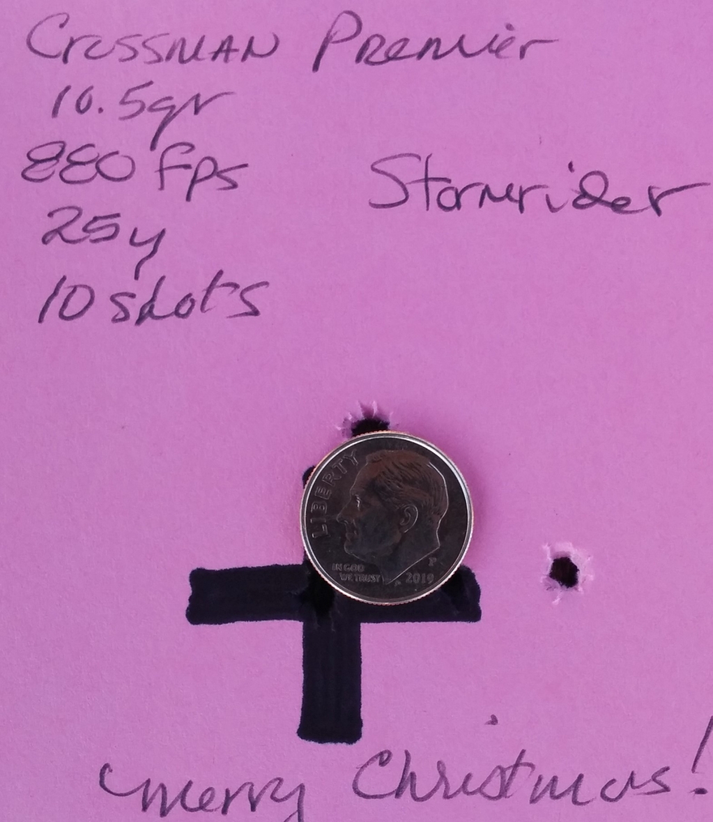

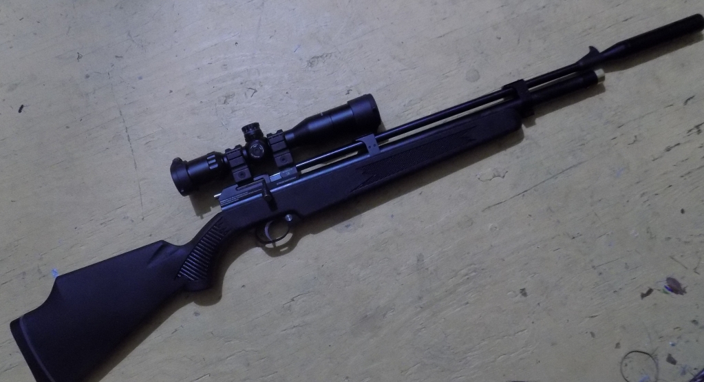

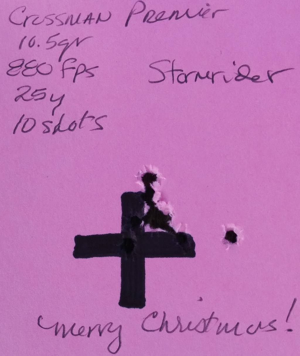

I may need to do something with the crown on this one. I did not look at it very carefully when I had the moderator apart. Here is another pair of groups shot today. I have again fiddled with the setting on the regulator and managed to get just 30 shots at 16.5 FPE. Given that 9 shot mag that is going to work out nicely. Later in the spring I will order a couple spare mags. Three magazines @9 shots each and back to the pump...

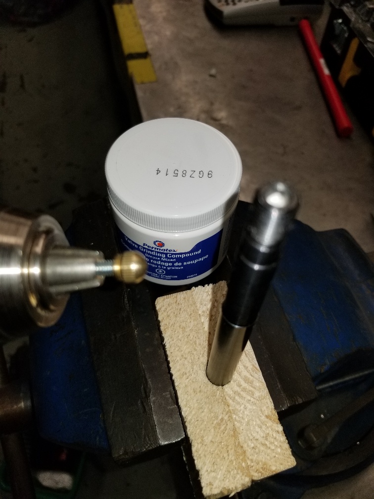

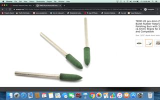

I used valve grinding compound and a brass light light switch knob to polish the crown.

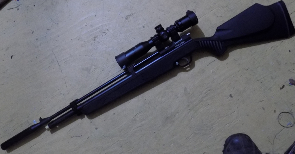

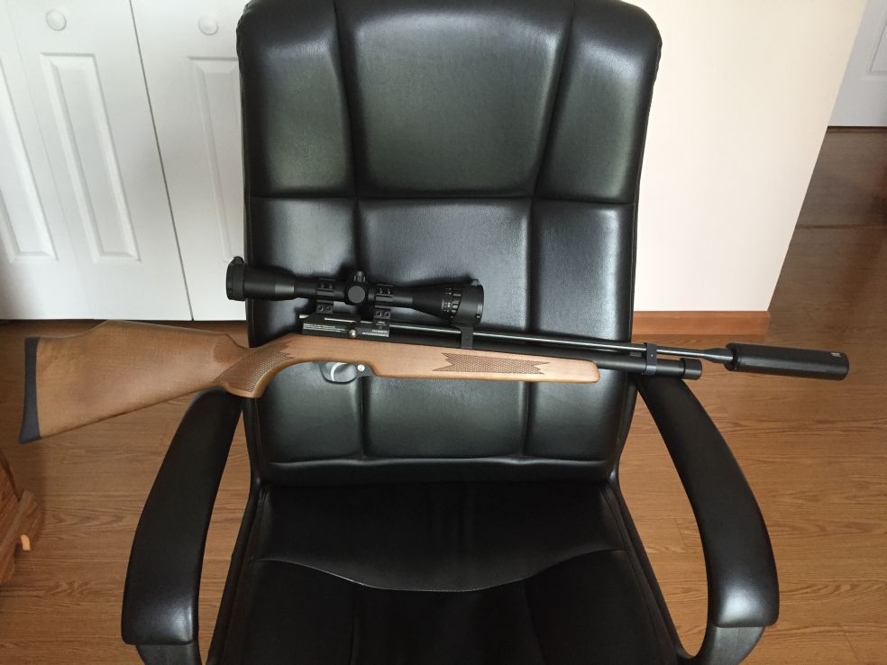

Machined up an adapter and added a DonnyFL Sumo. Very quiet now. Also made an extra barrel support and cover cap for the charging port. Here is a photo of my airgun.
Oldspook, Man you have done an impressive job on documenting your progress with the StormRider! Will keep following your post to improve what I have. I got a can of abrasive paste to work on my crown and loading breech this weekend.

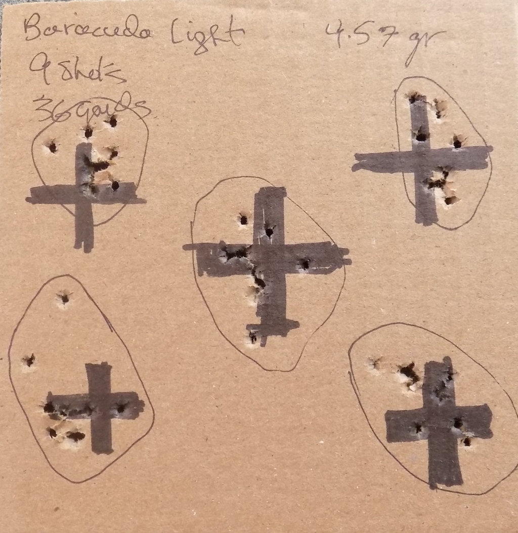

So today I got in an order of a few different kinds of pellets after shooting a few groups with each one the rifle showed that it liked the H&N Barracuda Light at 9.57 grains. So of the pellets it has been shooting it prefers them in this order: H&N Barracuda Light 9.57gr, H&N FTTs 8.64gr, Crossman Premier Heavy 10.5gr, H&N Barracuda 10.64gr and JSB Exact Heavy 10.34gr. The only ones which are "acceptable" as far as I am concerned are the first three and the only one I shot today worthy to talk about were the Barracuda Lights.
I shot five nine shot groups at 36 yards. The average group size for the five groups was 1.16 inches. That's not terrible but still far from what I am after. Using a quarter I could cover 40 of the 45 shots shown on the target. So eight out of nine shots went into quarter at 36 yards. For perspective the top left group just fits under a quarter. Here is a pic of that target:
It looks like more dremel work is in my future.

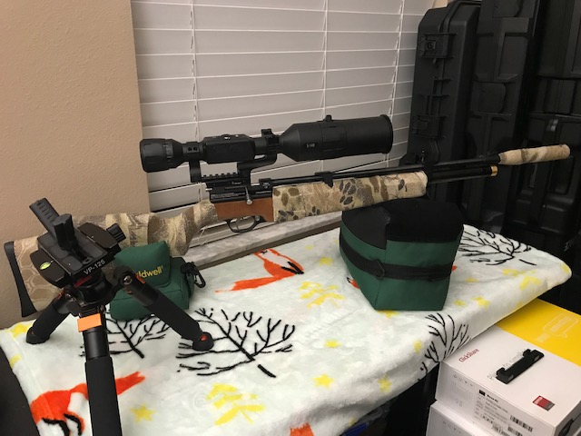

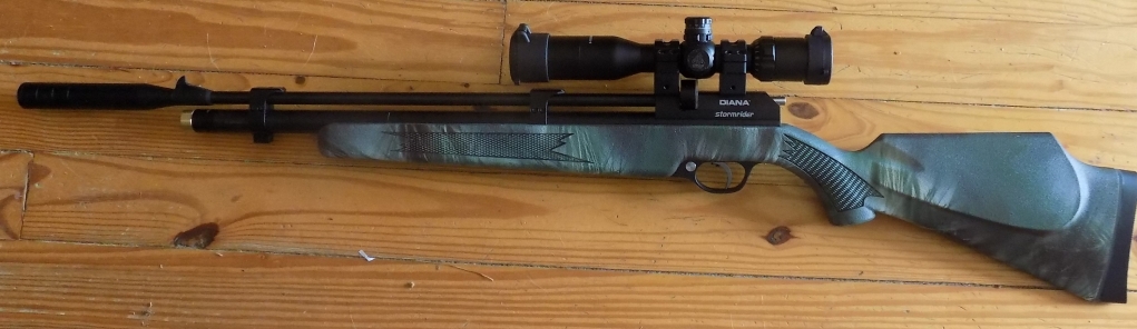

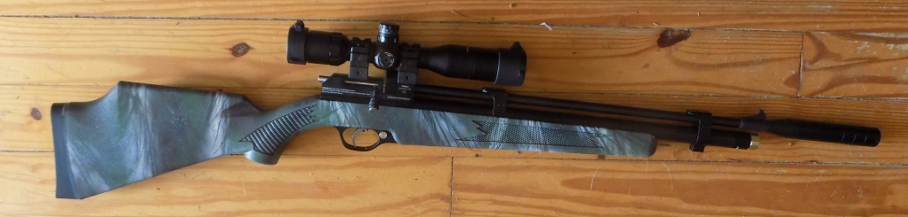

I also went ahead with the camo, even though I could not find all the colors I wanted. The end result kind of grows on me so I guess I'll keep this way till a better idea comes along:
As it is, this is a 40 yard squirrel rifle. It holds 30 shots of air at a very consistent 965 fps for Barracuda Lights. That works out to three magazines at 16 fpe into a group that will stay on a squirrels head at 40 yards. Like I said I had hoped for more but, really that is a lot of bang for $425 when you include the regulator, extra barrel band, and 3x12x32 UTG.
